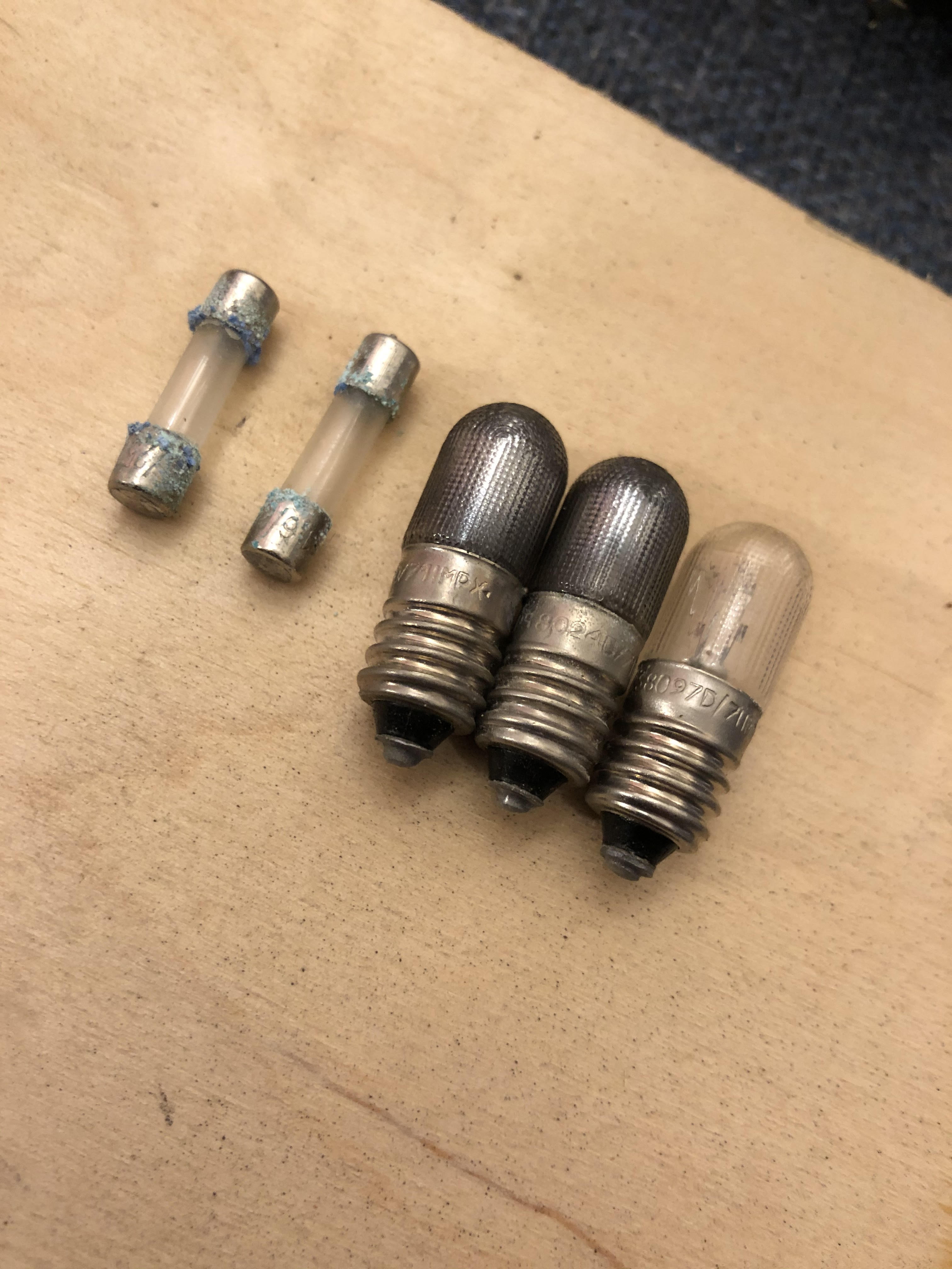

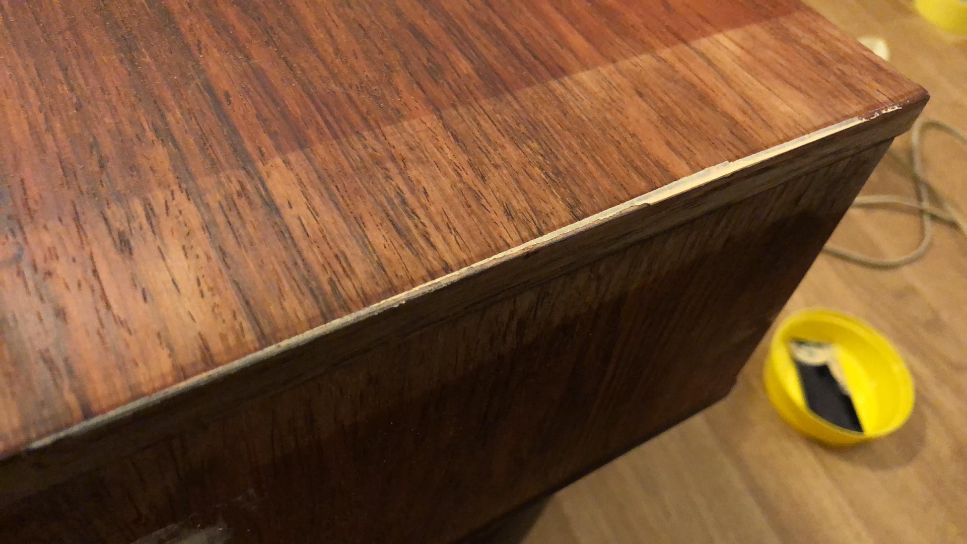

I've started doing some work on the 900K. The bulbs are all out and the level of oxidation on the fuses is quite substantial. I've cleaned everything and ordered new bulbs. I'll also stop by the store tomorrow tomorrow to buy some plastic wood (quickwood) to try and fix the veneer. I've sanded the cabinet using 80, 100, 120, 180 and 500 grit, and then oiled it using teak oil, and I'm quite happy with the result. Tomorrow I'l also remove the front plastic cover and polish it.

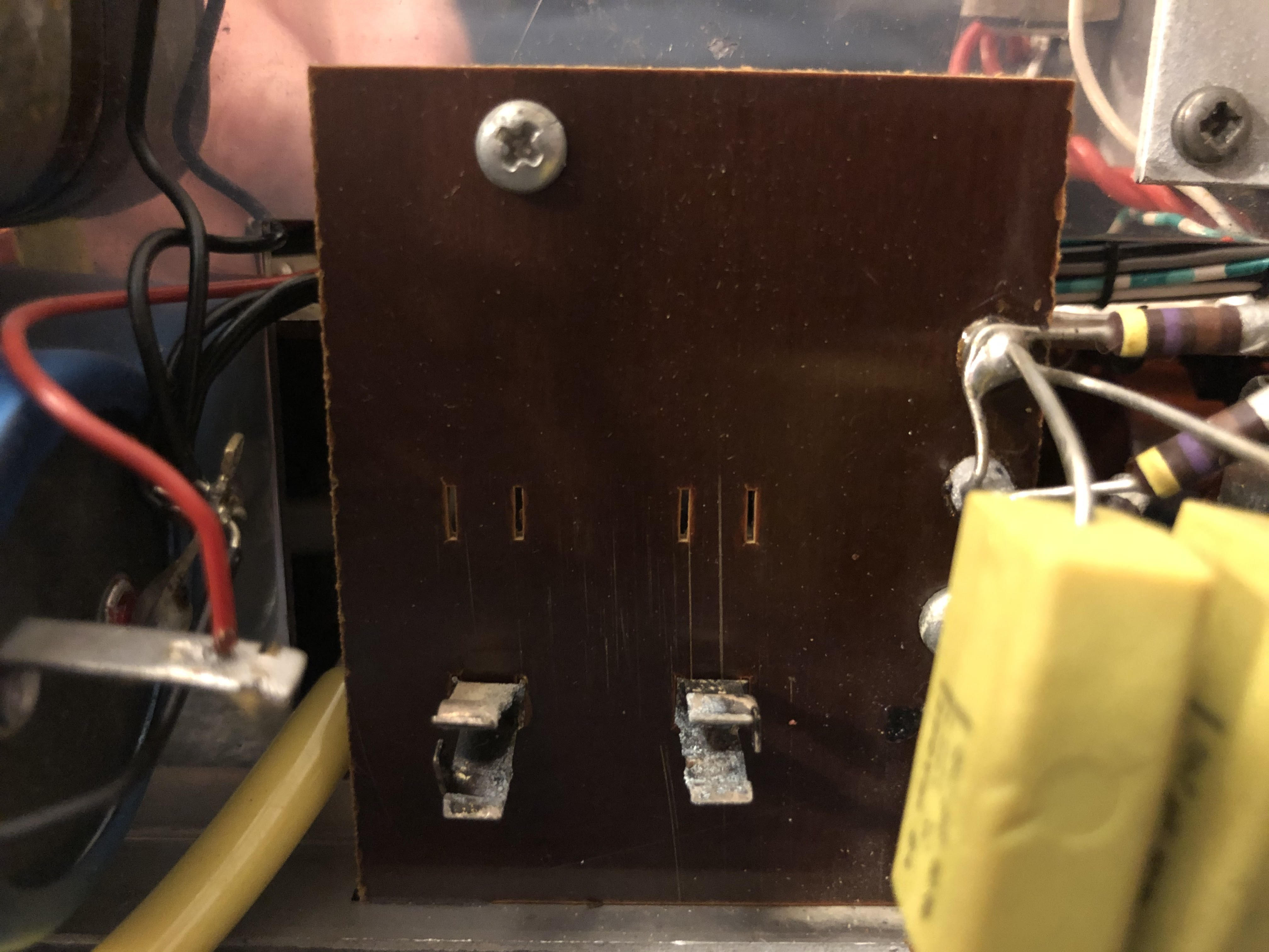

All bulbs are out and quite a lot of oxidation on the fuses
Fuse socket. Interestingly only one, while Martin mentions two in an earlier post. What could be the reason for the missing fuse socket?

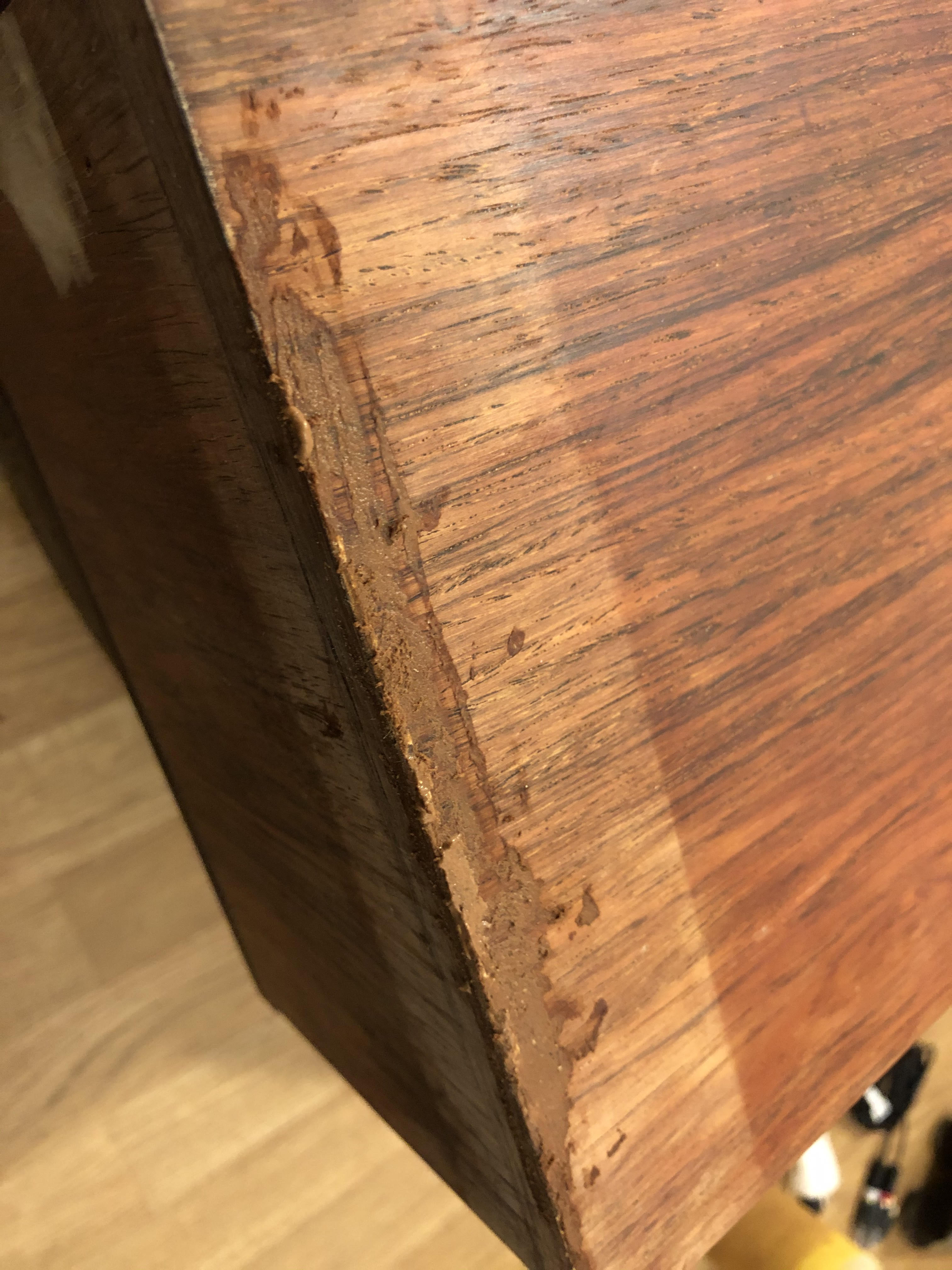

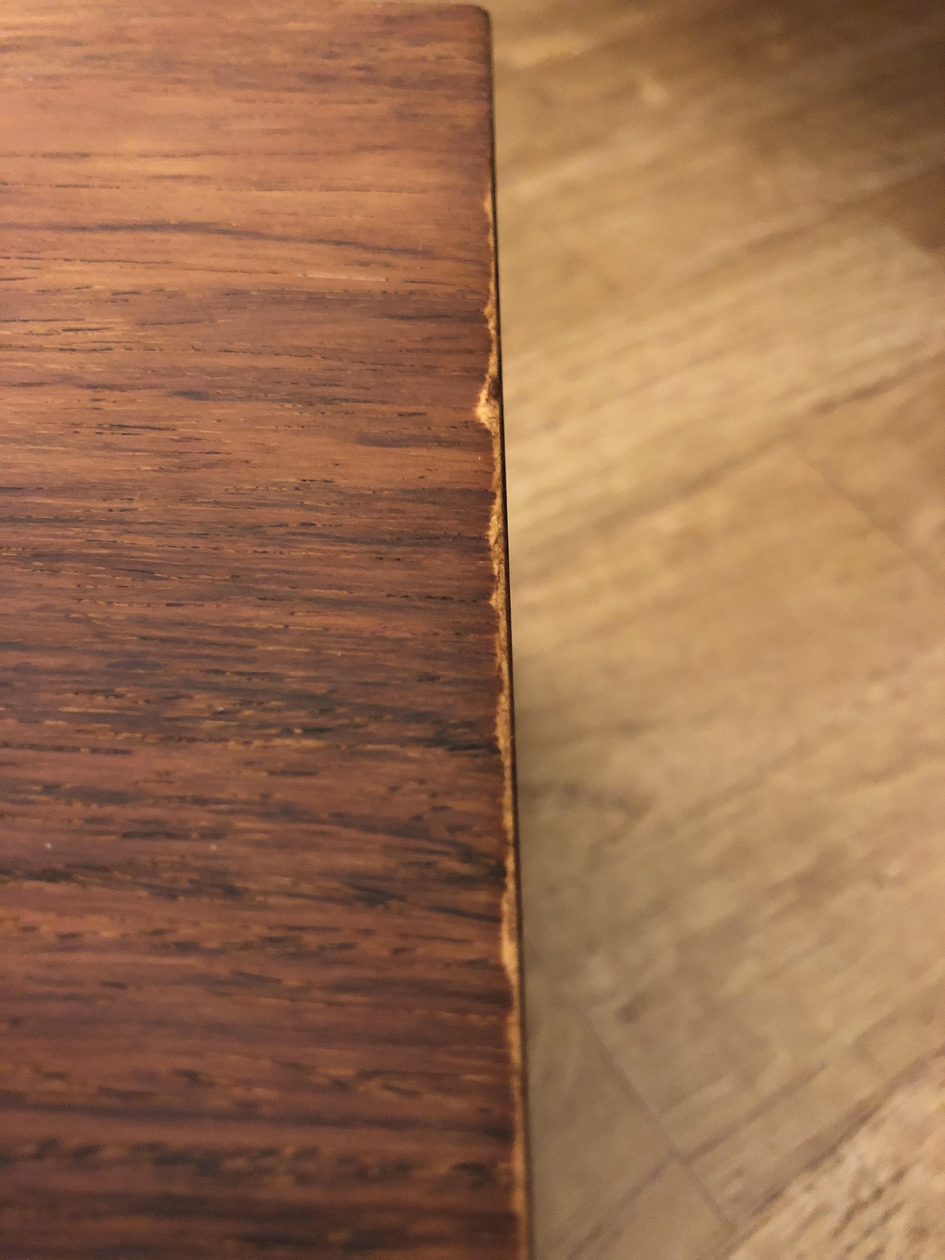

The area that I'll try to fix using some quickwood, sand paper and paint.
Nice projects!Beomaster 900K was produced in a number of different versions.Some have one fuse at the side board, others two.There's also the fuse for the dial lamps - it sits in the corner of the large tuner circuitboard. It's not uncommon to find thefuse holder here completely green with oxidation, eaten away to the point of falling apart when touched.Needless to say, fuse holders like that - and ones looking like the one in the above photo, must be replaced. And in most casesthe fuses themselves must be replaced too.
Martin
Thanks Dillen :) Yeah, all fuse holder probably need replacements. I have lamps, fuses and holders in shipment, so I'm patiently awaiting their arrival. In the meantime I've started doing some cosmetic work.

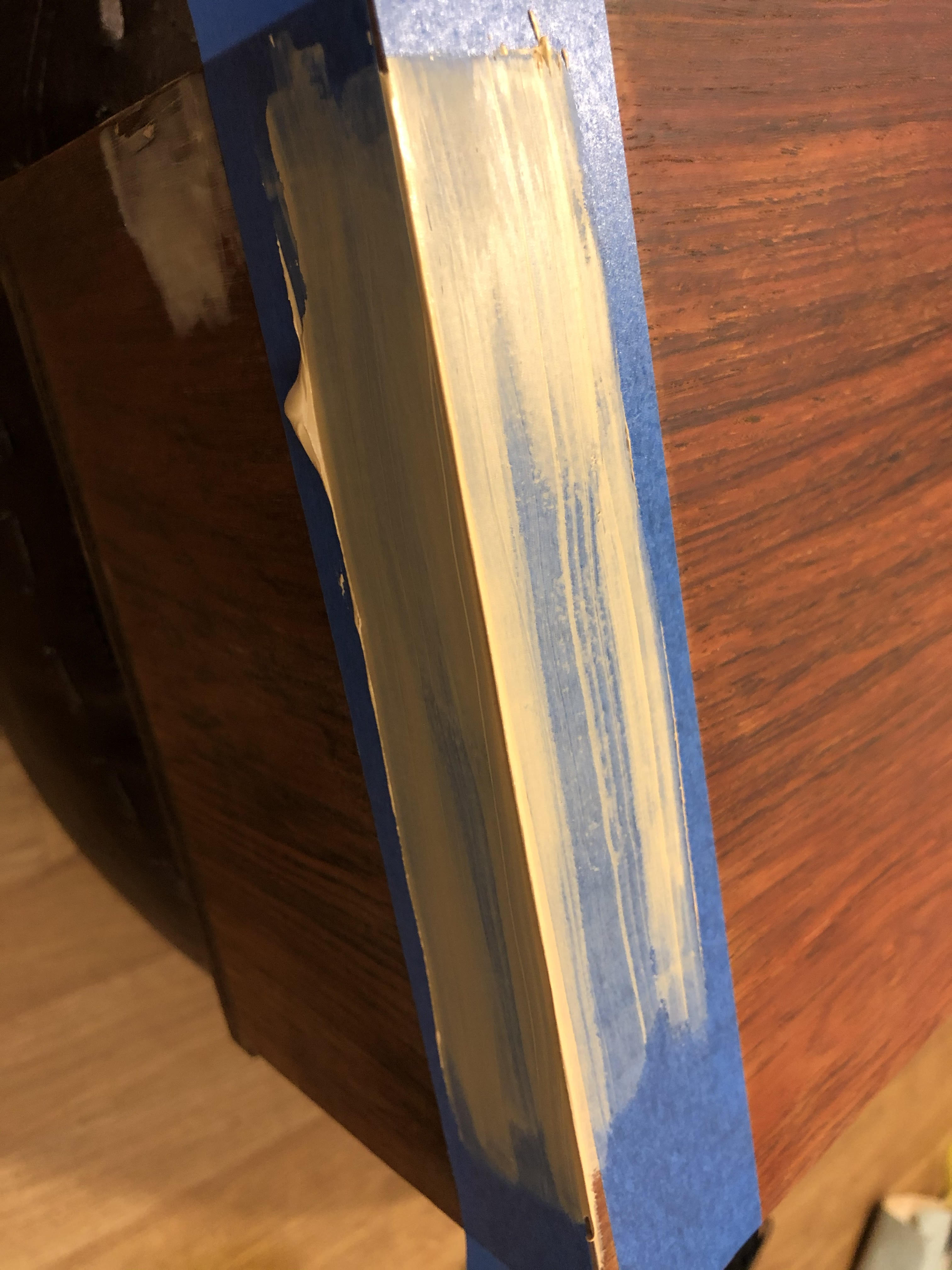

I started applying quickwood to to try to fix the veneer issue, but I quickly realised it wasn't as good as I hoped for.
I mean, it was quite even and everything, but it didn't help much when it fell off while I sanded it...
So I decided to make a cocktail of sanding dust and wood glue and it already looks way better, even before sanding. We'll see how it turns out.

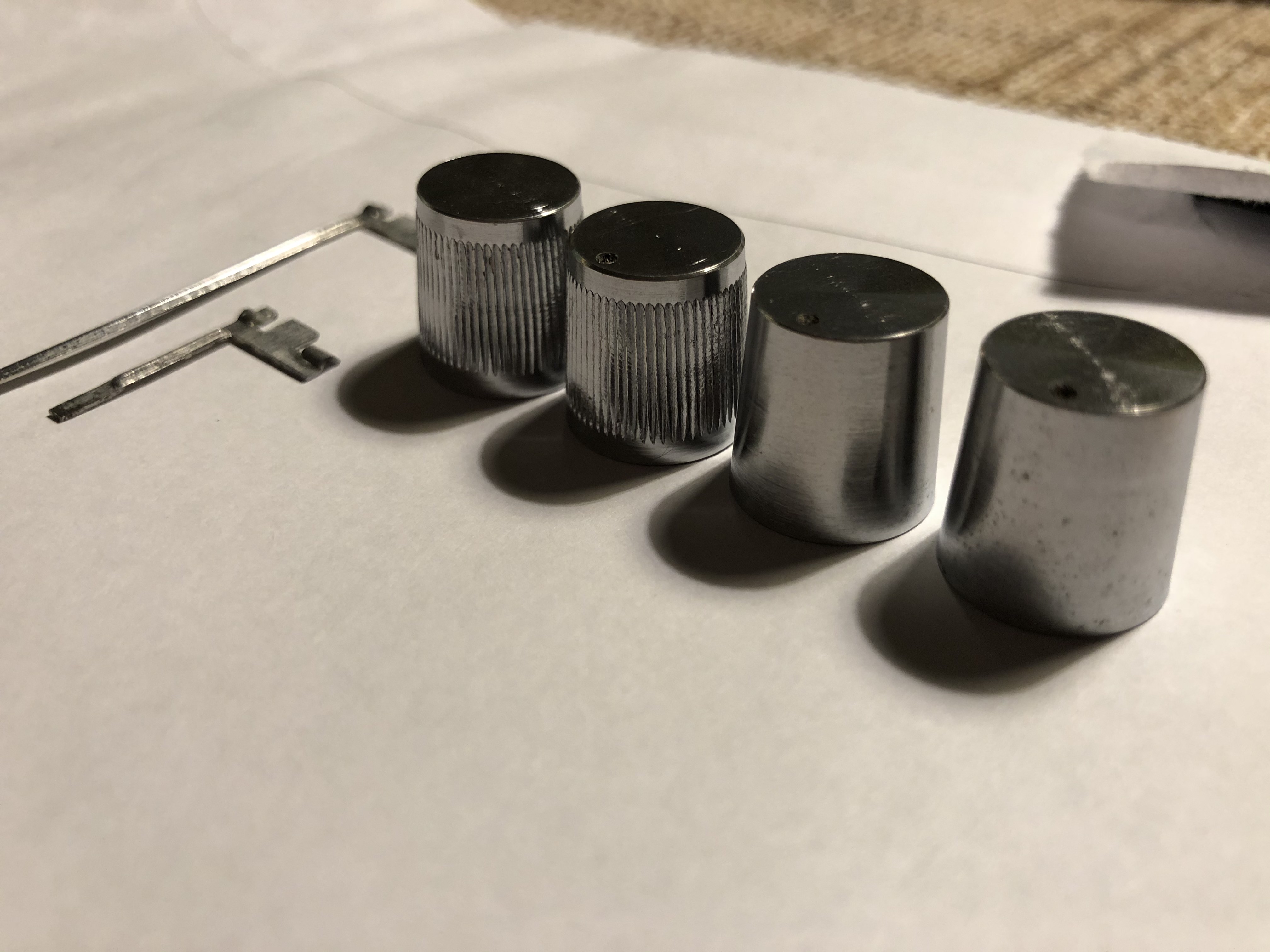

I've also polished the knobs and removed the white paint from the meters/indicators. Right now I'm considering whether or not to paint the indicators in a silver paint and do the panel black, as well a the speaker grills to make it look like the black/rosewood edition. On a scale from 1 to blasphemy, what do you think about that?
Trying to make an old radio look newer? A matter of taste I suppose, - and it's your radio, - but It would look wrong in my opinion.Homepainted plastic rarely look good.
Reminds me of this guy who took all innards out and replaced it with modern stuff.Value now less than zero. I would rather buy the shown left over "scrap heap" than the "once a radio"-thing.Others will disagre, I'm sure, but having been a collector through decades, it's not really my thing.https://www.instructables.com/id/Bang-%2526-Olufsen-900k-Boombox/
Agree with Martin on this, I go a long way to keep my B&Os as near to original (in and outside) as possible, bear in mind that a lot of B&O models have won design prices and are exhibited on museums of modern art. And as Martin says, when changing the design or innards away from originals your value will be "0"
