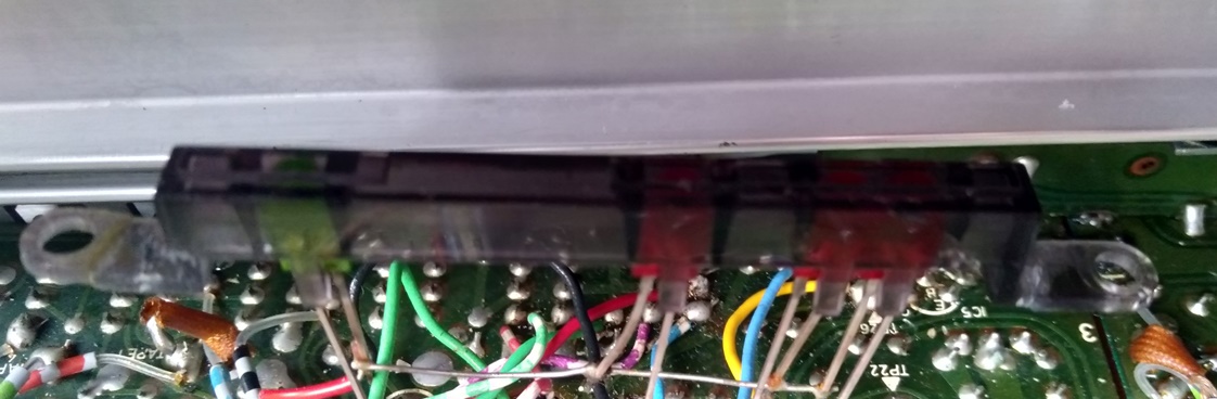

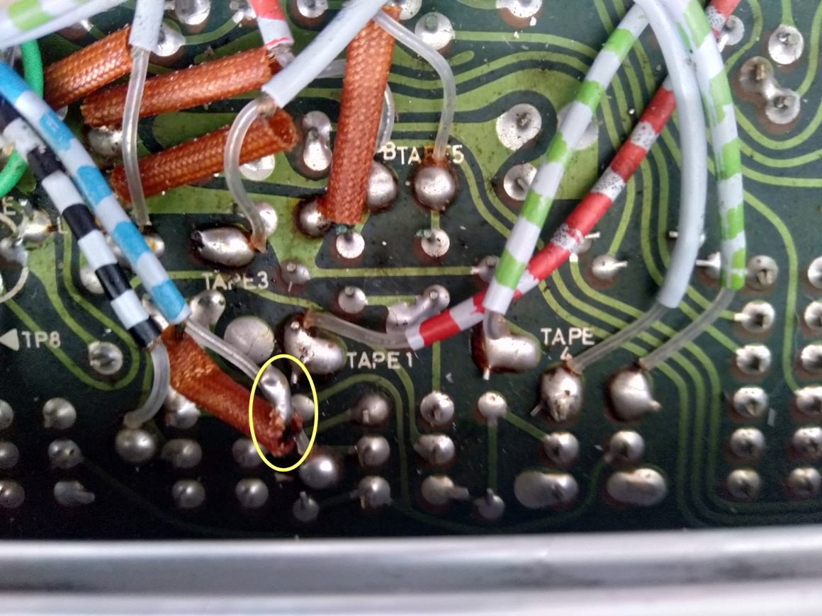

Problem 2.
All the level LED's are permanently on. I have adjusted the slider and even removed the top transport board with no difference. I have noticed on the Radio board, a wire which seems to be off. looks like it should be grounded somewhere in this area marked Tape. see picture.
Thank you

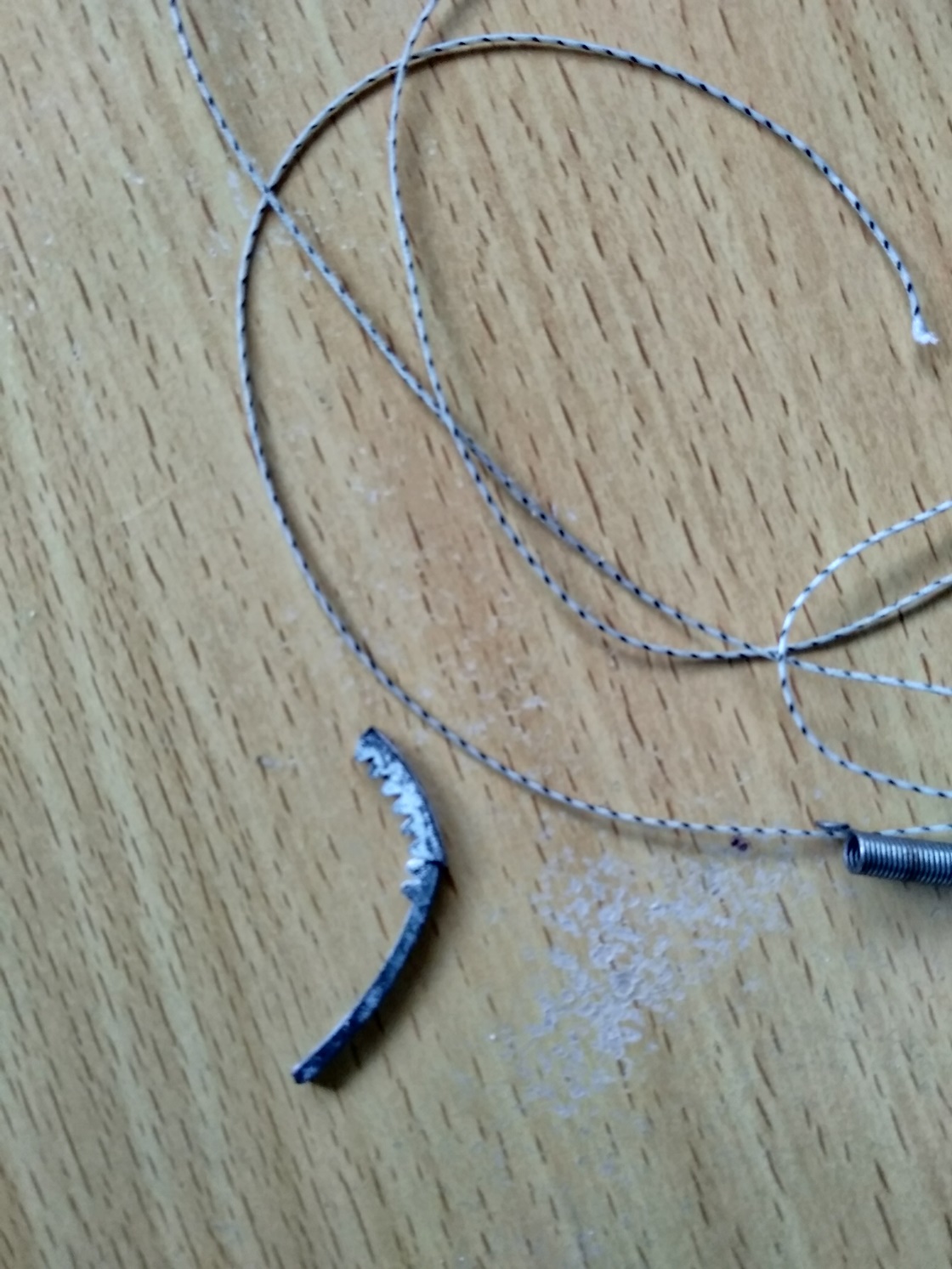

I also need some parts to finish this one off.

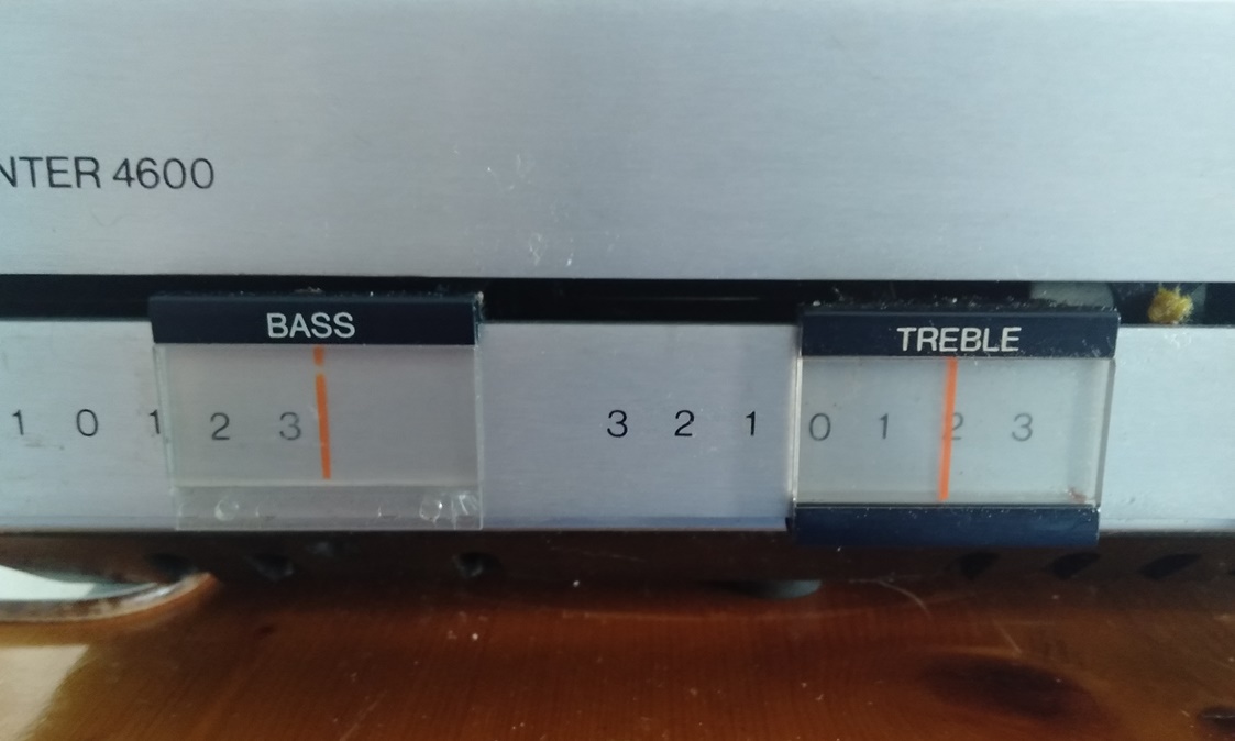

1. Bass slider or the bottom part if someone has a scrap one.
2. 'Beostring' to restring the tuner
3. shroud for the FM/AM/Stereo LED's
4. serrated part from the speed adjustment. It just crumbled when I touched it!
Is the speed selector meant to light up?
Pictures attached thank you.
