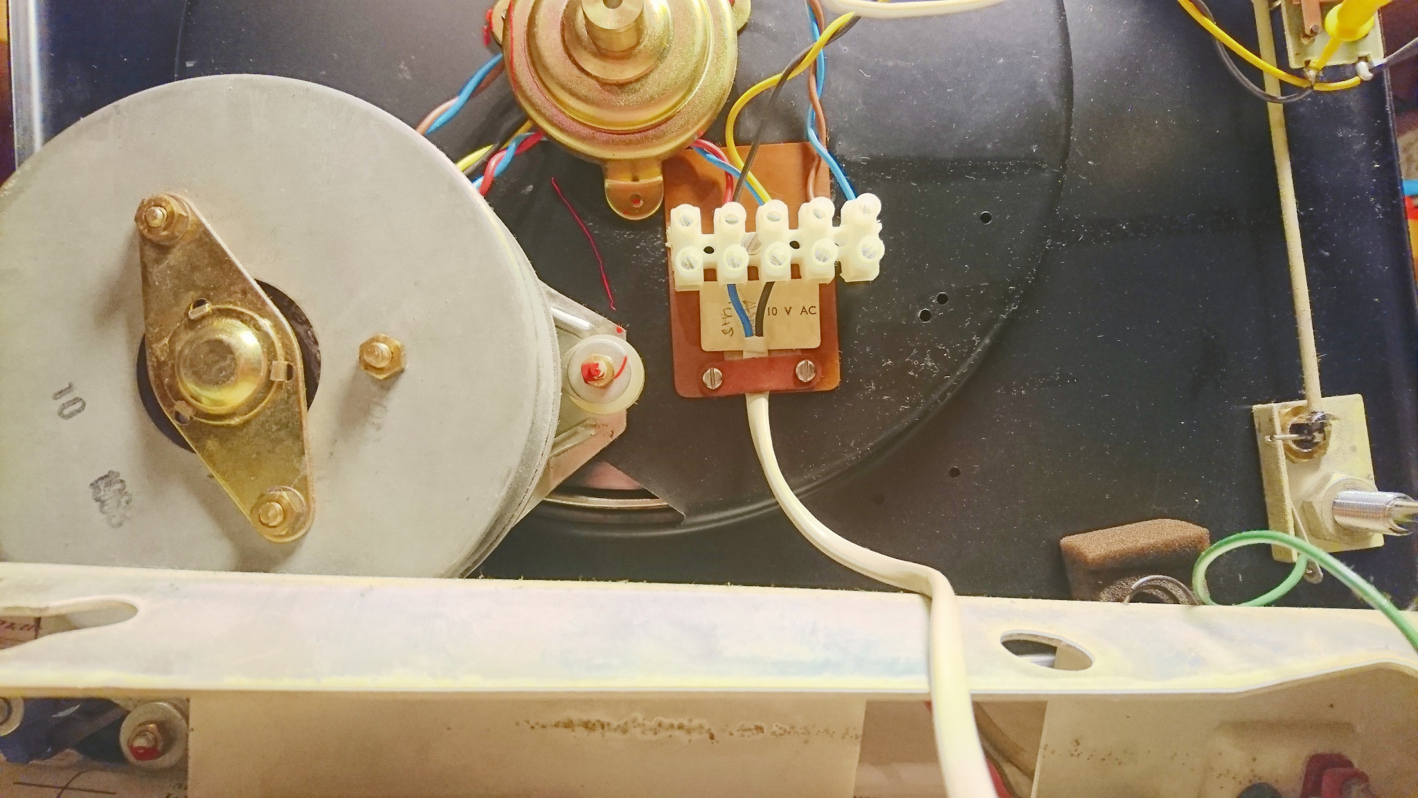

Can anybody tell what are brow and light blue wires? Connected only to motor. Is this wiring right?
My manual shows different kind of motor.

They will deliver AC power to the optional RIAA module (Beogram 1000).
The motor doubles as a transformer.
Beogram 1500 was produced with different motors.

Ok, thank you. This motor might be dead then.

That's very rare.
Will it rotate by hand?

Yes it rotates. Have not make any investigatios on it yet.
