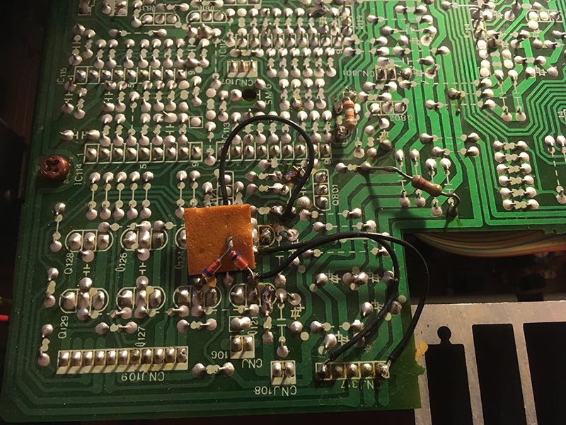

Main fuse has blown;
I am curios to know if this is a standard update of the main print..
hugosnel
Posts 16
hugosnel replied on Sun, Jan 12 2020 3:01 PM
