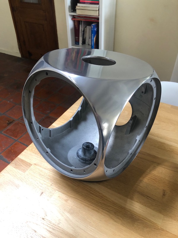

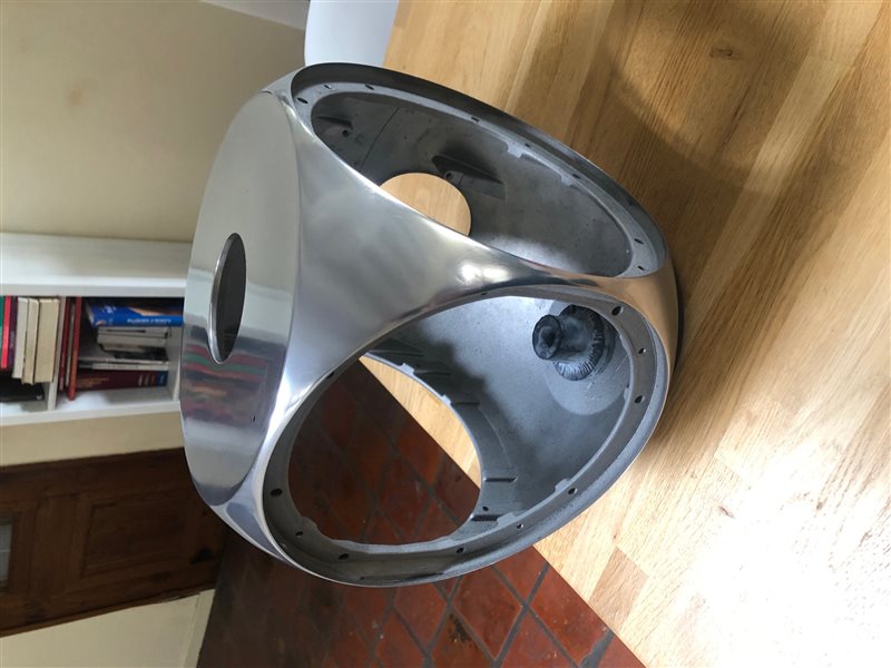

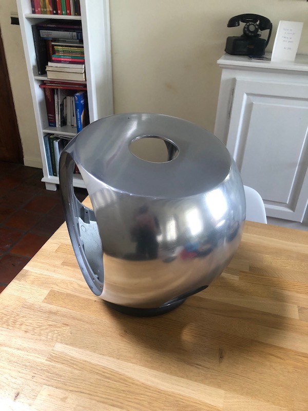

I changed the topic title, since I decided to refurbish the beaten up Beolab 2 that I recently picked up.
I hesitated between painitng (spray paint) or sand it down and see what it gives, so I started sanding : 80 grit, 120, 240, 400, 500, 600, 800, 1200, 1500, 2000. As from 500 grit I wet sanded.
After 2000 grit I used metal polishing cream, then 2 stages of Monello compound (car polish) with different pads.
You can still see some "battle scars" from its past, but I think it will look nice next to my Beolab 8000's (they need new covers, soon ... )
Thank you :)
It took me a good 20 hours of sanding, by hand. The hardest part is the 80 grit, the finer the grit, the easier it goes, and wet sanding is pretty satisfying, as you can see some shine coming through.
For the last steps (polishing compounds) I used a polishing machine and different pads (hard/soft)
Beautiful.
Did you manage to keep the Band Olufsen marking on the top or did it disappear with the sanding?
Thank you
I tried to keep them, but it was too difficult, so they went away. The idea is to put small printed "Bang & Olufsen" letters on it, I need to look where I can find someone who can.
What about oxidisation? I thought non-anodized aluminium was highly prone to oxidisation?
