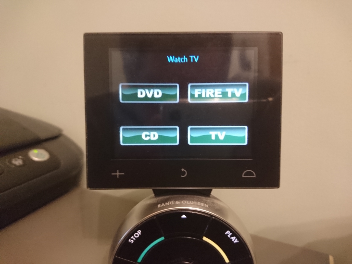

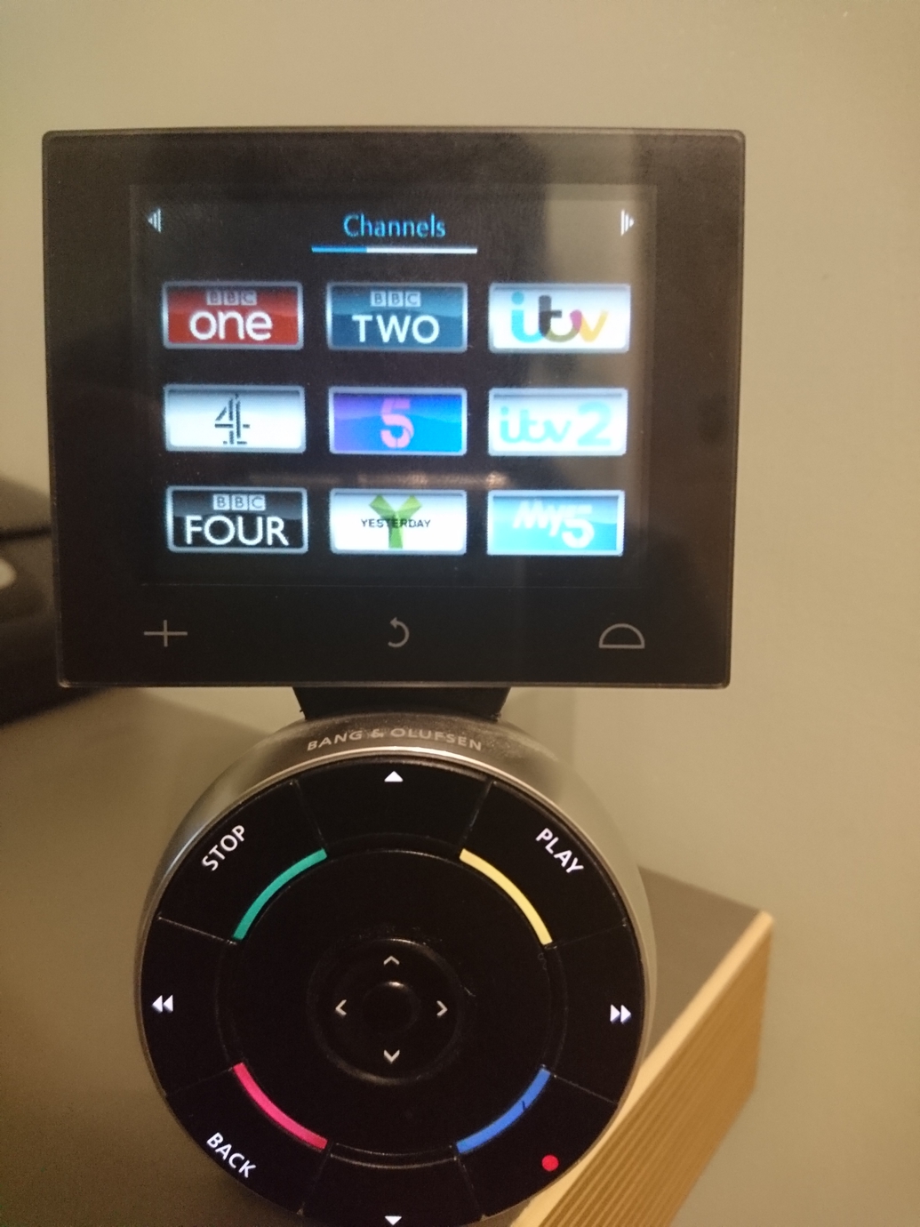

I am really enjoying mine. I have 2 Beo6 and one Beo5. I struggled to get the Beo5 working with Windows10 64bit so ended up downloading VMWare and installing XP SP3 in a virtual machne. Concentratin on the beo5 at the moment. trying to do macros but the configurator seems to corrupt the file sometimes.
Here are a cople of pics of the buttons and logos I'm workng on. I have added a zip file above with all my buttons so  far. Just unzip it to the images-logos-custom folder in the confugurator and you can go in and replace any buttons by going to properties>browse (to the custom folder) choose image>add image. I have only done the UK Freeview/HD logos (updated in January with latest logos) and some general buttons.
