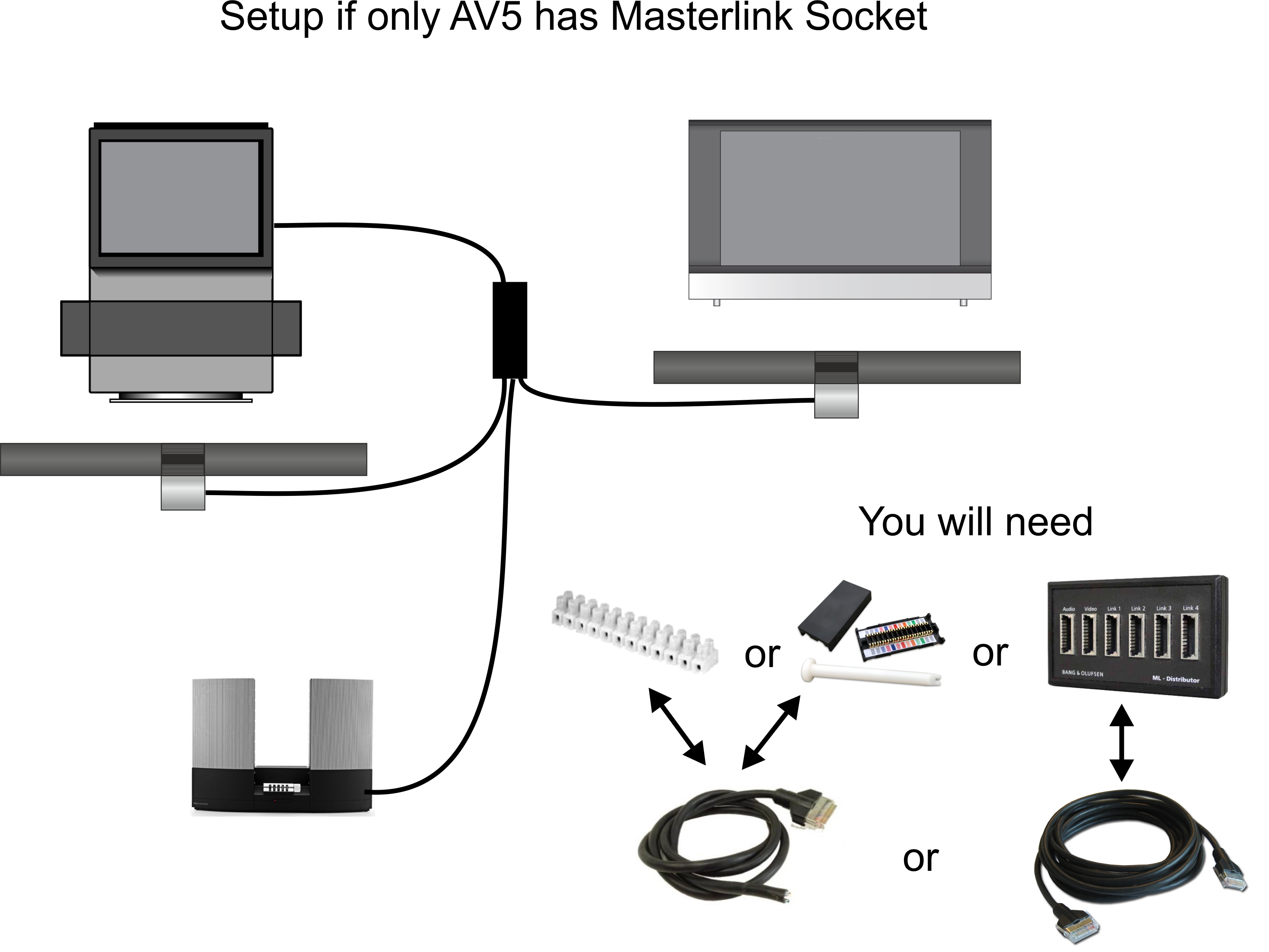

If both the AV5 and BV8 have Masterlink what you want is very easy and simple to do. You can have a Beolab 3500 in your living room and one in your bedroom, plus you can have a Beolab 2000 in your kitchen. Each Masterlink component will need to be programmed for the correct option (this can be trial and error especially with the BL3500 in the same room as the TV). Because you will have two TVs connected, one is the Master and one is the Link Slave. This will programming will be done easily using your BEO4. You will need 5 Masterlink cables of the length you want and a Masterlink Junction Box. Depending on the junction box you use, you will need the Masterlink cables to have a plug at just one end, or both ends. (my attached diagram shows why). This setup will only distribute sound. There is a way to distribute video but I don’t know what you need.

If just the AV5 has Masterlink then you can still have two BL3500 and one BL2000. You can have up to 15 Masterlink products connected to your AV5. Your BV8 will remain stand alone. This is probably a much easier setup as the option programming will be easier. This would probably be the easiest to setup.
