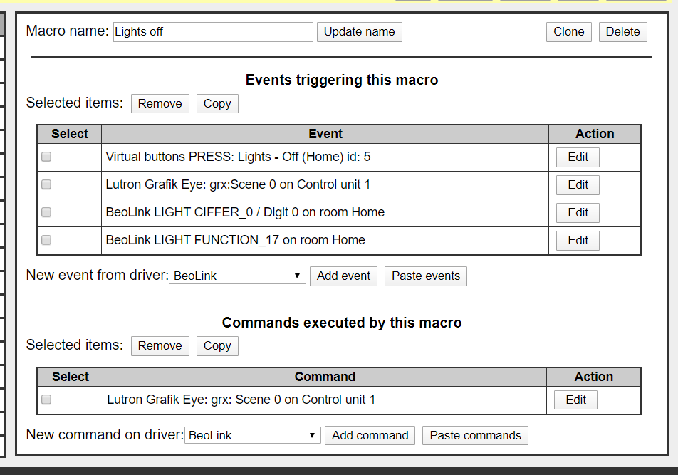

In my bedroom, I have a Lutron GFX lighting management system connected to a MLGW. That allows me to control the lighting of the room using my BeoRemote One (IR)  on my BV7(40 and it works very well. For example, I press LIGHT and 0 and the lights are switched off.
I use the MLGW for other features such as operating the blinds etc.

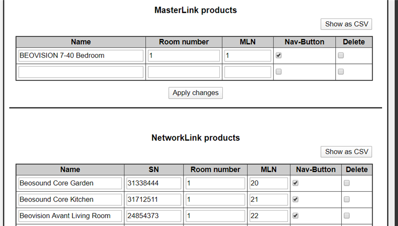

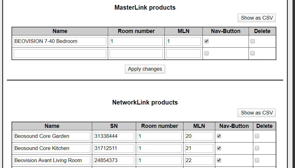

I have noticed that the MLGW can also detect the NL products (see screenshot below)
For testing, I have put all the ML and NL devices in the same room (1).
What I would like to do for a start is to operate the same macros from the Beovision Avant in the Living Room.
When I press LIGHT + 0 in the living room on my BV Avant 55, nothing happens. I understand it should do exactly the same as pressing LIGHT + 0 in the bedroom on the BV7-40, as both devices are declared in the same room. Is there anything to configure on the Avant to pass over the LIGHT commands on the network link? Or is the problem coming from elsewhere?

Just found the solution in case someone is interested. The step I was missing was to go to the service menu of the Avant to reroute light commands to the mlgw. It is working now
