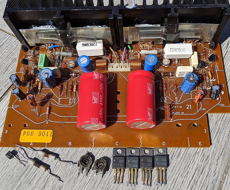

Our Beomaster 1700 (type 1701) has been in various lofts for 20years. Spurned on by the CV19 lockdown here in the UK I’ve been trying to repair the amplifier board. The loudspeaker cable on the left channel was shorted and fried a few components.
I’ve read as much as I can find on the web (manuals etc) yet found your forum the best place going forward. There are a few issues that I hope members can help me with:

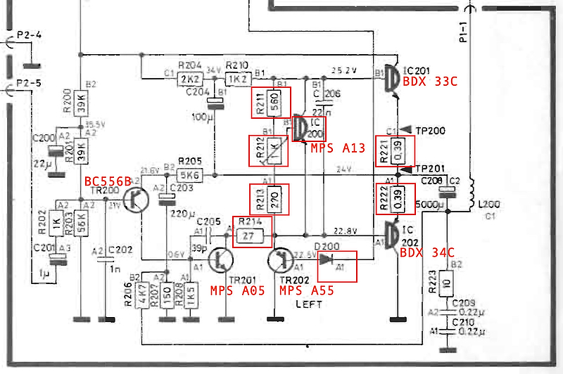

As suggested in previous posts i replaced all burnt-out parts (resistors, a variable resistor, a diode and all transistors) and electrolytic capacitors all with original tolerances. nb, the 0.39ohm 1W wire-wound resistors were only available as ceramic 5W at the time.
The Heat-Sinked TE 1088 and TE 1089 are now obsolete (only available as ‘used’ on ebay) so I looked up BDX33a/34a as replacements only to find that they have been replaced by BDX33c/34c which seem to have slightly different electrical characteristics  but purchased them anyway as there seemed no other option.
In the manual, the VR1k resistor sets the 'no load' current. I set this resistors' trim as close to the original one that i took off the board. Disconnected Speakers and input connector from pre-amp stage and turned the mains supply on….
Within two seconds the replacement 0.39 Ohm 5W ceramic wire-wound resistors glowed (located between the emitters on BDX 33c/34c.  There was a burning smell from those and the 27 Ohm 1/8W resistor connected to MPS A05 and MPS A55.
Maybe a few things caused this
1. The variable resistor 1K value needs to be changed
2. The Ceramic 0.39 ohm 5w resistors were the wrong type.
3. The replacement BDX33c/34c are so different that a few other resistors values need to be changed.
4. Having no audio signal load to the board may have also caused the ‘thermal run-away’
I have now ordered lots of 0.39 ohm 2w wire-wound resistors (original spec), a supply of various fixed resistors and variable resistors - further £20 spent (-:
Q; How can I check the 12mV (maybe it’s different now?) across one of the 0.39 Ohm resistors without blowing everything again?
Q; Is there a formula to work out alternative values of resistors and mV value in this amplifier stage - due to change in output transistors?
Q; How can i test transistors without an oscilloscope or wave generator, i only have a multimeter with hFE pnp/npn holes?
Q: Is there anything above that I’ve overlooked?

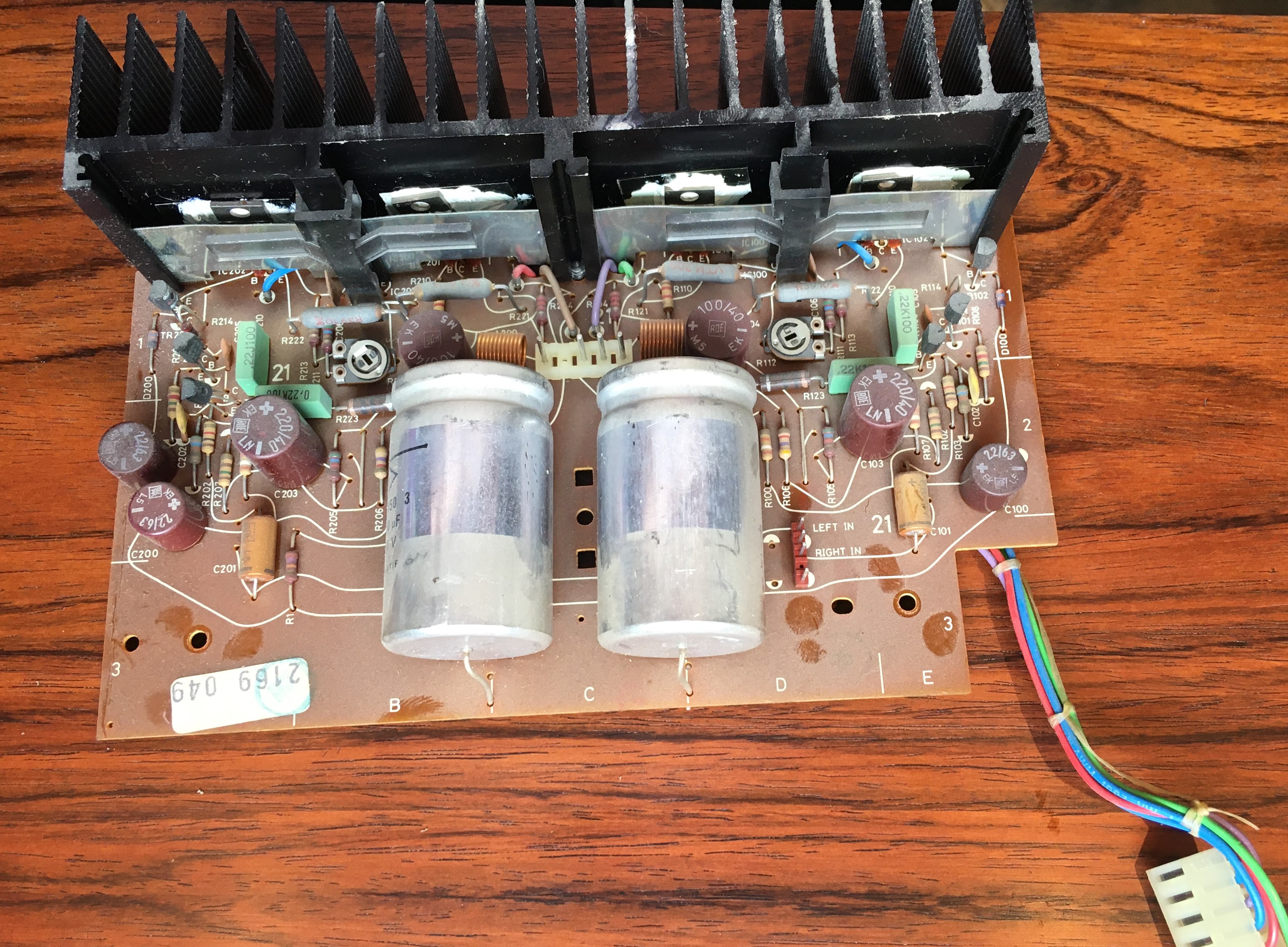

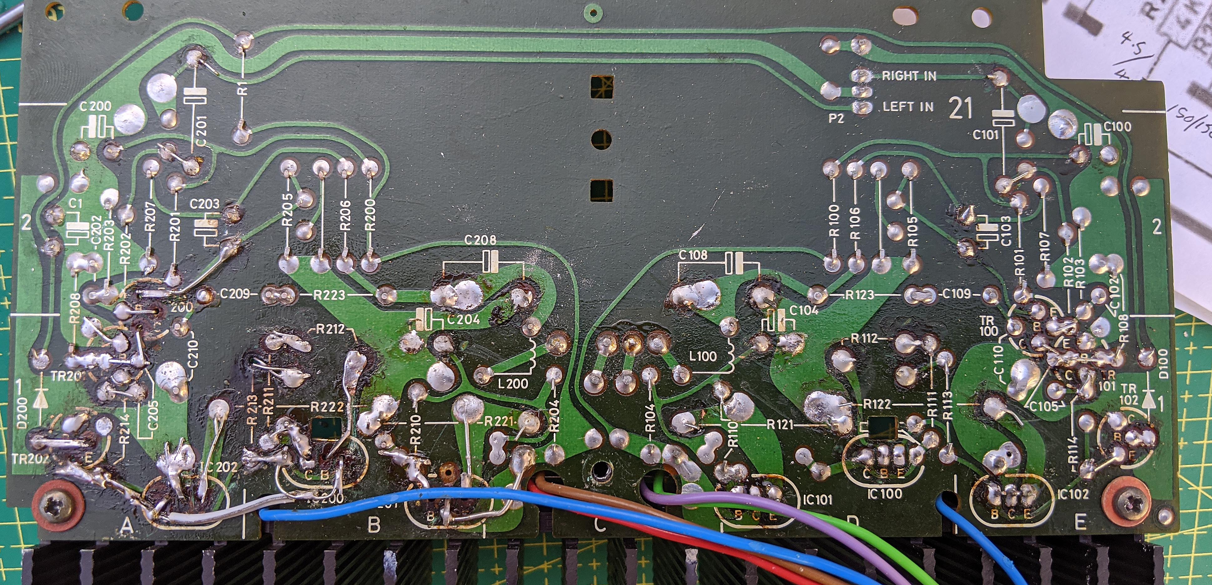

I hope to attach images:

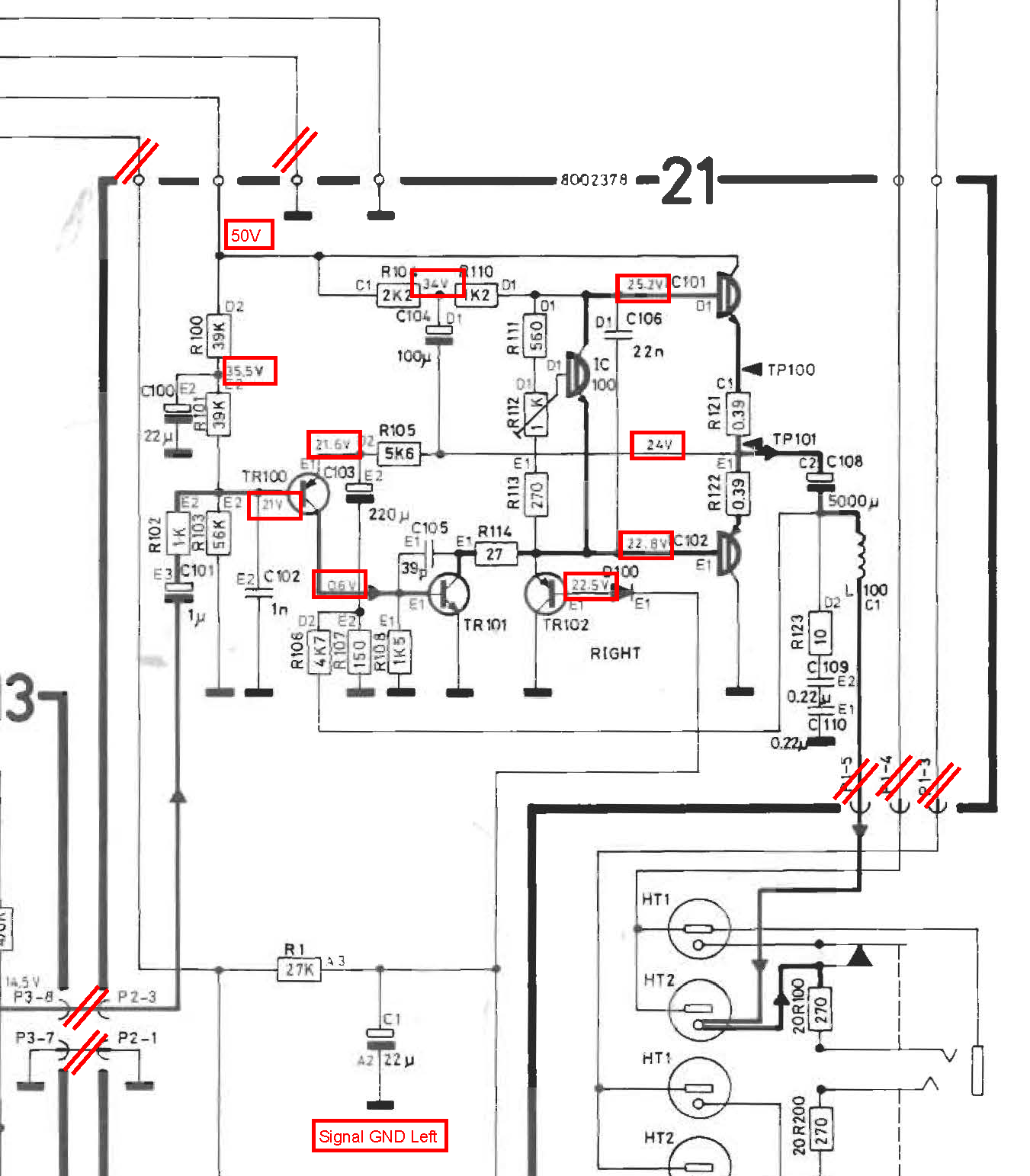

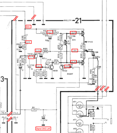

Output stage diagram for one channel - The ‘Red’ squares indicate parts that burnt-out when speaker cable was shorted many many years ago

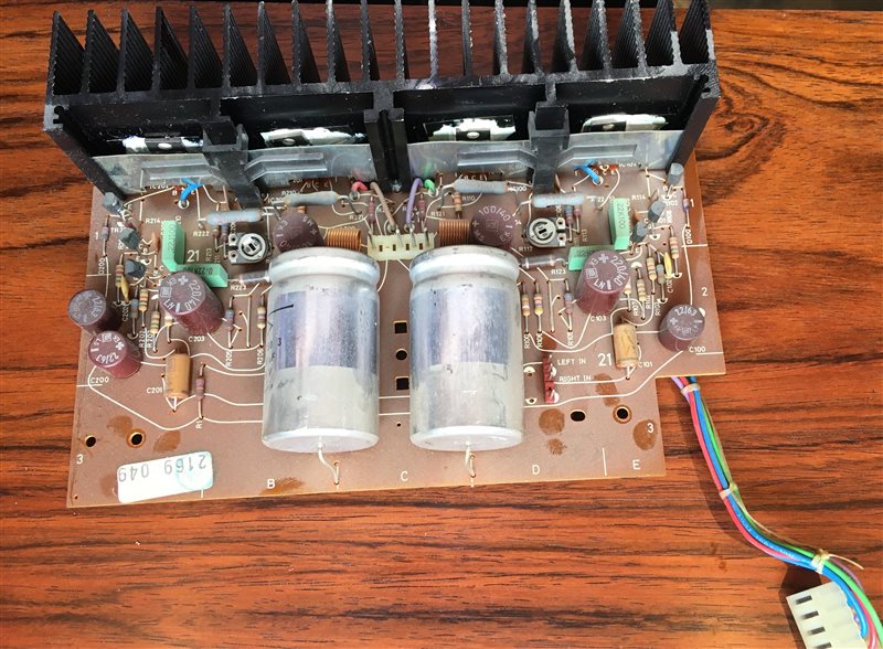

Photo of board as it is now) while waiting for more replacement parts to arrive after 1st attempt - R212(vR) - R214 - R221 - R222 - also showing some of the old components removed from original shorting mishap circa 1990's

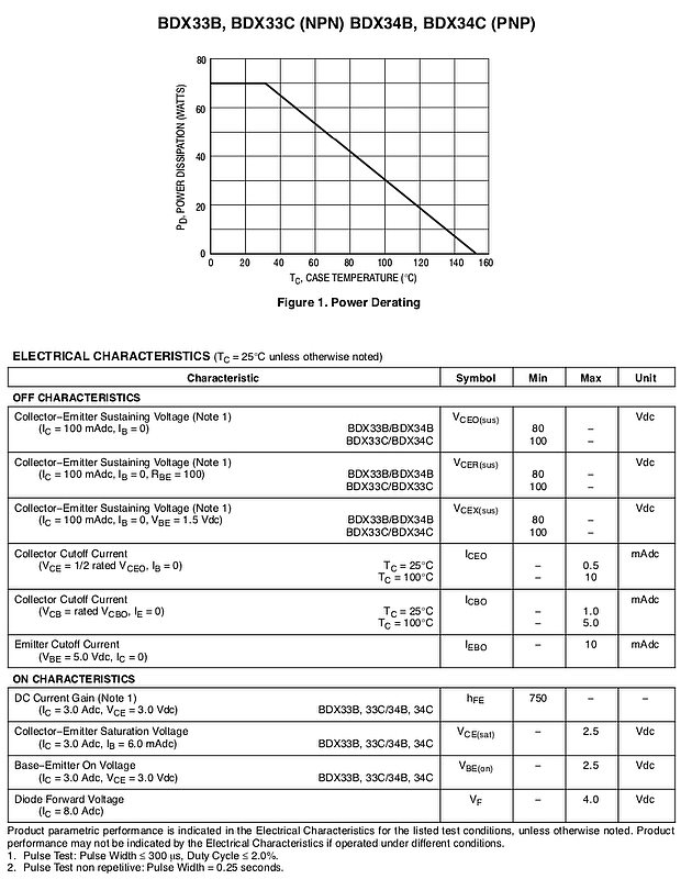

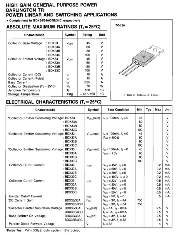

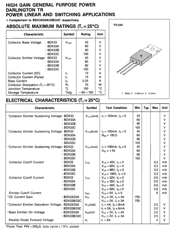

Electrical Characteristics of BDX 33a/34a (B&O’s suggestion for replacement to TE1088/9)
Electrical Characteristics of BDX 33c/34c (interwebs suggestion for replacement to BDX 33a/34a)

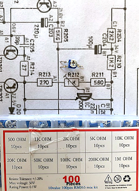

Received an assortment of  "trimmers' today and after doing a simple word search for Trimmers on this forum I've discovered that setting them to a 'minimum' is a good way to adjust the 'no-load' current.
Is that minimum resistance towards R211 or R213 ?
Apologies if this seems obvious but I haven't a clueCrying

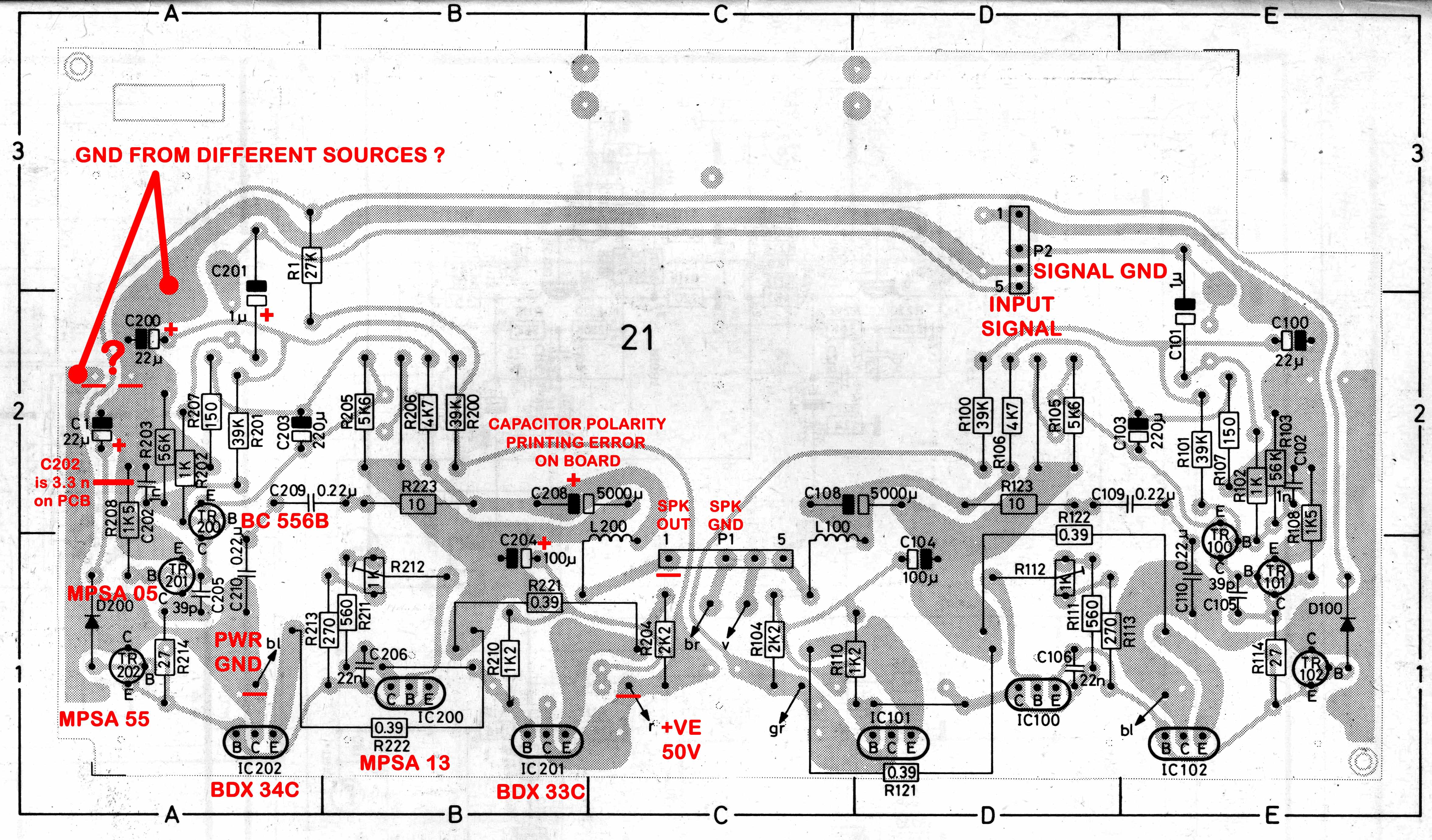

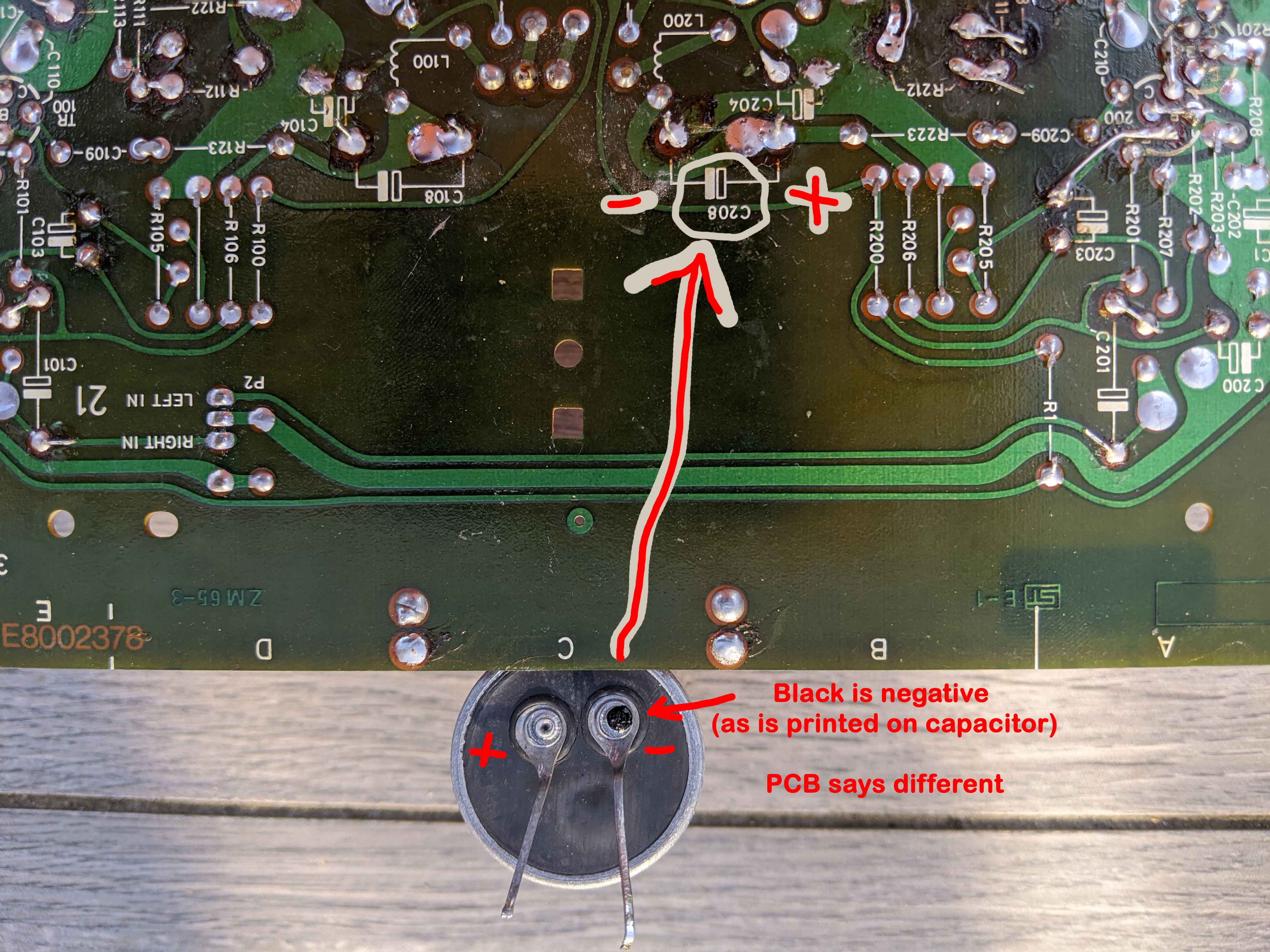

Well well well it looks like B&O printed incorrect capacitor polarity markings on this PCB. (c108/208 '5000uf')
I took the originals off (4700uf) to replace them and foolishly trusted the markings on the PCB !  I've only just discovered that I replaced those two biggies on the board the wrong way round! - The evidence is in the old leads on the 4700uf caps which i removed and in the circuit diagram, maybe thats why everything got a little hot ?
I'll find out later when I turn this thing on... probably for the last time before I ceremonially smash it to pieces with a large rock Unsure
Beocord 1200 and Beomaster 1700 type 1701
manfy
Posts 185
manfy replied on Fri, Apr 24 2020 6:37 PM
Pete:
Well well well it looks like B&O printed incorrect polarity markings on this PCB.
Yes, good catch. The screenprint is wrong.
Negative must be connected to the coils L100/L200. The layout drawing in the service manual does show the correct polarity.
Crying I'm afraid you may be drawing the wrong conclusion. It's true that if you turn the trimmer to a minimum (=max counterclockwise position, i.e. turning it towards R113) you will get the smallest voltage on the base of IC100 but that alone doesn't quite guarantee the smallest bias current on the output transistors! But to be honest, it's not immediately clear to me what IC 100 is doing to the output transistors.
If I were you, I'd measure the setting of the old trimmers and use that as the base setting for the new trimmers at first power-up.

Of the two 1k VR's removed; one is fried and the other is reading 1.1k with 0.6K towards R113 0.5k towards R111 so I'll set the values and see what happens, one channel powered up at a time.

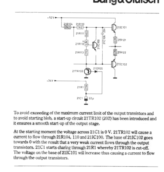

Below is what the service manual says regarding components near IC100

Dillen replied on Sat, Apr 25 2020 7:02 AM
manfy:
Turning the trimmer towards R113 would take the idle to max as it would drive IC100 off.
To start with minimum idle current IC100 must be on = trimmer slider moved towards R111.
IC100 is clamping the two bases of the output transistors, and it's an NPN type.
Martin
manfy
Posts 185
manfy replied on Sat, Apr 25 2020 7:18 AM
Thanks for this, but naah, I still can't see intuitively how IC100 sets the idle current of the output transistors. It balances the base voltage of the output transistors and I guess by doing so it indirectly sets their working points and idle currents.
Anyway, never mind. The circuitry does work in principle or else it wouldn't have been realized that way.
The function of TR102 is very clear with this description and thinking of your initial description of the problem, I'd carefully look at that transistor. If this one is shot, i.e. shorted from C to E it certainly would explain why your output resistors R121/122 go up in smoke immediately after power-on.
Please note that the description in the service manual is just a conceptual explanation! If you look at the circuit diagram you see that 21R1 is fed by +50V and not +34V!! And that in turn would nicely explain why IC100 got shot and why all those resistors got fried.
In your first post you asked about TE1088 vs BDX33C. Don't worry about it. The service manual shows that B&O used 3 alternatives for that darlington: BDX33A, TEO1088 and FJ3001.
So, BDX33C is perfectly fine. The only difference between A, B, C, D type is max Vce of 60, 80, 100, 120V respectively.
Do you have a DC power supply that goes up to 50V?? If so, the output amp can be tested nicely on its own: Leave input and output disconnected and slowly increase the supply voltage while watching the current drawn. This way you can measure various points on your circuit at a lower voltage that is non-lethal to the components. This allows you to assess what's wrong without sending additional components into nirvana.
Cross-posted with Dillen. He's a professional with hands-on experience in B&O equipment, so his word can be trusted! Smile

Pete:
No I do not but I have a Manson 3-15v supply and connected it up briefly. It drew 4amps at 5Volts ! Needless to say the R221/2 went hot! I suspect I previously killed the BDX's (by putting C2 the wrong way round) there is no resistance between collector and emitter on both BDX's with the board un powered. I'm getting 3k and 6k resistance between the C and E on the TR102/202's - haven't taken anything off the board yet..
Believe it or not, that's actually a good thing to see such a high current at such a low voltage: It shows that you have a major problem with one amp and that is usually quite easy to find - as opposed to intermittend problems for instance.
Your 3-15V supply is sufficient for that.
First to your caps C108/208: You said the speakers were disconnected during first powerup. That's good. The caps were "almost free floating" except for R106 and R107 that connected them to GND. That makes good 5 kiloohm, so with a bit of luck you didn't seriously damage those caps. (I trust you measured their capacitance ok when you reassembled them the right way, right?!).
Since the speakers were not connected, those caps mounted wrongly were certainly not the reason for the excess current.
So, it appears that one channel is working fine and the other has this overcurrent problem. That makes things simple because you can compare measurements from one channel to the other and if any value is substantially off, you can focus on the components in that path.
If the current is sufficiently low at 3V then you can measure and compare voltages. Usually you'd start around the transistors because they are most likely to fail.
Alternatively you could just compare resistance values at various test points without any need for a power supply. Such a high current suggests that something is shorted somewhere in the faulty amp.

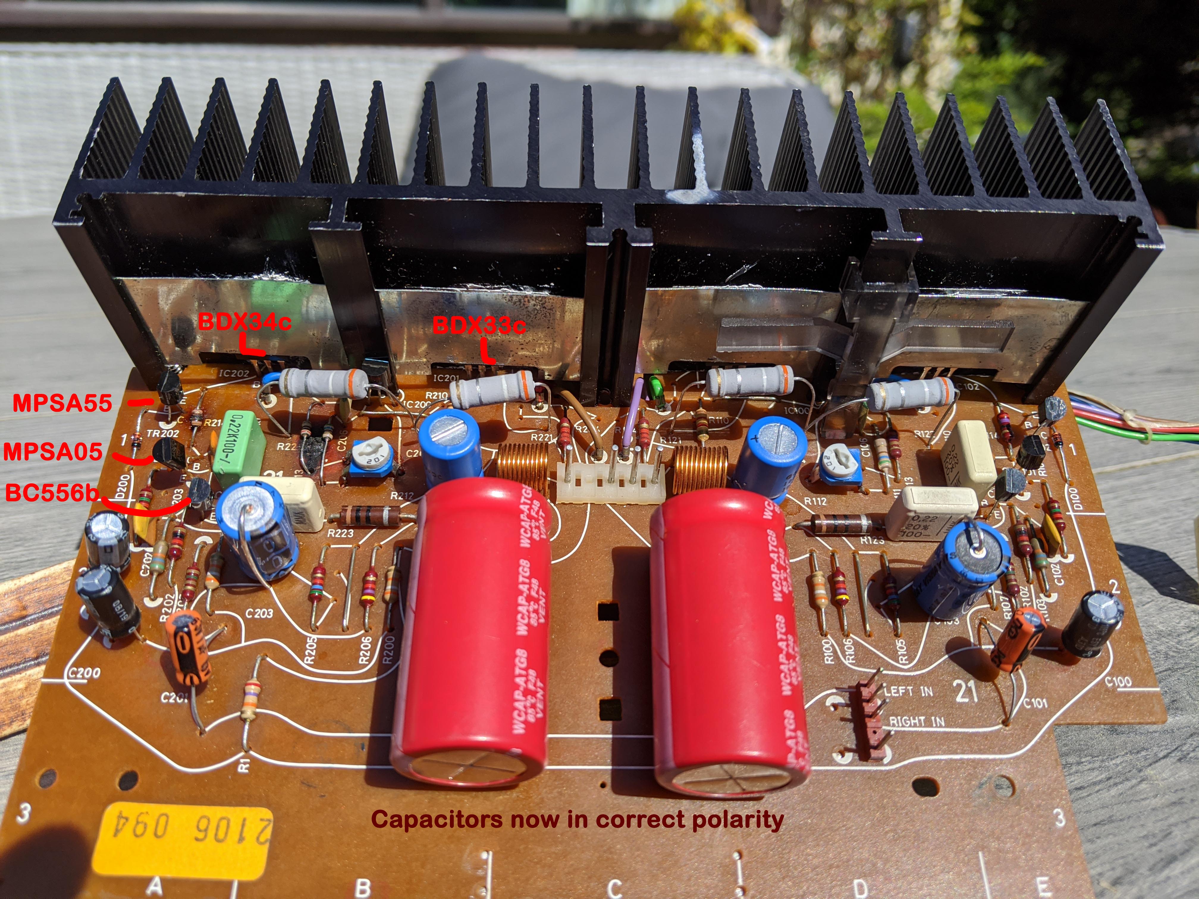

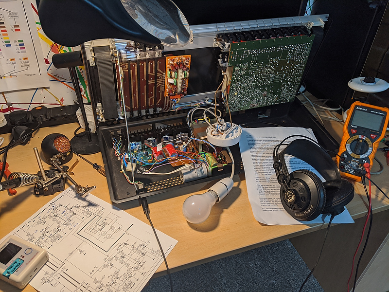

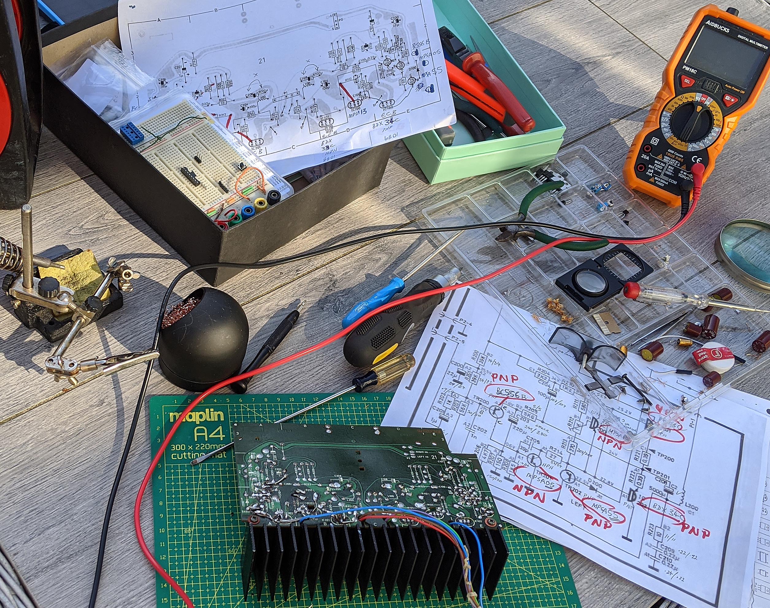

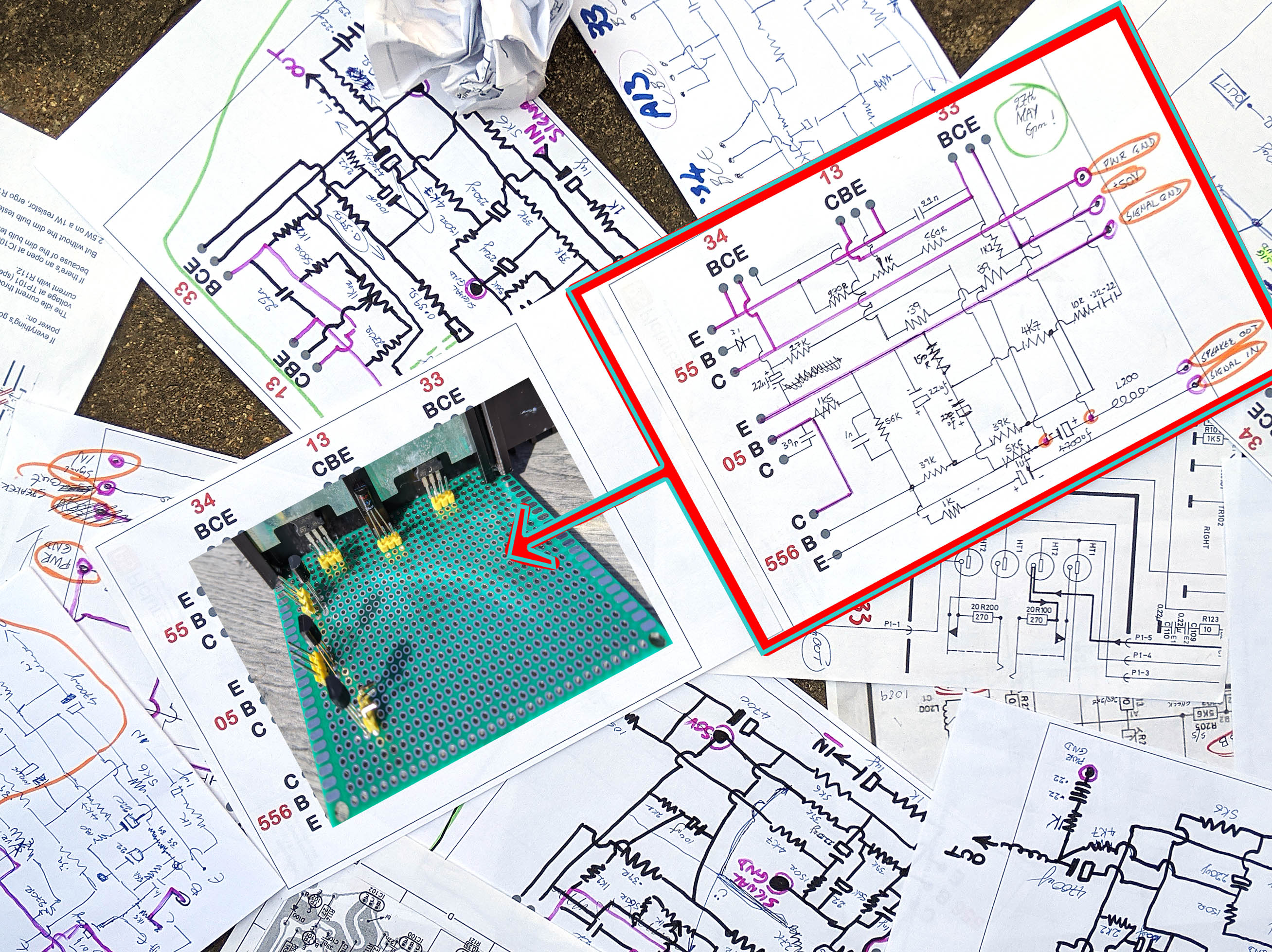

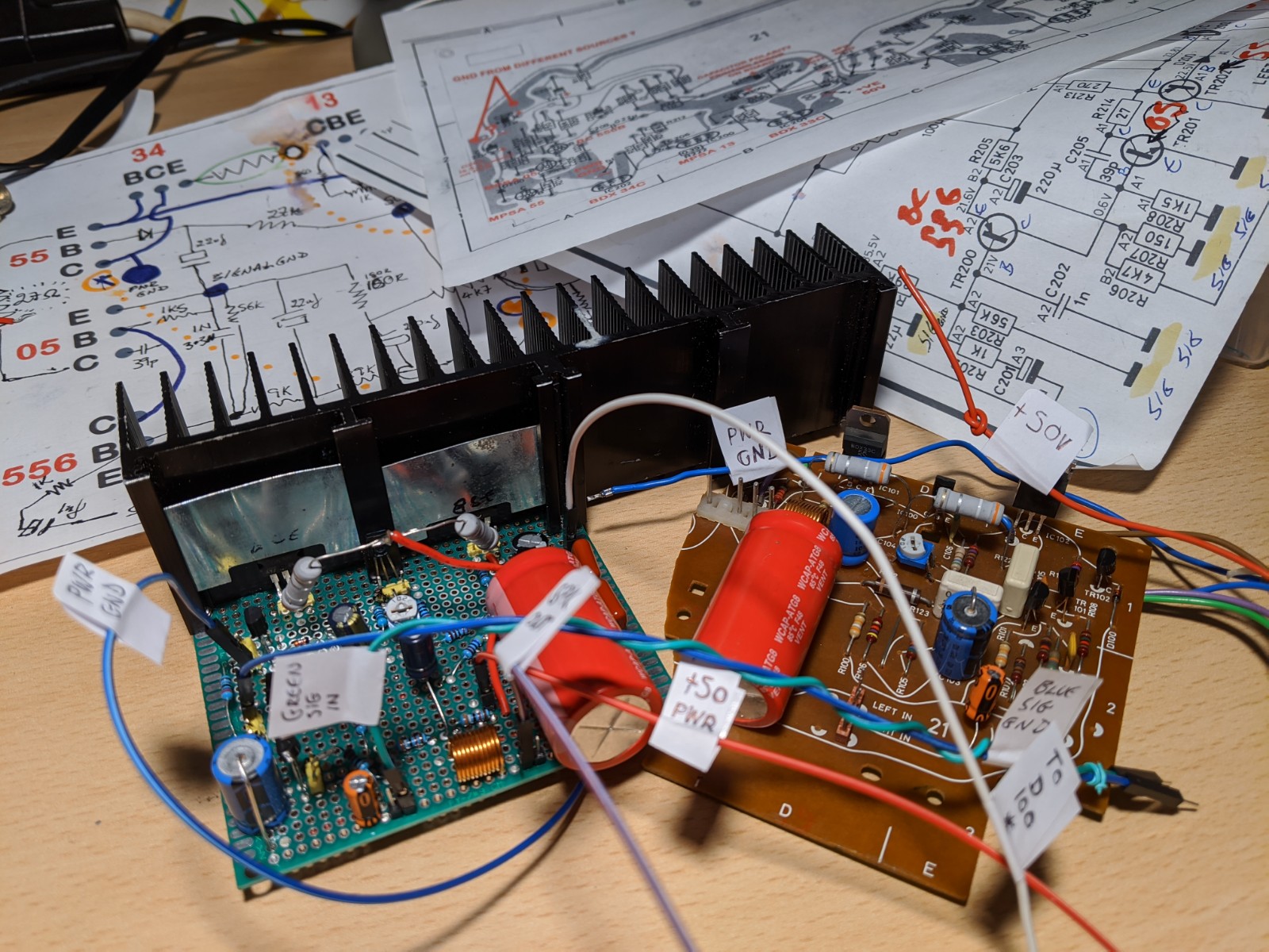

The enduring learning curve to enthusiastically repair one channel of a shorted Beomaster 1700 amp continues..
Step:
1.Google (other search engines are available) to find similar issues/solutions
2. Find a service manual/circuit diagram/schematics et ‘al
2.Forums are your new friend
3.Try to explain everything
4.Ask the right questions
5.Don’t expect all the answers
6.Hope for questions…
7.Photograph everything before, during and after ‘tinkering’
8.Remove components from a PCB with a sucker or wick to avoid damage to PCB - see photosOMG
9.Research any discontinued component electrical characteristics to find valid alternatives
10.Test component values / replace if necessary
11.Learn the difference between PNP / NPN and understand that not everything is the same in component pin layoutEmbarrassed ie BC556b is PNP yet has a different Base/Collector/Emitter configuration/orientation to others!
12.Don’t trust PCB screen print layouts or schematics, compare every component to other circuits and industry standards. eg Capacitor polarityUnsure
13.Buy new components based on above
14.Send out white flag
15.Wait
16.Turn on…
= Success / Failure
This weekend all the defective components will be replaced to the PCB and every one checked for connection to their correct place on the PCB according to the circuit diagram. Check over many times and check again then to power up - (power supply checked!)
Wish me luck - see you on the other side

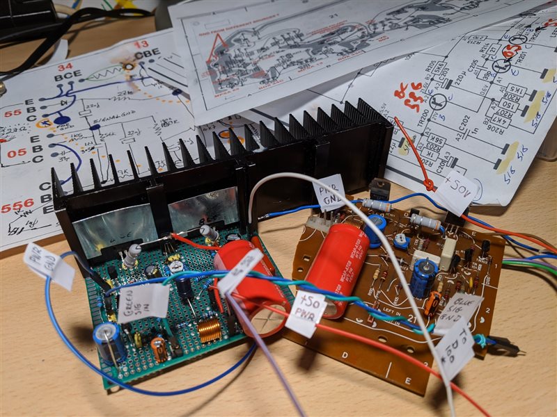

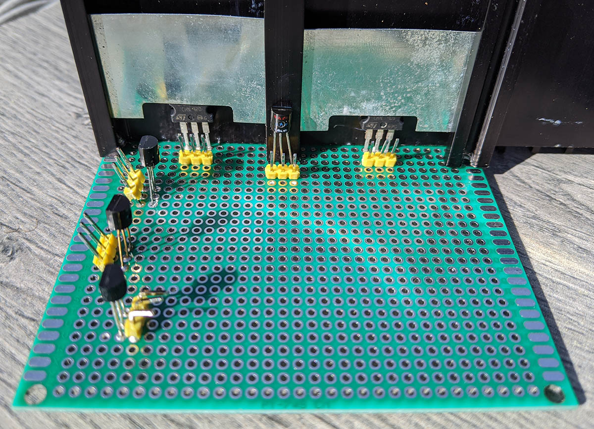

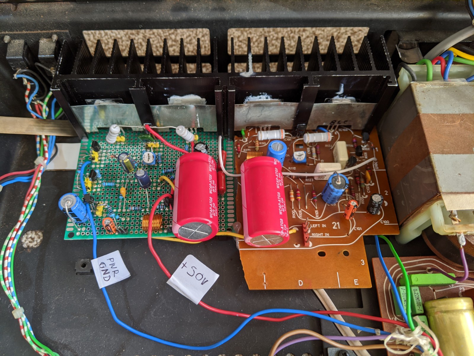

The ‘Life is too short’ option is:
HiFi 2.0 Channel Power Amplifier Board HiFi Stereo Audio Amp DIY KIT MJ15024 and hide it in the B&O case (-:

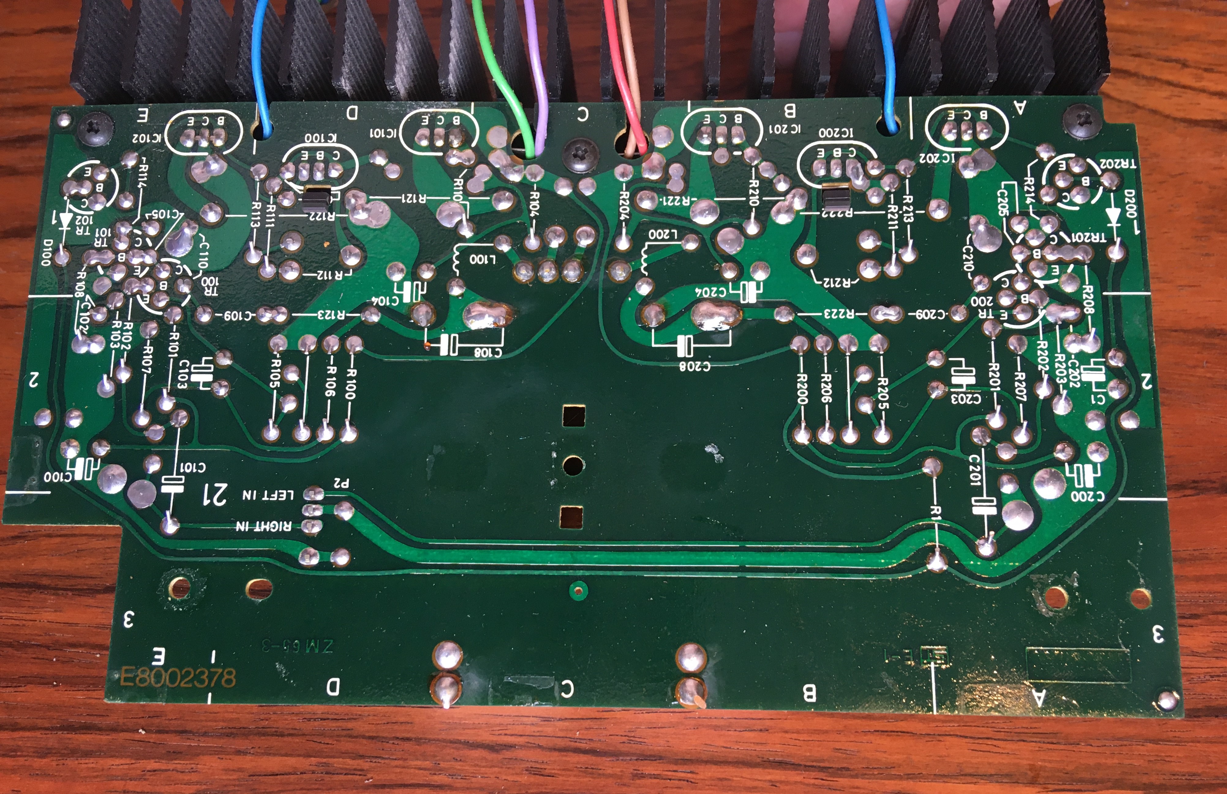

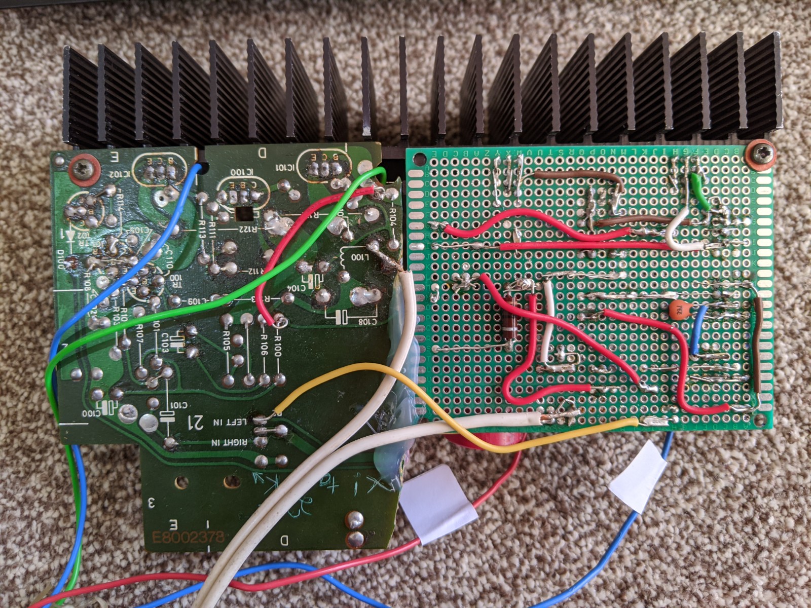

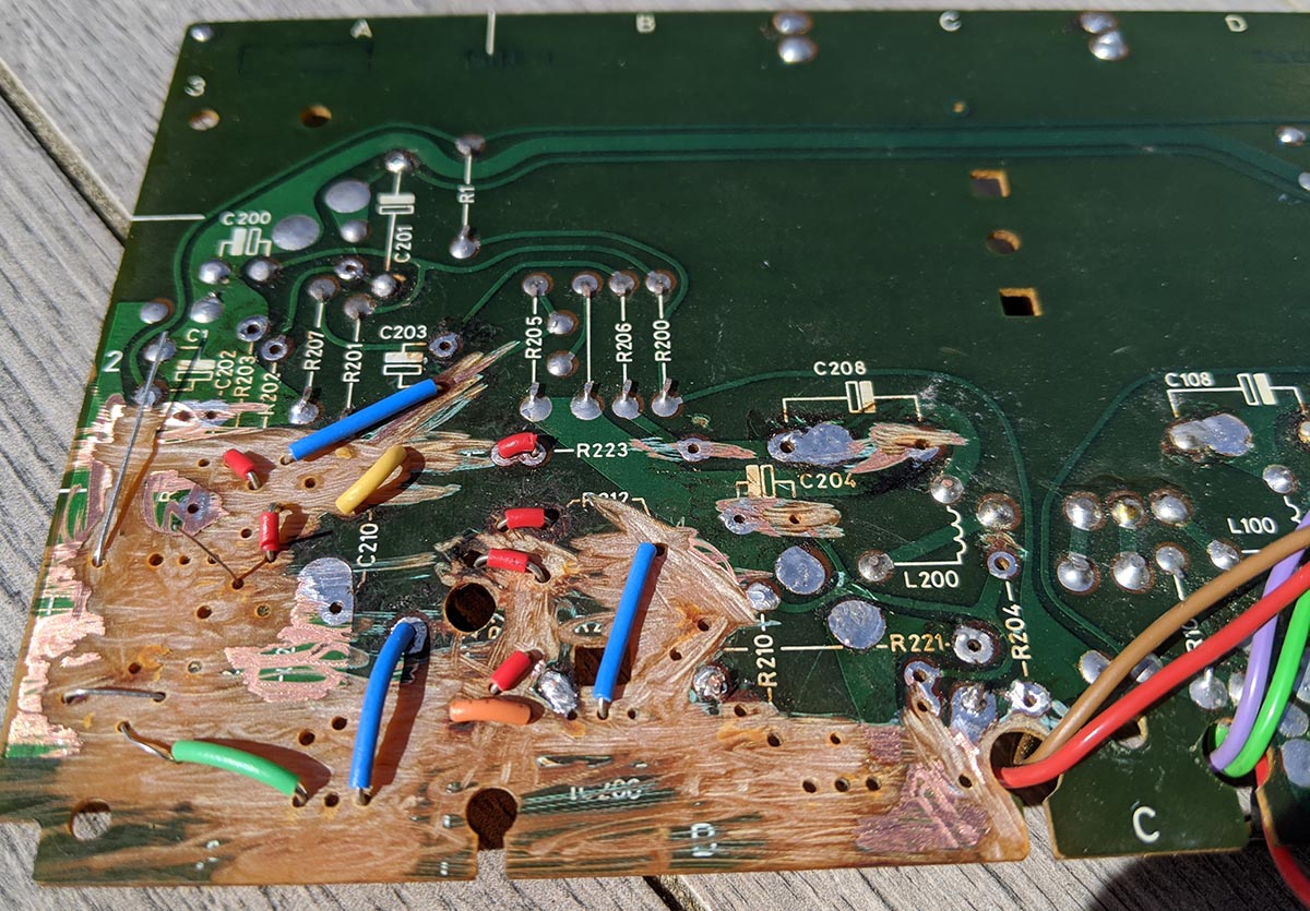

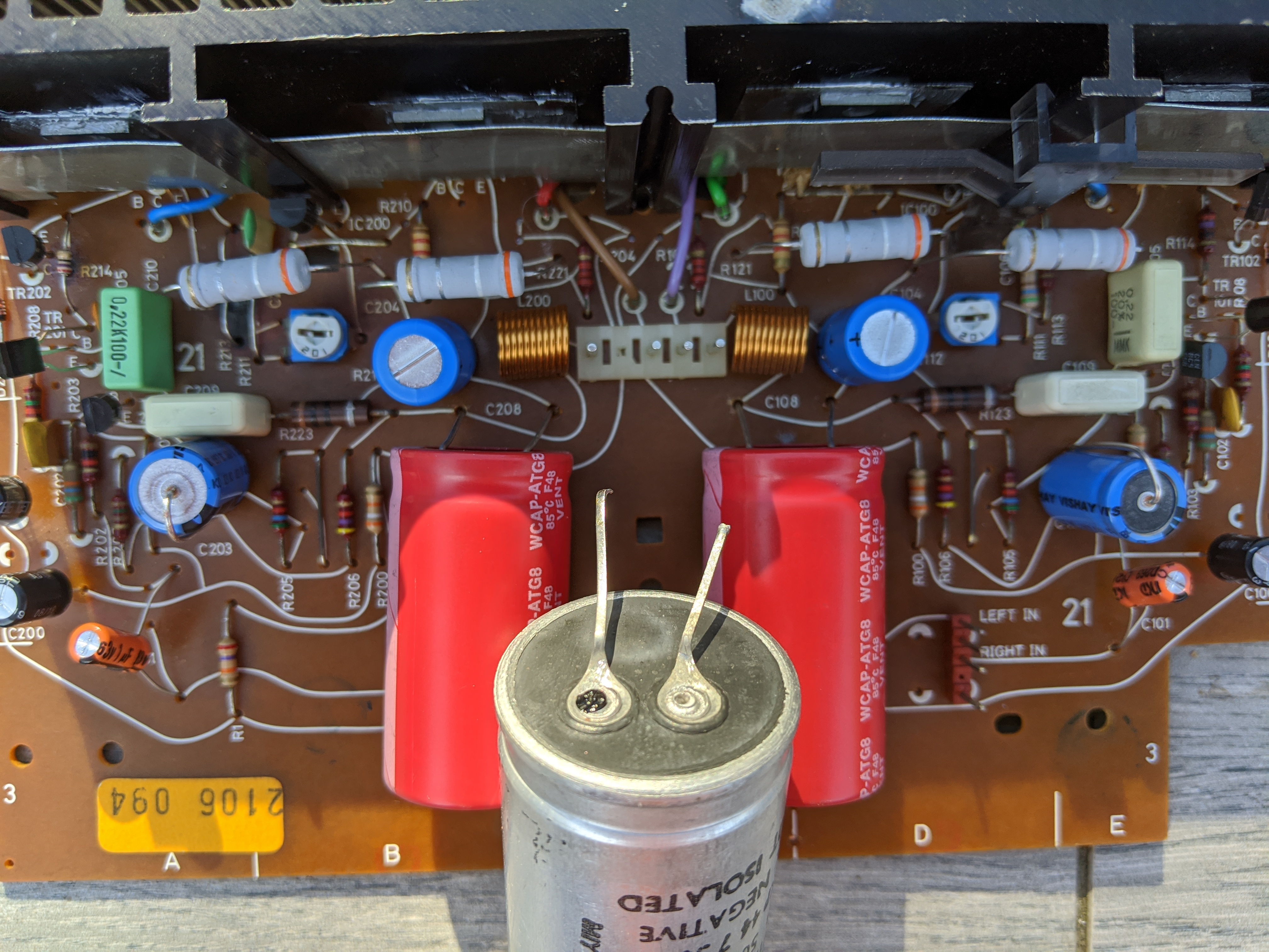

Photos illustrate chaos, frustration and incompetence, mildly mixed with enthusiasm and hope (-:
board without TR/IC's
PCB connections drawn based on circuit diagram due to soldering train wreck!
what a messHope this helps someone out there...

Maybe its me but it looks a bit like some of the traces are missing. and lifted.
Honestly don't know what to make of it.  Is that supposed to be the desoldered or soldered state?  I can't see how any of that could be working.
Pete:
Pete
UK
Posts 25
Pete replied on Sat, May 2 2020 6:35 PM
lots of tracking had lifted so had to work out what goes where before putting transistors back. What u see is the board without transistors. Work in progress - sort of 😇

If you ask me, then what you see is a board beyond rescue.
Your soldering iron is way to hot.

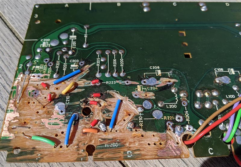

I've noted where all the tracks are supposed to be (see diagram with my red line markings) and plan to link all areas where I've previously destroyed them with a too hot iron and too much tugging!
The problem of removing components came quite late to me after I realised I had a solder sucker from years ago which would have made it so much easier and tidierSmile Lesson learnt
All new components have arrived by mail/post so plan to instal them on the PCB and carefully check (twice/three times) all the links i make where there are no tracks.
But first i will check all new transistors with multimeter for irregularities, inc hfe, pin layout, dudd components - a 'kind of' quality control
This really is my last go at this. 'Lockdown' with CV brought me here to learn with time at handPerfect

Please don't think I'm ragging on you...
Poor technique has made a simple (ish) job rather more involved than it needed to be.  Take some time to watch a few soldering videos on YouTube.  There are also a few on desoldering.  MrCarlsonsLab   https://m.youtube.com/channel/UCU9SoQxJewrWb_3GxeteQPA  might be a good place for you to start.
Properly desoldered parts more often than not just fall out, no tugging or force required.
A hot iron is not bad on its own, but dont dwell too long, otherwise you'll end up melting the board and resinous material, separating the the traces and pads - which is the mess you've got now. IIt might be recoverable, but you need to be patient and not continue to make the same mistakes.
Seriously, spend half an hour to an hour watching some vids on soldering technique and you'll be in a better position to complete this and will probably save yourself at least tht amount of time by not making things worse.

I even have proof....aaand an explanation why your offline tests didn't work out:
According to the circuit diagram in the service manual, there's only one type of GND on that board. But when you look at the layout drawing, you can see that you actually have 4 (in letters: FOUR) separate ground planes: power ground left, power ground right, signal ground left, signal ground right. Crying
Granted, all those ground planes are galvanically connected at a star point in the power supply, but they are physically separated on the amplifier board! No wonder your offline test didn't work!

Just to set the record straight: Keeping signal GND and power GND separated really IS a good design practice. It avoids noise in the signal path and it's still a common thing to do in modern electronics. But when this happens you normally use different GND symbols in the circuit diagram.
So, basically it was my mistake to tell you that you could test the board by disconnecting input and output and supplying power with a DC power supply and then start measuring.
We will still do an offline test of the amplifier board, but you will have to prep the board first. So please do not try to power up the amp before we've done that.
Regarding the light bulb, yes, you have to connect it in series into the mains lead. The light bulb acts as a cheap power resistor. If everything is fine with the board, it will only draw a small current, the voltage drop will be small across the bulb and it  will be dim. If there's a short circuit or similar problem on the board, it will try do draw a high current. Now also the current in the mains line will increase, i.e. the light will be brighter and there will be a bigger voltage drop across it, which means the trafo voltage will go down which also lowers the current drawn.
It's quite simple actually but if you want, you can search the net for "dim bulb tester" for additional details.
Generally you can assume that the circuit diagram in the service manual is correct. But don't take that as a guarantee. Mistakes can happen. Especially for vintage products made before computers were mainstream, such typos or mistakes may have been intentionally overlooked because scrapping and reprinting of 10,000 service manuals was jsut not a viable option. They were probably just reported internally with separate change notices.
Just keep in mind the legal disclaimer: "Subject to change without notice." and if something looks really starnge, just double-check the circuit diagram with the actual board, layout and components and if you find a discrepancy, you have to figure out what is right and what is wrong.
There's one more thing I want you to check and confirm: The power transistors on the heat sink need to be isolated from the heat sink! Normally there's a mica sheet between the metal part of the transistor and the aluminum heat sink. Check the resistance between the collector of every power darlngton and the heat sink. If there's a short, fix it.
Last thing: terminology. Earth (or PE [potential earth]) and ground are 2 distinct concepts in electronics. To avoid confusion, forget about "earth". Let's call it GND from now on.
More later!

Here's how I would approach this fix now:
1) visual check of the board based on the service manual
2) quick check with a multimeter in continuity test mode around all the suspicious spots on the board (that means all the spots that were affected by the soldering massacre)
Once that is fine, I'd prep the system for the power-on test of the amplifier board:
- the dim bulb tester with a 40W bulb is required for this
- to make sure that the other electronics of the BM1700 doesn't affect my test, I'd disable it by unplugging P5 connector from the power supply board 22
Since I want to test left and right channel amps separately, I'd prep the board this way:
- I'd start testing the right channel because in your case there's a higher chance that it works
- desolder the wire for 50V supply and 'power GND left' from the left amp
(alternatively you could also unplug connector P6 from the power supply and run test wires with croco clips to the right output amp)
- solder a jumper wire from 'power GND right' to 'signal GND right'. You don't have to worry about 'speaker GND right' because the speaker MUST BE DISCONNECTED for this first test anyway!!
- solder another short wire to 'power GND right' which we will use as a clearly defined GND point for the multimeter. All voltage measurements will be done against this GND point and this point only!
- IMPORTANT: turn trimmer R112 to maximum, i.e. turned toward R111. Confirm this by measuring the resistance between base of IC100 and R111. It must be zero or less than one ohm!
Please note: Since '50V supply left' and 'signal GND left' is now disconnected, we also disabled the startup circuit R1/C1 for the right amp! That's fine as long as you do not connect any speaker to the amplifier output. I'll show you later why this is so.
Now we're ready for the power-up test. Our setup in short:
- only the right channel is connected to 50V supply and GND; signal GND right and power GND right are shorted on board 21
- amp input and output, i.e. the speaker is diconnected!
- trimmer R112 is set to maximum
- primary side of transformer is connected to mains with a 40W light bulb in series
Once you press the power button on the beomaster, you should see a short bright flash from the dim bulb tester because of the inrush current and then the bulb will go dim. If there's still bright light after 1 second or if you see smoke coming from your circuit, switch off immediately -- but this is very unlikely provided the dim bulb tester is wired up correctly.
You should measure and log all voltages marked with a red box (if they are off I'll need those actual values to assess what's wrong):
manfy
Posts 185

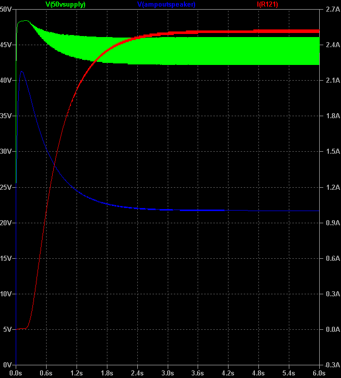

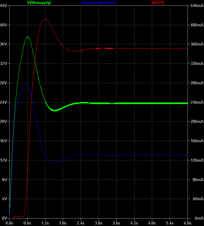

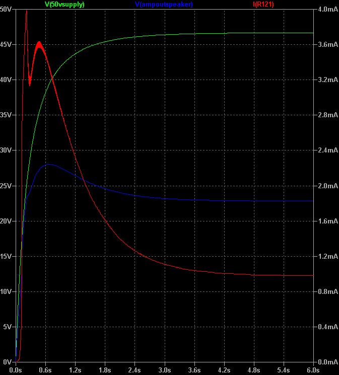

manfy replied on Sat, May 16 2020 11:18 AM
If everything's good on the board, you'll see something like this in the first 6sec after power on:
The idle current through R121 is below 1mA, supply voltage close to 50V, the voltage at TP101 (speaker output) is about 24V and you will be able to adjust the idle current with R112.
If there's an open at IC100, you'd see good 350mA at R121 (which is not a problem because of the dim bulb tester)
But without the dim bulb tester and the same fault on the board, you'd see 2.5A, i.e. 2.5W on a 1W resistor, ergo R121/122 would have every right to smoke! Stick out tongue

Pete replied on Mon, May 18 2020 4:57 PM
Photos below are not for the faint hearted - LOL
attempted work-around ruined pcb tracking !!!!
After everything...starting from scratch to make one channel of the amp onto double sided vero is the final option feared!
Once all is in place there'll be testing and measurement as advised by manfy and if it works out another channel will be built exactly the same
There was never any intention to restore and sell this B&O, I just wanted it as a living (working) reminder of my uncle. Everything works apart from the output stage - bit like life really (-:
Yes, I'm quite mad!

fkatze replied on Tue, May 19 2020 4:45 AM
Pete:
Yes, I'm quite mad!
...as long as you know Laughing
You are pretty far in now, and it is too late to scan that original PCB...
I wonder if you wouldn't have been better off going for something like an LM1875 (in a pair) solution if the goal is just to get it to make sound again?  Fewer components needed and probably an easier solution overall.

I've scanned the PCB layout from the manual received via snail-mail so as to check all tracks against circuit diagram - all seems ok - (notes on diagram)
Checked a few resistances on the connectors to the Power amp inside the case (Power Amp PCB not connected)
Signal GND to Chasis = 90 k Ohms
Signal GND to GND on Power Supply = 0.5 Ohms
I notice on the PCB there are two holes drilled, one on signal GND and the other on Power supply GND... Could the GND issue be the cause of all these components frying? I wander, when I construct the new board should I merely connect signal GND to Power GND to test the new board?
I'll construct the new board with that 'option' over the next week - just makes it a little harder with two separate sources for GND
all good fun Erm..Laughing

0.5 ohms between both ground planes at the power supply is normal because that's where they are centrally connected. 90k at the board is possible because of various components that link the power path and signal path.
Those 2 holes between signal GND and power GND look like a precautionary design measure. At the time of board design they were not sure if power GND/signal GND separation was "worth it". But ultimately they found that the separation was benefitial in terms of noise rejection, so they kept the planes separated, which forced them to run the extra wires from power supply to amplifier.
When you construct the new boards, you should retain that separation, or else you'd create a ground loop when connecting the preamp and that might cause a hum or other noise. For offline testing of this new board you can - actually must (!!) - connect those 2 GND points at the amplifier board, but when you connect the preamp, the jumper between power GND and signal GND must be removed.
In the original design the startup circuit R1/C1 acts on both channels at the same time, but in your new design you should add the same components to each channel. Make it part of the power path (and not the signal path as done in the original!!). This way you have 2 identical, interchangeable boards for the 2 channels and you don't have to worry about modifications for offline tests!

Pete replied on Wed, May 27 2020 6:10 PM
Nearly there - in principle!
Latest draft of many before soldering components onto vero board:
...might just check the circuit against the manual a few more times thoBig Smile

Dillen replied on Sat, May 30 2020 1:28 PM
(Click photos to enlarge).
Tested this afternoon prior to dismounting. Plays fine.
All original apart from my fingermarks in the dust.
Interested?  Whistle
I also have the power supply.
Martin

Pete replied on Sat, May 30 2020 2:30 PM
Behold a thing of beauty ! Smile - brings back happy memories of what my board looked like a few months ago before i started 'repair'
Very interested... but have I gotten too deep into the replacement project to afford such a solution?
You'll know my first question..
please PM me a cost inc UK delivery
Thanks for thinking of me and posting such fab photosCool

Pete replied on Sun, Jun 7 2020 1:33 AM
a few more snaps to amuse you allOk...
One channel completely rebuilt / circuit checked and wired up with untested original board containing new parts.
Now to start from scratch (again) and follow Manfy's kind instructions on how to unwire and rewire power supply and various GND points to test voltages whilst having a 40w bulb in serial with live 240v.  A 40w bulb in serial with mains power is tested (without amp board connected) and hey-presto bulb lit briefly and then went very dim - just need to understand wiring (signal and power GND conundrum) for each channel test as I've incorporated the 'startup circuit R1/C1' on the new board! - before power on to everythingLightning
Hopefully next week we'll have sound Whistle
Pete
UK
Posts 25
Pete replied on Sat, Jun 13 2020 11:45 AM
Today marks a very special occasion for me. The B&O my dear uncle gave me many years ago sings again!Lets have a Party !!!Lets have a Party !!!Lets have a Party !!!
Since lock down here in the UK, I have for the first time ever, built a circuit board from a diagram, tested it and it works.
The voltages manfy illustrated tested symmetrical on both left and right channels (all be it slightly lower by a few volts in places due to power supply on throwing out 45v) and the only issue had was when the board was clamped into place with the spring clips onto the heatsink. It seems a 50 year old board does not like my soldering technique (or lack of it) as the new BDX’s strained at their feet and lifted welds to the remaining tracking on the pcb… but after a quick repair with a bridging wire… hey presto! the amp produced its warm tones once more.
Having restored all the other components to function correctly, all potentiometers cleaned, belts and clutches cleaned and tightened, and no load current adjusted to spec it’s time to close the lid (hide the train wreck) and clean the outside. The only thing about this amp/receiver that isn’t working is one LED light on the first FM slider.. I will leave that off in memory of my uncle. He would have found that amusing (-:
Thanks go out to everyone who helped along the way. It’s been an enjoyable (sometimes frustrating) learning curve... and a special thank you to Dillen who sold me an original amp PCB which arrived the day I repaired to old one. IronicLaughing
Removal of components and soldering new into place will never be the sameWhistle and 40 watt tungsten bulbs are a godsendCool
