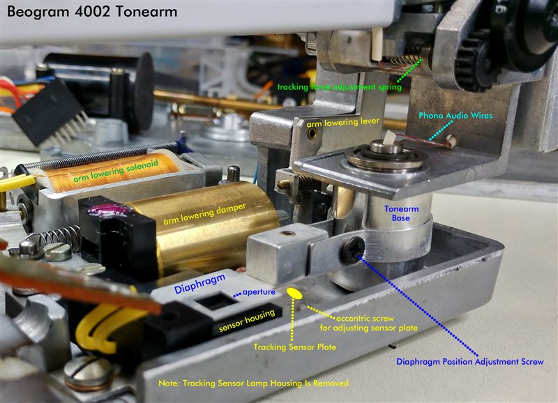

sonavor replied on Fri, Feb 12 2021 7:33 PM
Do you have a copy of the Beogram service manual?  If not you can download it from the Beoworld Forum with a Silver or Gold membership level.
There is not really a part named "interrupter".
The service manual calls it the Diaphragm. I often refer to slot in that piece as the aperture. It controls how much light from the lamp reaches the sensor.
That amount needs to be calibrated per the service manual. The position of the Diaphragm is critical to the Beogram record tracking working correctly.
The Diaphragm should be 1mm above the sensor.
I will see if I have a photo that points to the parts.

sonavor replied on Fri, Feb 12 2021 8:07 PM
Here is a photo.
The Diaphragm needs to be 1mm above the Tracking Sensor Housing. It can't rub against it.
Be very careful in making any adjustments with these components. Changing any of the component positions will require re-calibrating the Beogram record tracking.
