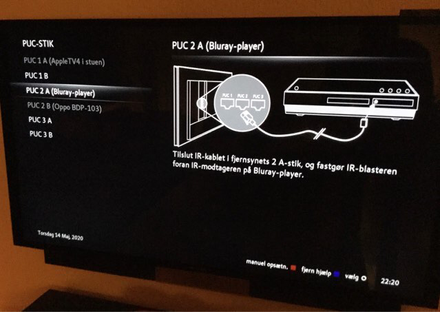

Sollte eigenlich ganz einfach sein.
Du machst das, was auf dem Bildschirm steht (eventuell die blaue Taste drücken für die Hilfe), wenn das Geràt/der HDMI-anschluss konfiguriert wird.
Müsste verständlich sein, auch wenn es hier in dänisch ist.
Ouups - just noticed....you’re writing in english - sorry ;-(
So - pretty easy.
Just follow the instruction on the screen, when you set up the device/the HDMI port.
For the help function push the blue arrow, if not already shown.

Yes that is pretty well explained by B&, but my PUC IR connector has 2 differents sensors, how do I know which one is A and which one is B ?
In your pictures, how do you differentiate between you BR player and your Oppo devices ? Both are plugged on the PUC2 ports.
They should be labelled!
Otherweise try it out - can’t do much harm there.
No problem in differentiating - one is A, the other B - each port carries 2 PUC connections.
Yeah, it’s annoying - they should be labelled but often aren’t. My approach is to hold one of the two emitters in your hand to obscure the signal and work out which is A and B by process of elimination. Remember to label them once you’ve worked it out!
