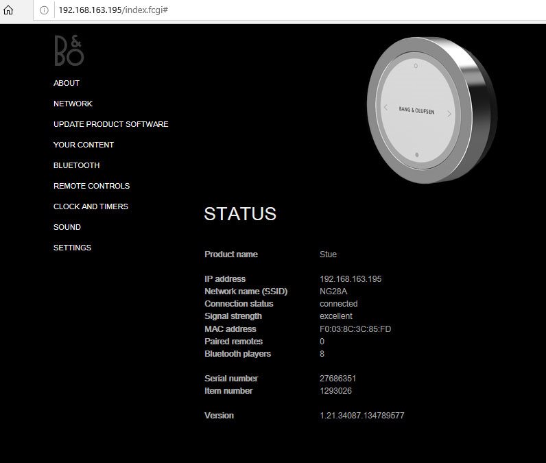

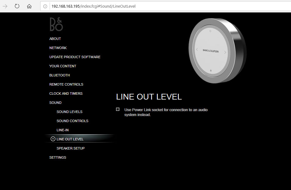

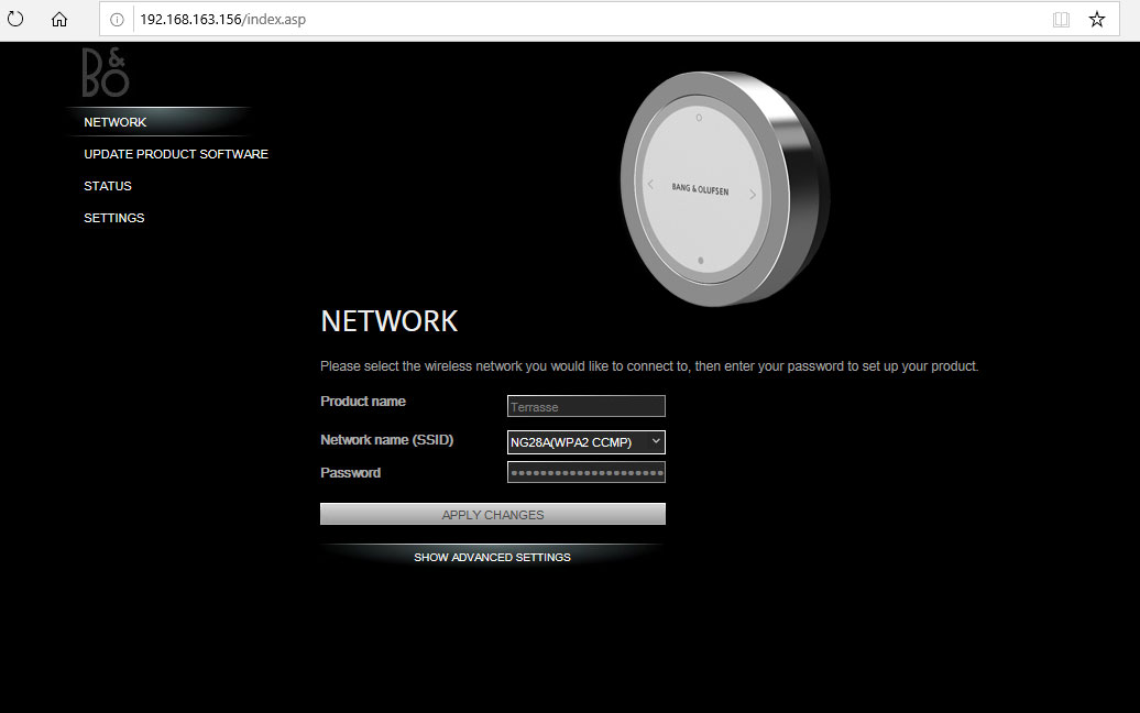

Here are the menus of the BeoSound Essence mk I and mk II (I have them both)
As mentioned, the mk I, was planned to be used outside, so that I could use the B&O app, but I could live without the multiroom option…
The mk I is the 3rd picture (at the bottom), the others are from the mk II
Christian
Carolpa
Top 75 Contributor
Posts 1,700
Silver Member
Carolpa replied on Thu, May 21 2020 5:45 PM
Edit: mk1 is the issue, so the pictures of the mk2 do not matter (as described I do have access to these setup menu's). Sorry
carreracs
Posts 44
carreracs replied on Thu, May 21 2020 5:49 PM
But that is the mk II connected to my BeoLab 5. Outside is mk I and that’s where the problem is.... Mk II has, as far as I can see, a lot more menu options than the mk I.

carreracs:
Hi again
Christian
Please show the menu choices under SETTINGS

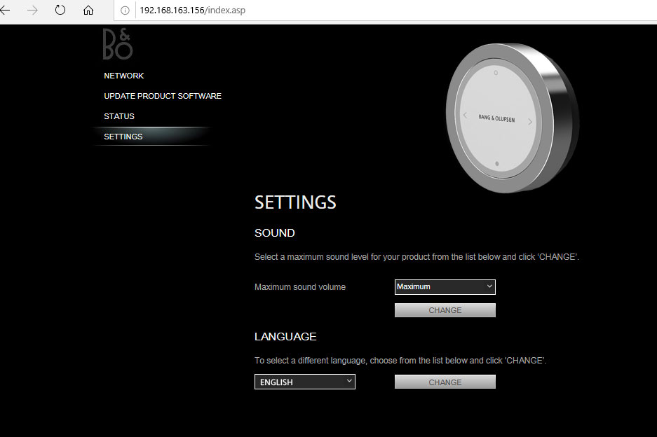

carreracs
Posts 44
carreracs replied on Thu, May 21 2020 6:21 PM
Carolpa
Top 75 Contributor
Posts 1,700
Silver Member
Carolpa replied on Thu, May 21 2020 6:48 PM
1. what are the options for "Maximum sound volume"?
2. do you have the latest sw version for the mk1? Did you performed an update?
carreracs
Posts 44
carreracs replied on Thu, May 21 2020 7:05 PM
1. Maximum, Loud, Medium, Quiet, Custom, Hotel Setup*
2. The product software is up to date.
CURRENT SOFTWARE
Date 2018-05-22
Version 4189
carreracs
Posts 44
carreracs replied on Thu, May 21 2020 8:06 PM
Well, as long as I can’t choose this in the menu, I can’t do it. In the mk II menu, yes, mk I, no. Seems to me B&O have changed the menu/options.

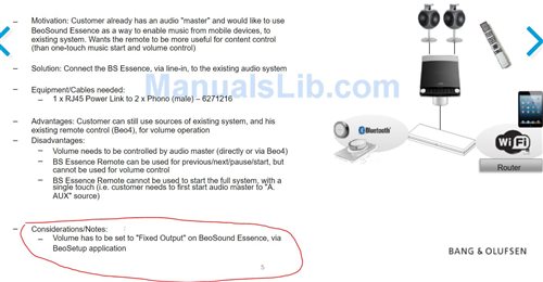

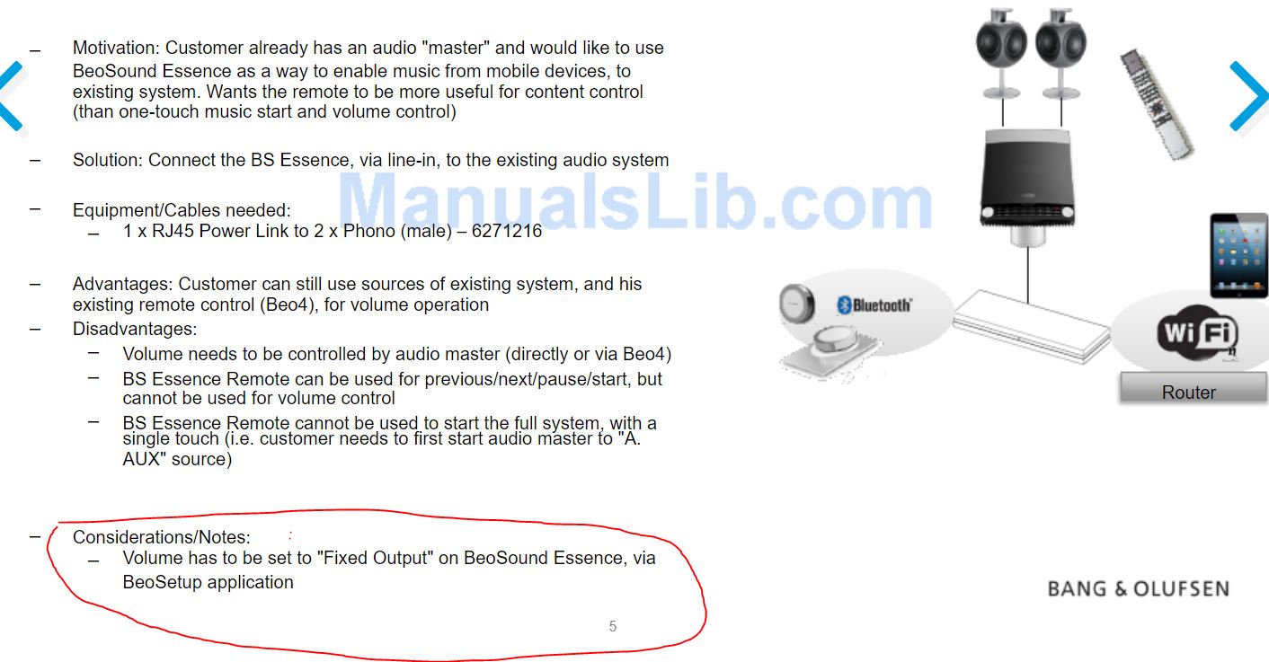

carreracs:
But why on earth would they cut these options? Very disappointing :-/
Christian
If cut and not just hidden......probably because only very few used the Essence MK1 that way - to simplify the setup.
carreracs
Posts 44
carreracs replied on Sat, May 23 2020 12:44 PM
So B&O claims that this was never an option, and that nothing has been removed, so this picture stating that the volume must be set to "Fixed output" must be of the mk II?
Here is what they wrote:
Our headquarters have replied.
Unfortunately the Mark 1 Essence remote is fundamentally different from the Mark 2 and the option you have on the later model was introduced as one of the improvements over the earlier one. Unfortunately this improvement cannot be implemented on the Mark 1.
If there is anything else we can assist you with, please do not hesitate to contact us again.
