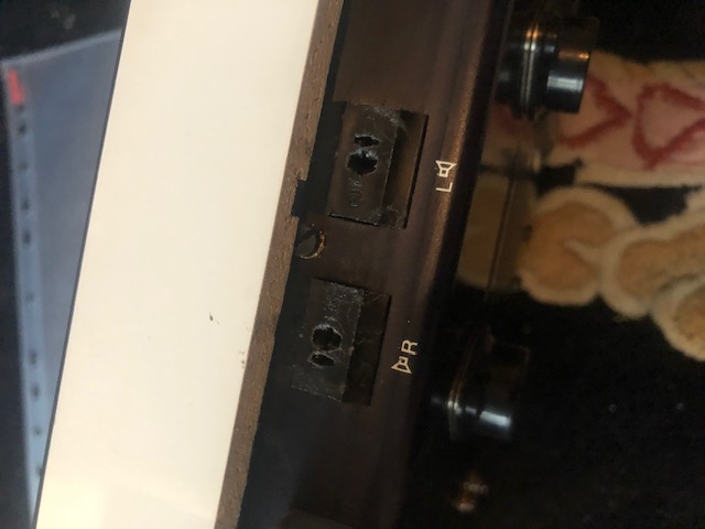

The Beomaster has those 2 pin din sockets at the back. On mine there are quite worn out and so the plugs actually wobble a little so the connection is quite dodgy.

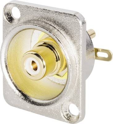

1. Replace the sockets. But I cant seem to find any original parts for these, or even know what to look for. I have found an alternative but it would mean a little cosmetic surgery on the Beomaster.
2. Replace the sockets for a more modern alternative. Like the attached image. Again a little cosmetic surgery but not as harshe as the previous alternative, and I would get a more stable connection?
but first is this even possible? Is it a straight swap or does it mean changing a few other things internally on the beomaster?

Are these sockets for speakers or other input/output devices?

These are just for the speakers. Here is a picture. As you can see they are quite worn out.

I was thinking I could add something like this (in black) But it would mean as I mention a bit of cosmetic surgery.
And not sure it will work if I change to a more modern alternative.

RCA jacks aren't really suitable for speakers.  Either replacement DIN or go for standard screw/banana plug terminals.  If you have trouble finding replacement DINs someone here should be able to source them.  I haven't actually looked for them here, but will next time I head down to the electronics district, probably next week.
