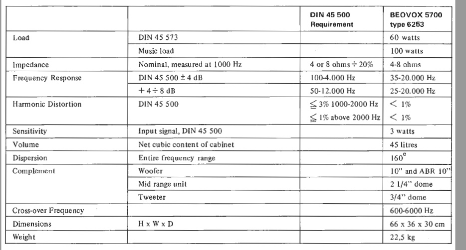

Therefore you will struggle to get a lot on the 5700 looking in the UK though obviously European countries will have a lot more. Here is the spec.
Peter

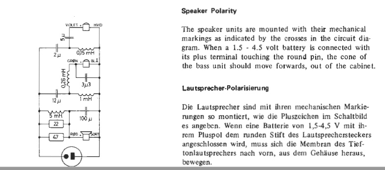

And this is the crossover
Thank you Peter, that is very kind.
