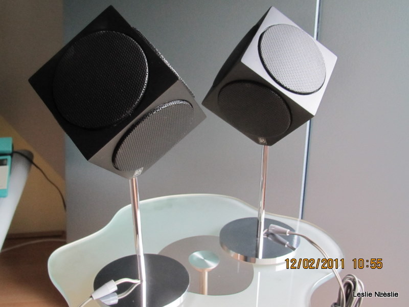

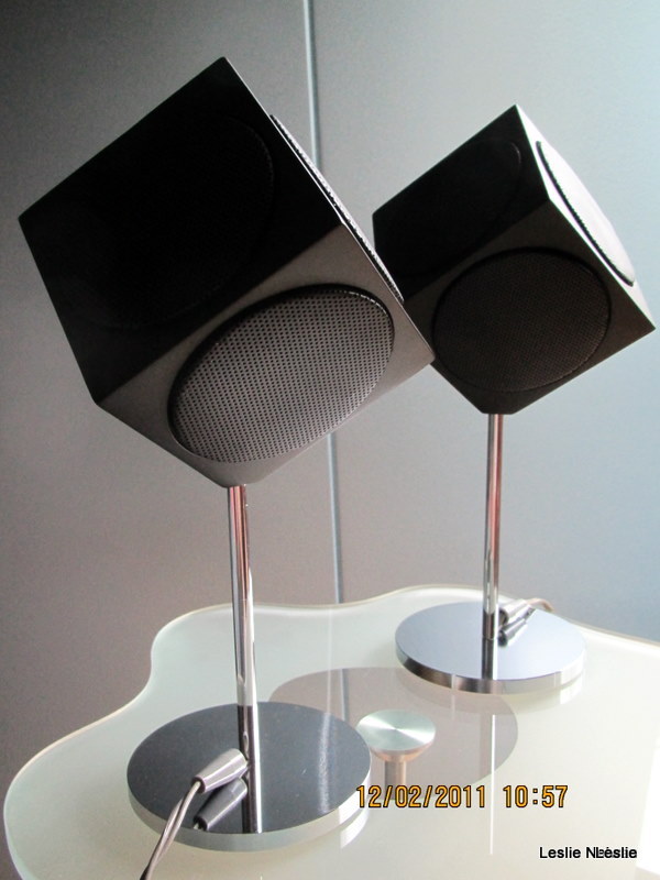

I did a few last summer and as far as I can remember they have a convex shape.
I do have some more to do but this is a great job for the summer.
I painted the cubes in sort of black/grey.

Leslie replied on Mon, Jan 7 2013 10:44 PM
vikinger:
Did you need to correct or reshape those slight convex shapes using a former?
My thumbs are my former Smile

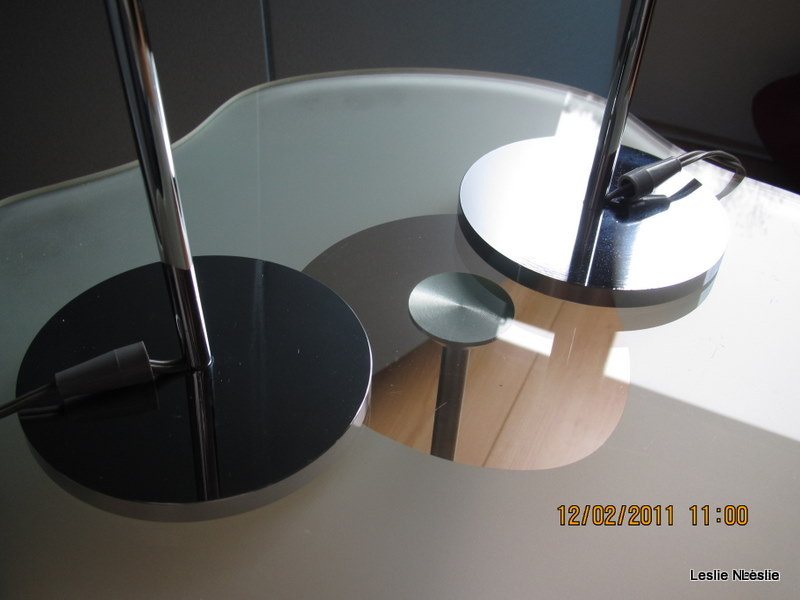

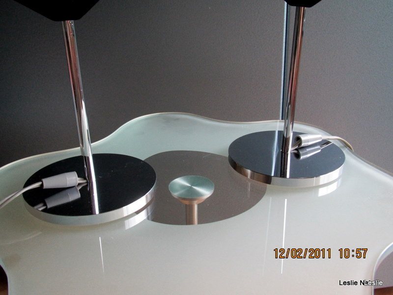

Also, where the cables enter the bottom of the stem above the stand there is a loose plastic sliding thing, looking a bit like a plug and shown in your pictures. One of my speakers has that plug, but the other one is missing having split and fallen off. I am not sure what useful purpose they serve, but are they available anywhere?
I think the plastic plug is ment for hanging the cubes on the ceiling where you first have to remove to round base?
Will check if I have one left for you...

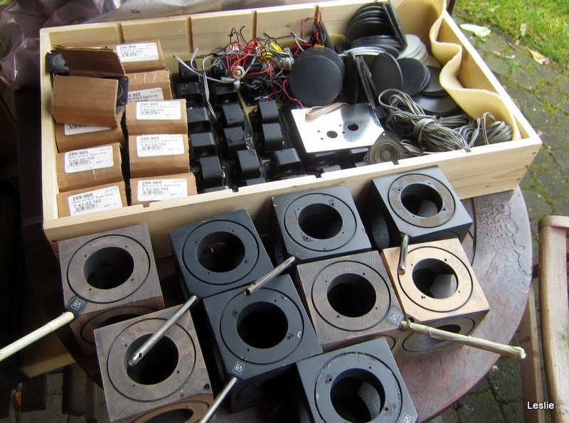

I've removed all the frets. After inspection it looks as if most have been distorted from a mild convex shape to a concave shape, presumably caused by people picking up the cubes by stretching a hand over the cube instead of lifting by the stand. Some have got a couple of dimples from touching the screw heads holding the tweeters. All fixable, and most paint chips, being near the fret rims, are probably restorable with touch-in paint rather than respraying the whole frets.
