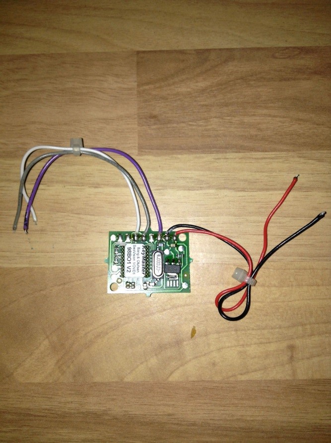

Guy replied on Fri, Jul 17 2020 8:41 AM
I found a copy of the picture of the DVD1 KeyMaster from the eBay listing when I bought mine:
And I have a pdf copy of the fitting instructions.  If anyone needs them for reference, PM me.

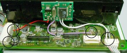

Guy
Warwickshire
Posts 2,590
Guy replied on Sun, Jul 19 2020 11:04 AM
For info - here's a photo of a fitted Keymaster.  It's a bit fuzzy as it's taken from the fitting instruction pdf.  These describe the board as the MPEG board.
