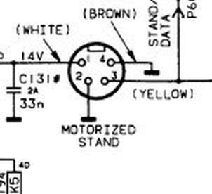

I've got a mx7000 with motorized stand, but unfortunately the 4pin connector got pulled apart from the cable during when moved. It seems to be easy to solder it back together, but I fail to find the pinout - which cable goes to which pin?

Hi,
this should help connecting the wires to the plug.
