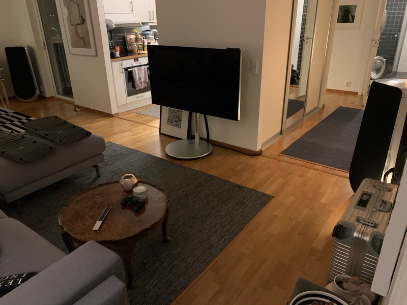

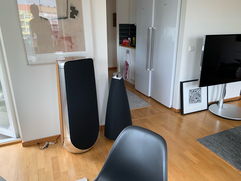

Thank you so much for your insightful and detailed answers Geoff! I was in Copenhagen yesterday for 3daysofdesign and got to see the Beogram 4002 get taken apart and put back together, amongst other things.
I haven’t been able to answer yet and will do so tomorrow hopefully. Today I got my new speakers and I am a bit unsure about how to place them.
My old Beolab 20 and 9s before that was placed like this but the left speaker was standing below the painting and not in the corner by the window door.
I wonder if I should move the 20 to that position too. I think it is a bit big and that’s why I moved it to the corner, and also to spread sound better over the dining table that is on the black/white carpet.
What is your opinions? A bit unfortunate floor lay out for speakers but this is about the only choice I have in my apartment.

Should be fine so.
However, I’d move the left one a bit away from the corner....if possible.
If you hang the painting a bit higher, the same placement as the former 20 also would be fine.

Millemissen:
Should be fine so.
If you hang the painting a bit higher, the same placement as the former 20 also would be fine. Even if - as you know - the 50’s can compensate for much, one should seek to find the best placement in regards to the main listening position in the first place. Have fun with your new speakers....you won’t regret buying them. MM There is a tv - and there is a BV.
👍 with MM on the placement
Mikipedi4 on Twitch: https://www.twitch.tv/mikipedi4
Mikipedia on Intagram: https://www.instagram.com/mikipedi4/
Old: Beosound 9000 mk3, Beolab 3's, Beovision Eclipse, Beolab 1's, Beolab 2, Beovision 10-46, Overture 2300, beolab 8000's, Beolab 4000's, Beovision avant 32" etc. etc.
Michael
Sweden
Posts 2,578
Michael replied on Fri, Sep 4 2020 9:57 PM
Millemissen:
Should be fine so.
Thank you! I think I agree. Maybe better to place where I used to have the 20.
I don’t want to make it have to compensate for boomy bass unnecessarily. Maybe I even should try and move my furniture around so I can use another wall as there isn’t a wall
Behind the right speaker for now even.
Pity real life scenarios isn’t always perfect :).
And yep the painting I can move or put higher. It looks nice with the speaker.
