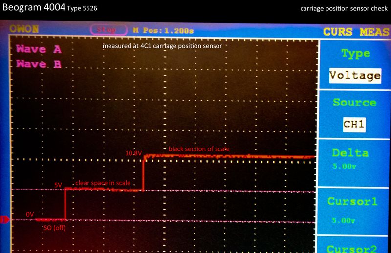

What is the voltage on the collector of 4IC1 when the black mark is over the sensor and what is the voltage when the clear part is over the sensor?

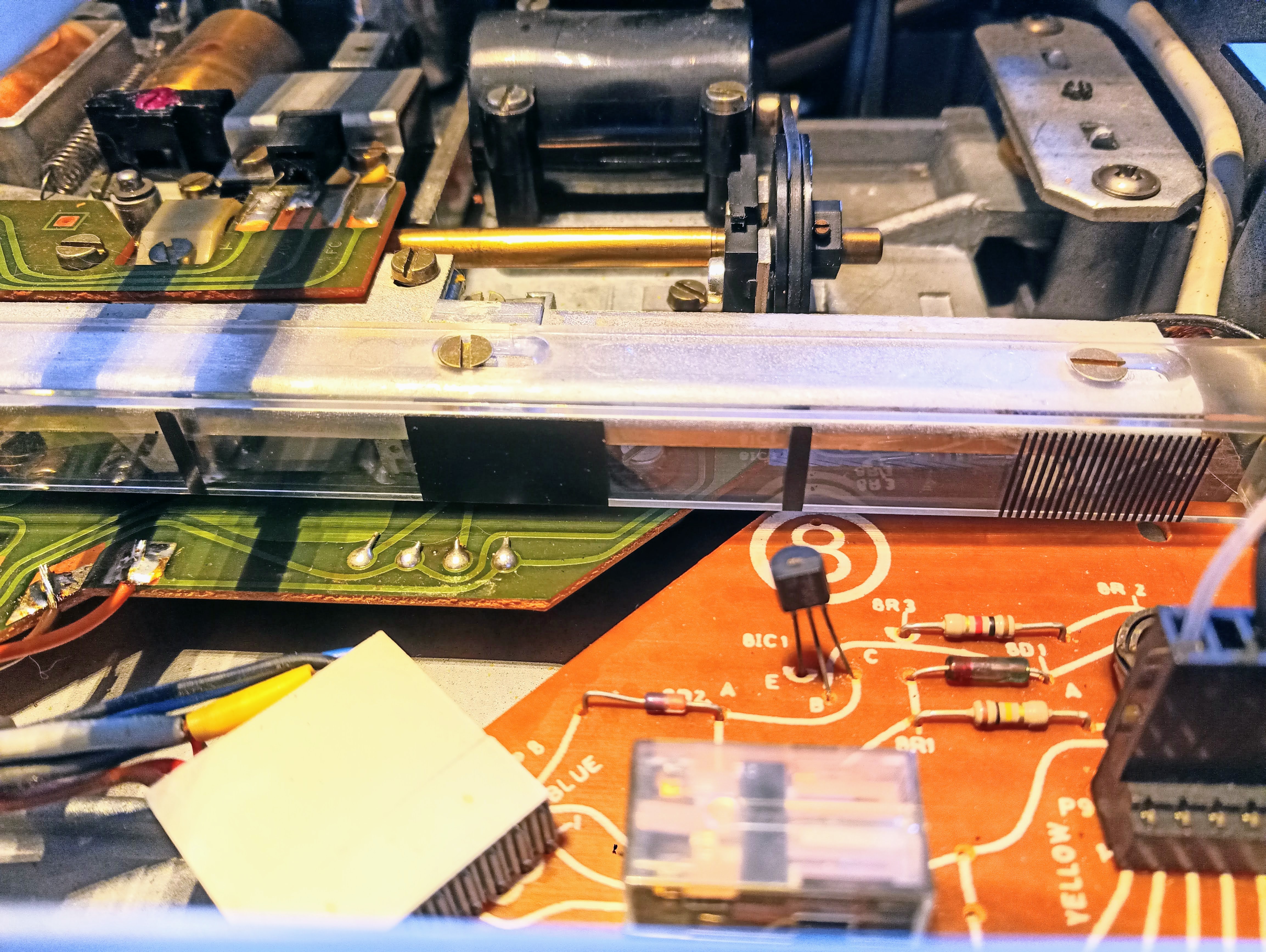

I made two photos of the bar, in my opinion this is OK. No scratches but perhaps I'm missing something here. On first glance it seems the same as the one on my other Beogram 4002. Which suddenly works 100% and doesn't do the 'scan once' misschief anymore. But based on my experience with this one I would do a revision on that one as well. But first the problematic one.
The black sensor has roughly 2mm of space between it and the ruler (scale). It would be difficult to minimise that gap and it seems to be roughly the same on my other Beo 4002.

Then it sounds like your issue is narrowed down to the position sensor and lamp. Ideally you would monitor that signal with an oscilloscope to make sure the voltages are in proper operating range and not working with voltages that are at the edge of a limit. But since your second board works in the other Beogram then that puts the sensing problem on the sensor, lamp and position scale. I would still look at how far the position scale bar is from the slit in sensor housing. Try to put it as close as possible without touching each other.

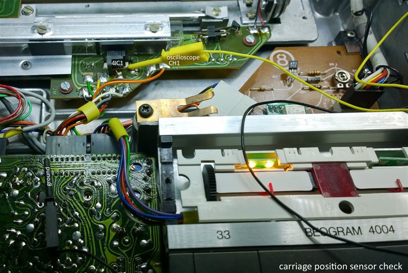

There are of course the sensor setting voltages per the service manual.

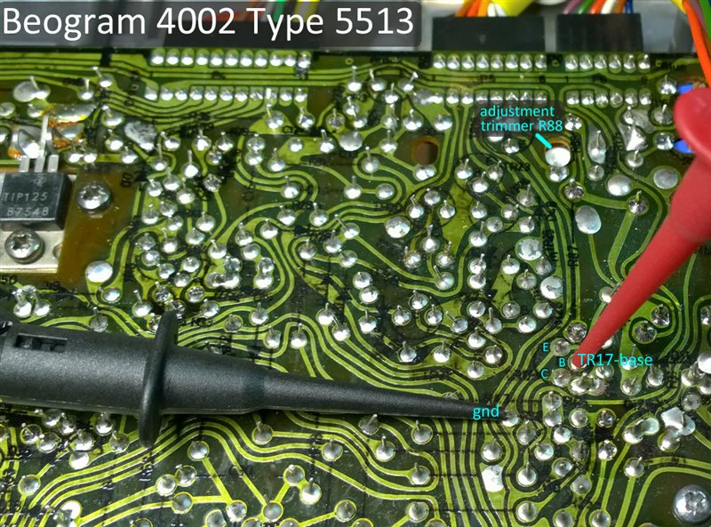

After that though, you need to see what gets picked up on the main board from that sensor.
I usually measure the collector of 1TR17 and the node of 1D41, 1R82, 1C33, 1D42 if checking the performance of the Run-Off stop signal.
If none of the functions from the position sensor board were working then I would suspect the wiring between the boards but you are seeing the 25cm position get detected. I would still be interested if the 17cm position will detect.
Since the board in question works in your other Beogram 4002 unit though I would have to suspect your position sensor and/or lamp.
It isn't producing the necessary stimulus on that narrow 30cm mark on the position scale. It waits until it gets the large marking of the 25cm position.

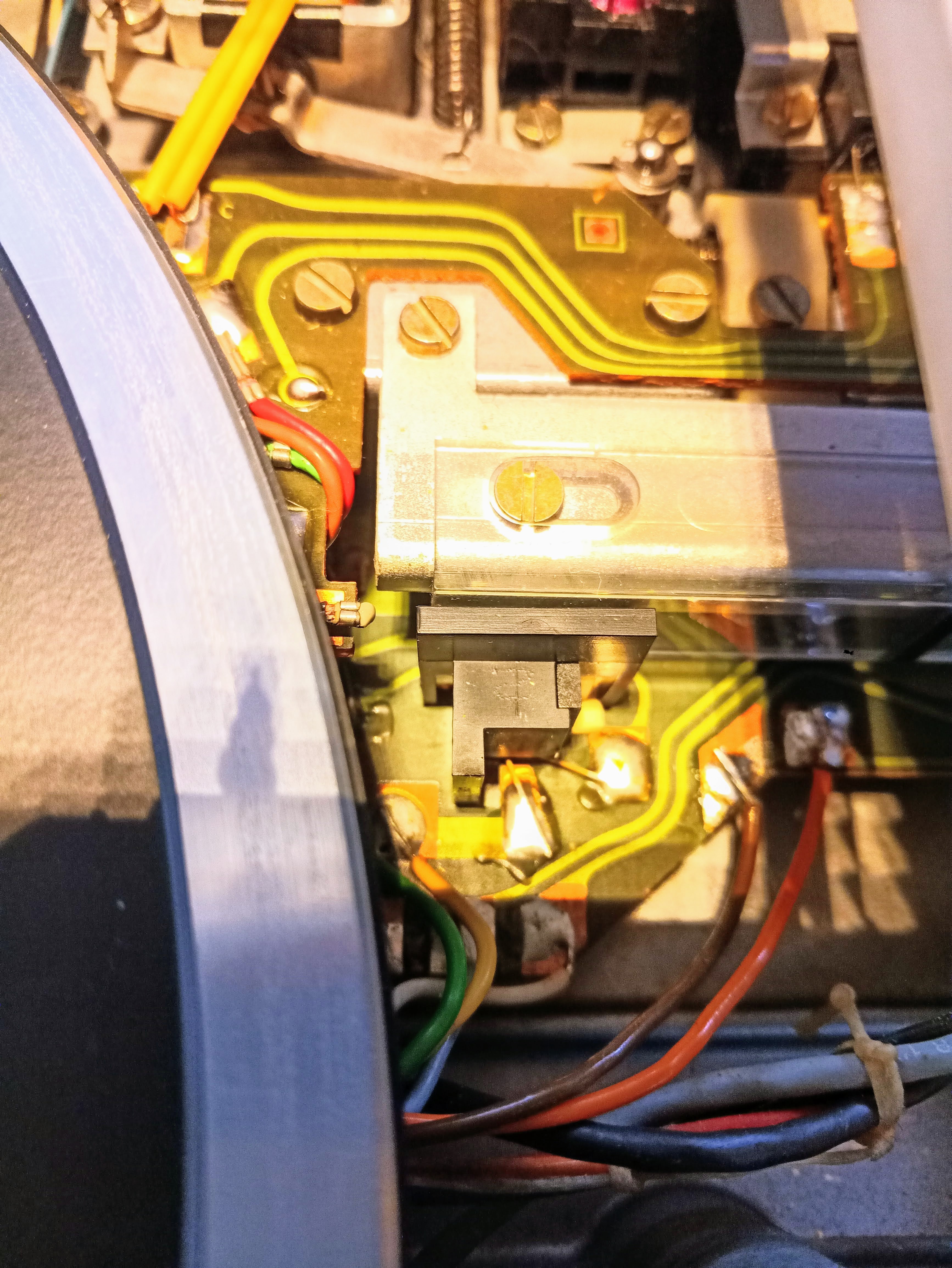

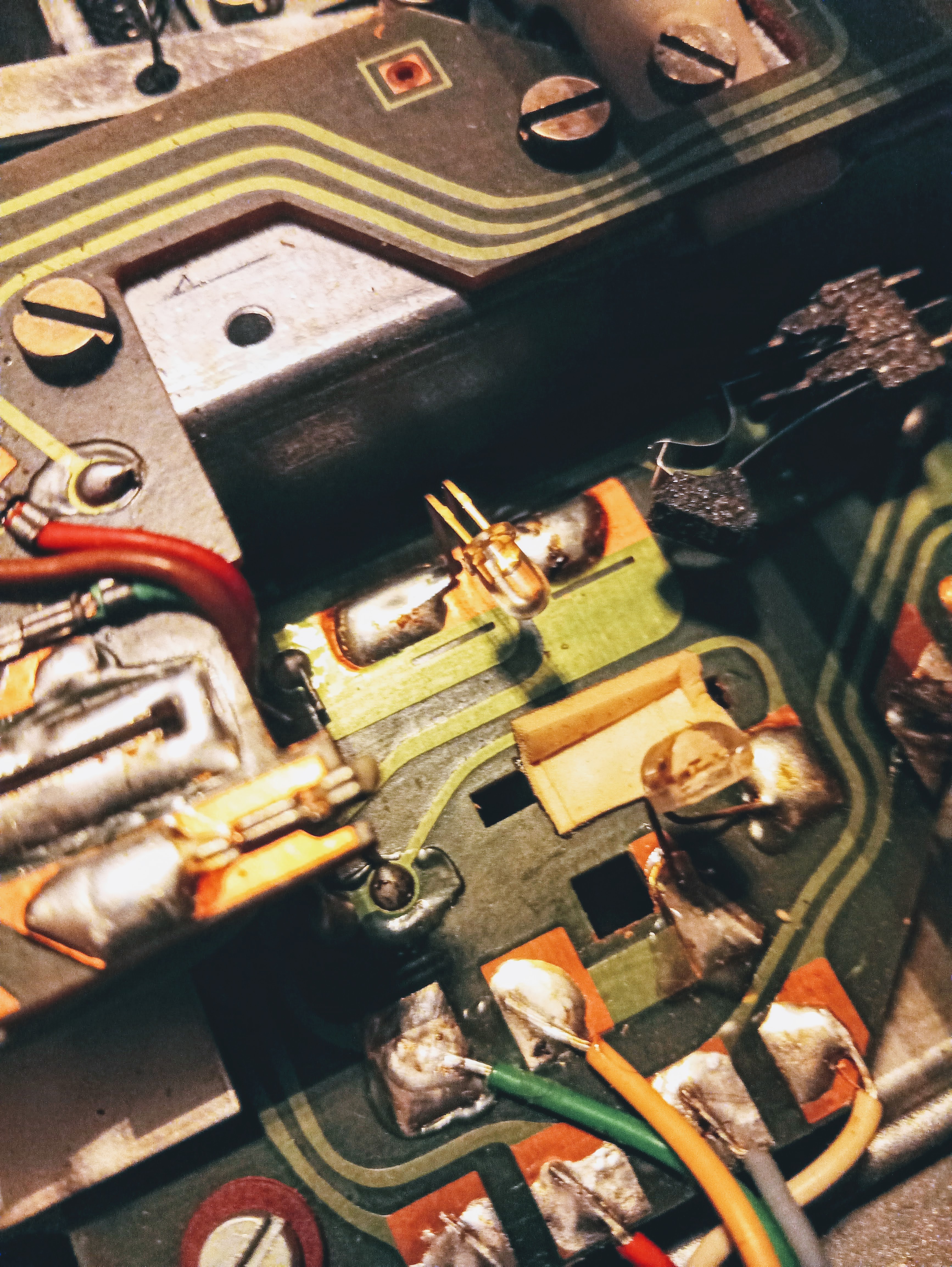

notwist replied on Tue, Sep 8 2020 10:17 PM
I have removed the housing to get a better look at the components in question. It appears to be an infrared diode and a photosensitive diode. Not entirely sure because the service manual I am using is showing different parts (lamp or led, not infrared). Perhaps I am wrong about the IR.
In the end this setup (a light source and a light 'gatherer') is really common. So the question is what components can we use to replace the old ones. If necessary of course. I can desolder them and double check some parameters.
Maybe i'm going about this the wrong way, if so then please excuse my inexperience with this machine. I fully understand that in respects to the precise workings I am way out of my league. Then again I restore and repair much more complex machinery so perhaps this is why I am simply trying to exchange the parts where the fault appears to be coming from.

The Beogram 4002 service manual hasn't changed regarding the types that have the position scale and light sensor. That adjustment procedure is the same even for the Beogram 4004.
Can you post a couple of photos of your measurement points?  Where are you connecting your DMM ground and positive probes?
I dug up a couple more photos of my position sensor adjustment measurements.
I probably confused things a bit as some of my posts I show adjusting/checking 1R88 by measuring at the base of transistor 1TR17.  On those I want to make sure 1TR17's base is at 0.7V when a clear part of the position scale is in front of the sensor. That is of course a different way than the service manual.
In these two photos I am checking per the service manual at 4IC1's collector.
I used an oscilloscope for this particular check as I wanted to observe the signal on the different scale positions.
This first photo shows where I put my probes -
This photo shows the signal (my comment in the photo referencing the measurement at 4C1 should have said 4IC1) -
-sonavor

When you are checking the position sensor at 1TR17, here is a photo of that measurement.
For that measurement you are looking for the measurement to be around 0.7V when the clear part of the position scale is in front of the sensor.
Make sure you aren't confusing the two measurement points (1TR17 base and 4IC1 collector).
-sonavor
