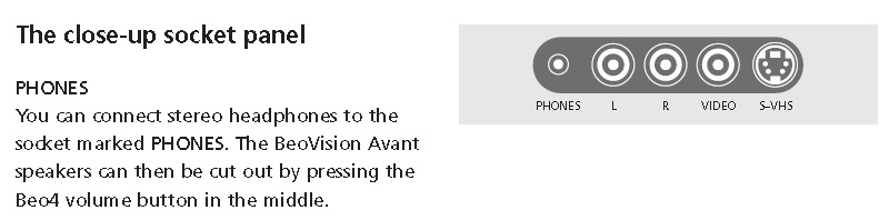

Hi,
I was wondering if you could plugged a headset to the BV Avant using a 3.5 jack. I read the manual and did not find where I could do that.
I need it because sometime the TV must me silent to other in the house, in particular when watching action movie.
Regards
Serge

Its in the closeup panel

Thanks !
At first i thought i missed something, but i forget to say it is a BV Avant 75' MK1....
andybandy
Posts 164
Hi. You need to Connect an rj45 line cable to minijack to 1 of powerlink stick.
and in the speaker setup up choose other as a speaker. Then you male a speaker group that you call headphone or something. You can make Even 2 group if you want the speaker in tv work together with the headphone. Then you control your volume on the headphone if you have a Bluetooth transmitter Connect. Avantree have some that work.
The cable can you Get from your local dealer. Its a b&o cable.
