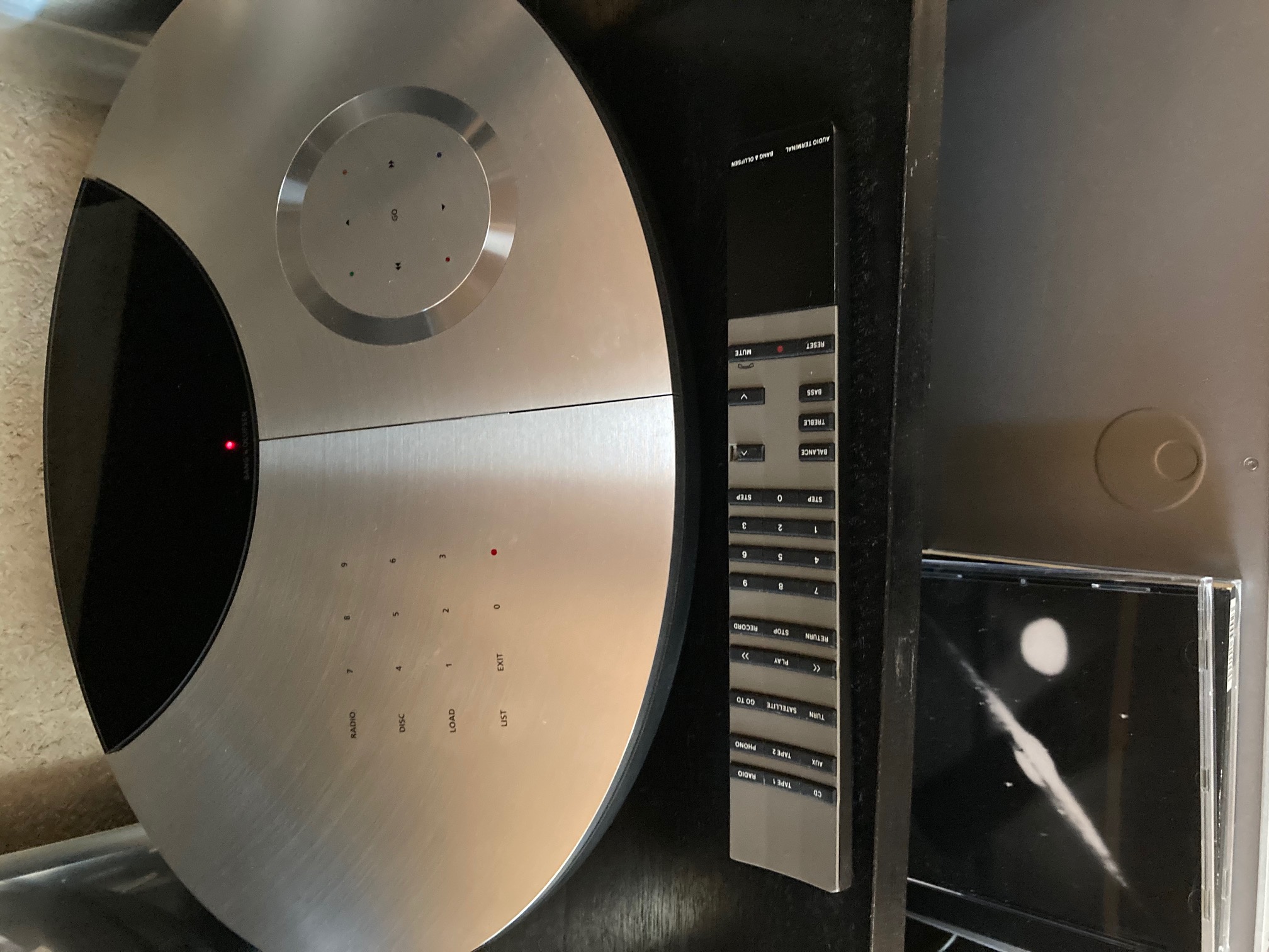

I am having a connection problem with normal B&O Audio Terminal to my Beocenter 2
That is the universal remote from B&O, the long one.
Please help!
I'm not an expert on this - but could it be that the Audio Terminal is too old for the Beocenter 2? Maybe it is only remotes like Beolink 1000 and newer that can be used with it?
The codes are the same as the BL1000, but there are a few functions missing that the BC2 may need. I was going to suggest that the BC2 could be in A.OPT 0, where it won’t respond to any IR codes, but I don’t think you can resolve this without a BL1000 or Beo4. You’d need a SOUND and STORE button.
