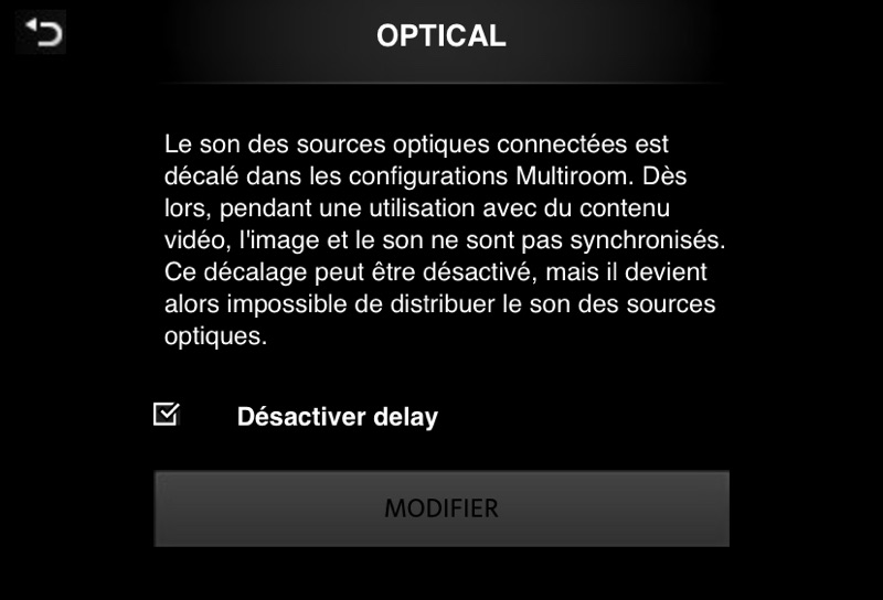

Hi All,
My Beosound core is connected to my BeoLab 8000 and is working well via wifi/bluetooth.
I have connected to my Sony TV via optical and I am having bad audiosync issues regardless of whether the media source is from the TV or an external box such as the Sky Box.
Anyone have any suggestions or solutions?

If you are referring to the image / sound sync, then you’ll have to disable the delay in the Core configuration (sound, optical or line-in) and check the delay cancellation:
Note the impact on Multiroom.

Thank you that appears to have fixed the problem!
