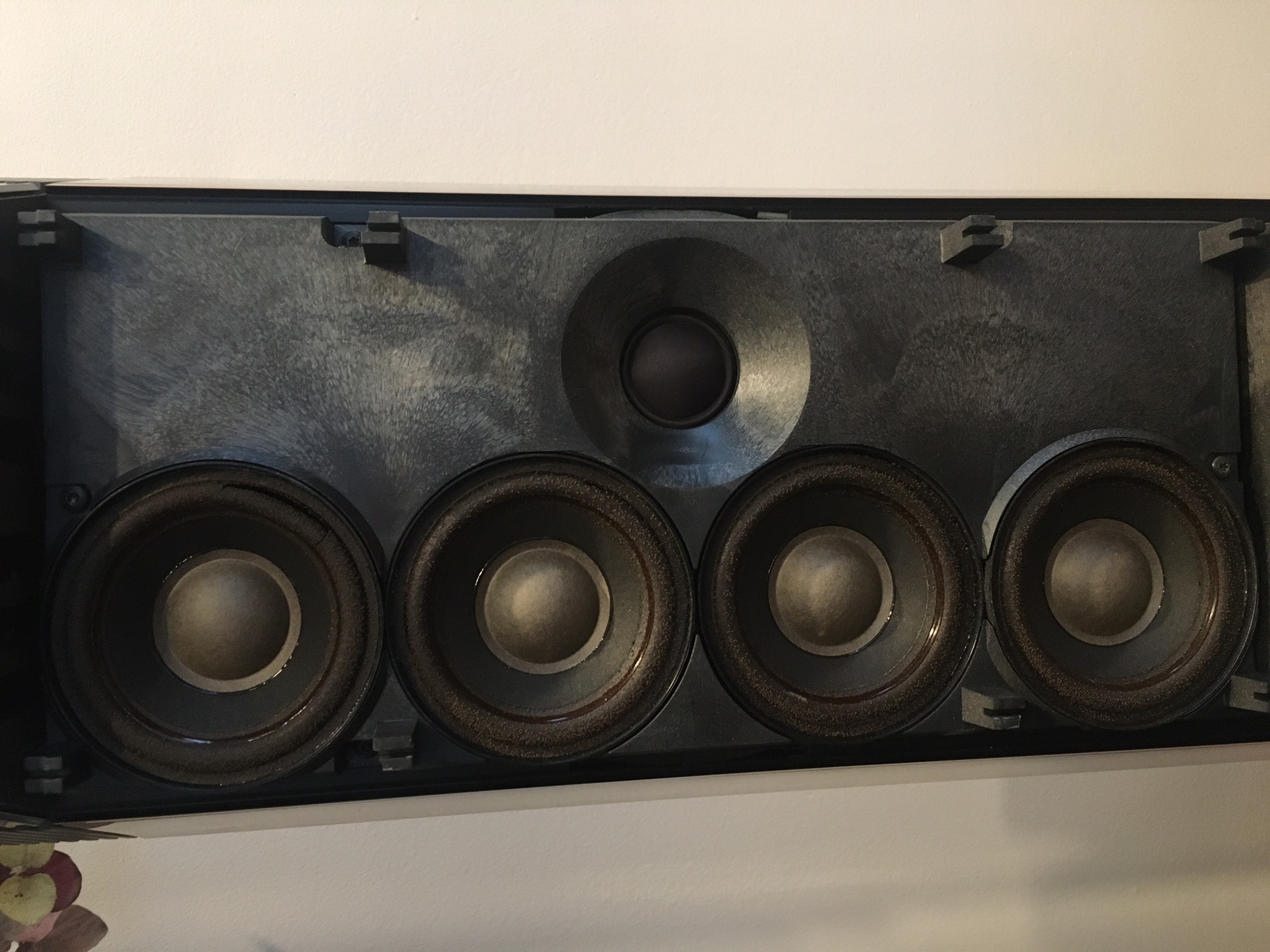

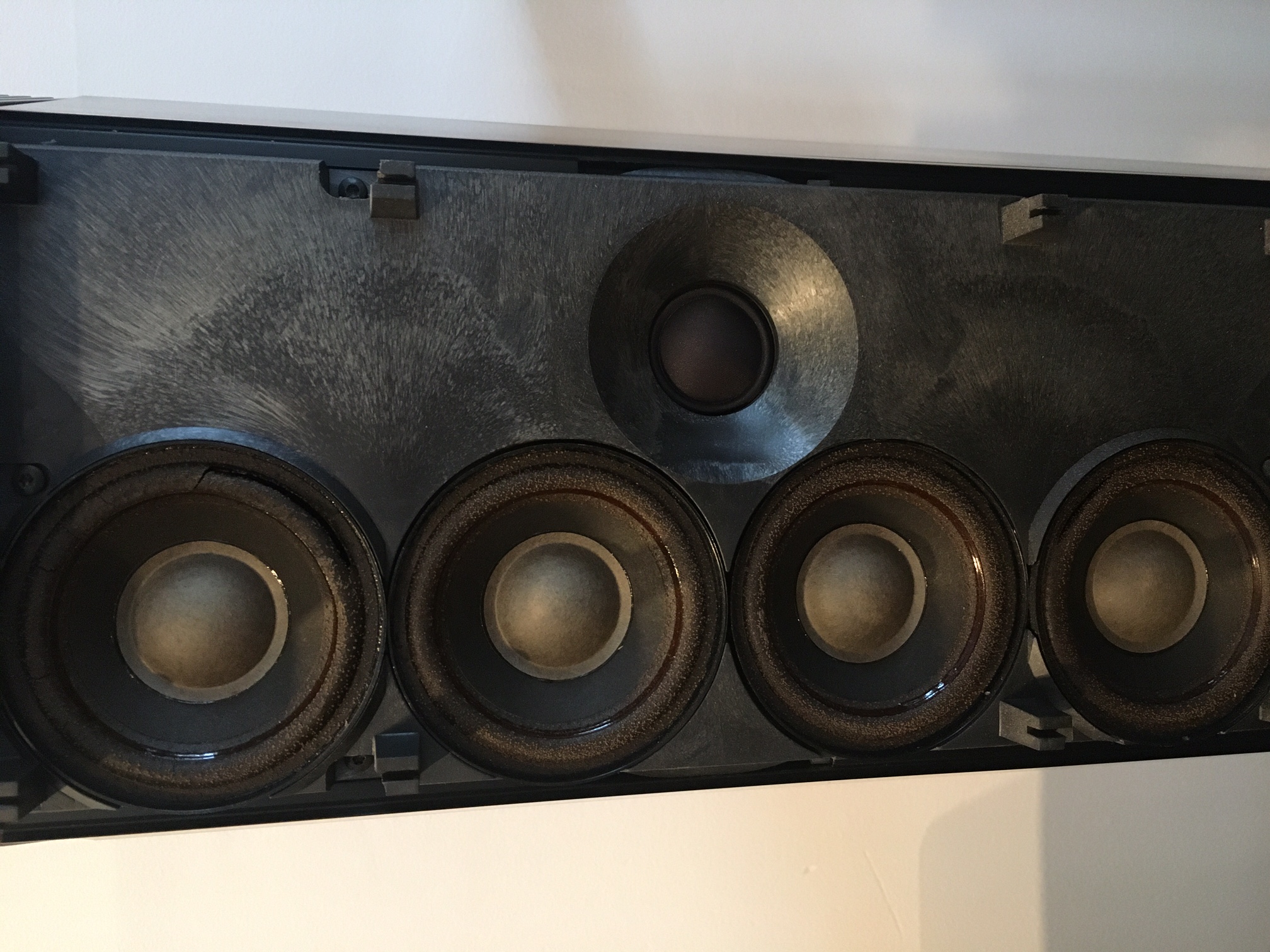

Here they are. The top ones have a small hole around four o'clock and one of the bottom ones has a small hole. The surrounds themselves don't feel sticky and are flexible. Not sure what the little "dots" are...is that foam rot? Do they look ok?
Really? Dang, I was hoping to get a bit of time out of the speakers before tackling that. Ok no worries, I knew it had to be done sooner or later. Any recommendations where to get new foams in Canada? Or do they only come from Europe? (I want the "good" ones )
BTW...thanks for all the help!

A word of caution might be in place here.
I've had the past few weeks at least 2 customers who recapped their amplifers and ended on both with blown outputstages, due to bad soldering with floating and broken traces.Totally neglected other serious issues as they weren't capable of recognizing them.
Others think they think they can refoam their mids and as result have scrapings or have resonating (around 1 khz) sounds on one or several units.
So, a bit of experience is required.
