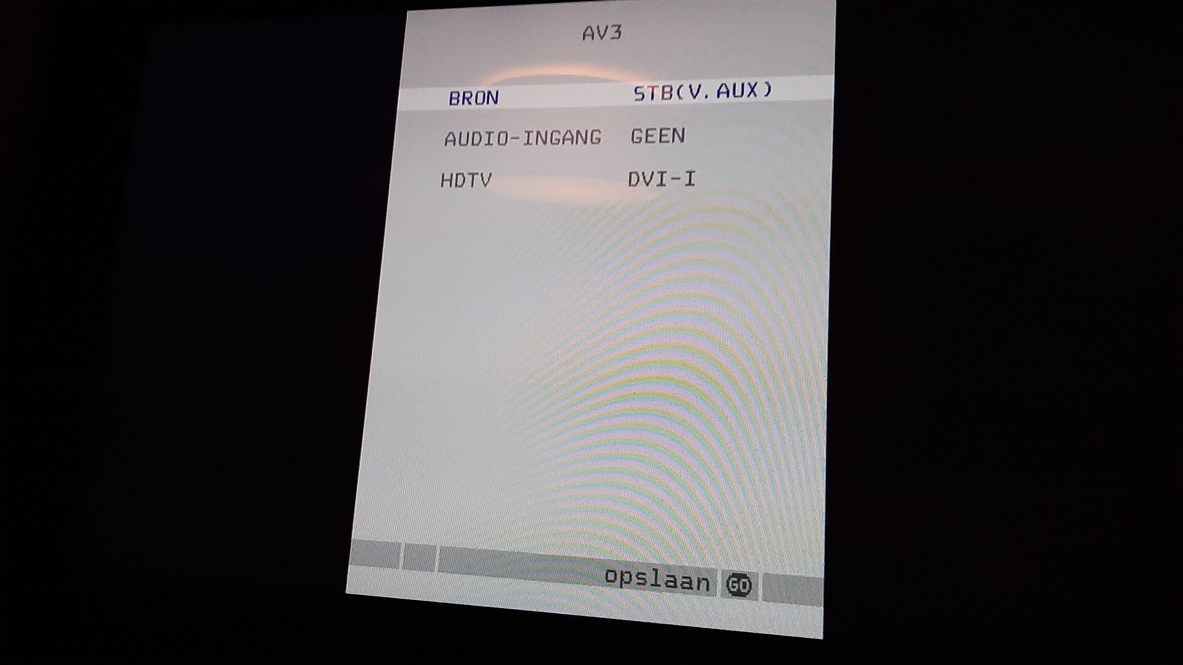

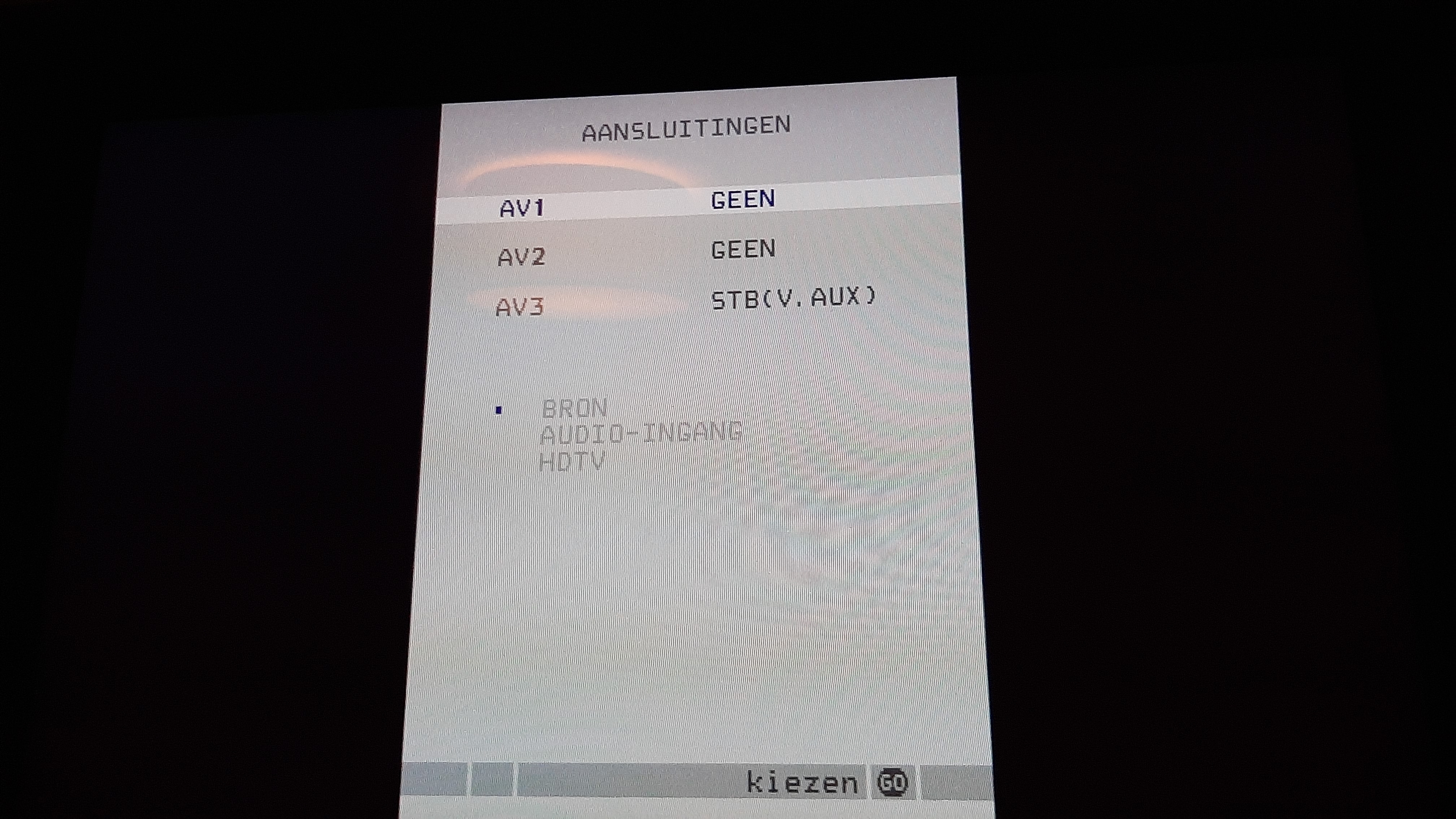

In the menu of the BC, at connections I choose AV3, there I choose STB(V.AUX). On the Beo4 you have to add V.AUX under the LIST to be able to start.

Johan replied on Wed, Mar 17 2021 7:55 PM

riis replied on Wed, Mar 17 2021 8:43 PM
Hmm, I haven’t got a set top box, so this is not an option for me.
What are your settings for AV2 and AV3?

Does “geen” mean none? My dutch is a bit rusty😀

Johan replied on Wed, Mar 17 2021 8:50 PM
I only use the BC6-26 with ATV. I have nothing under AV1 and 2. Your ATV is a set top box no? If you are not planning using PUC you can pick any STB from the list. Did you try?
Haha, yep GEEN is none Big Smile

riis replied on Wed, Mar 17 2021 9:33 PM
Yeeeeeeeees, it’s working. Picture and sound.
Thank you very much Johan for your help (and patience)
