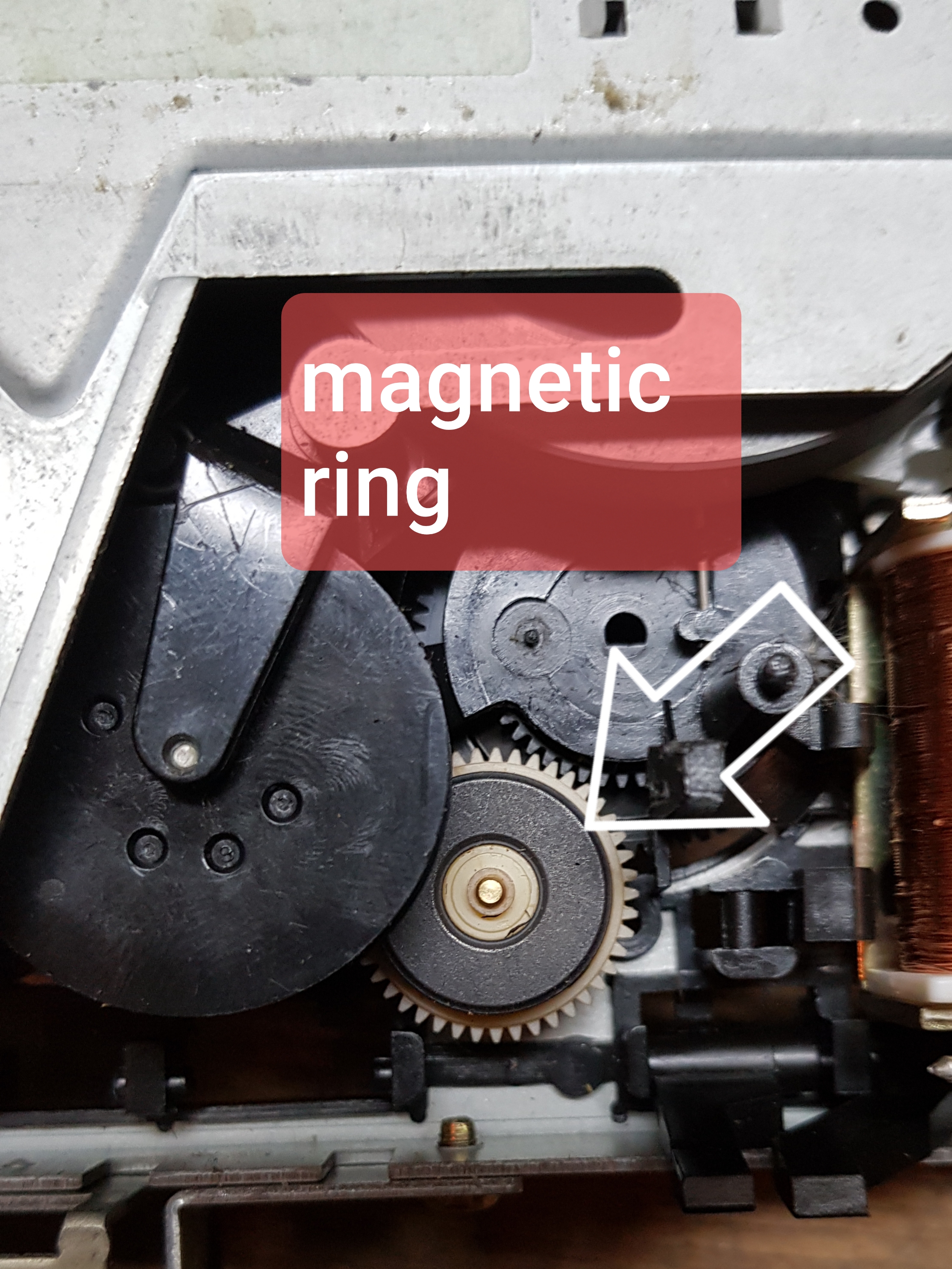

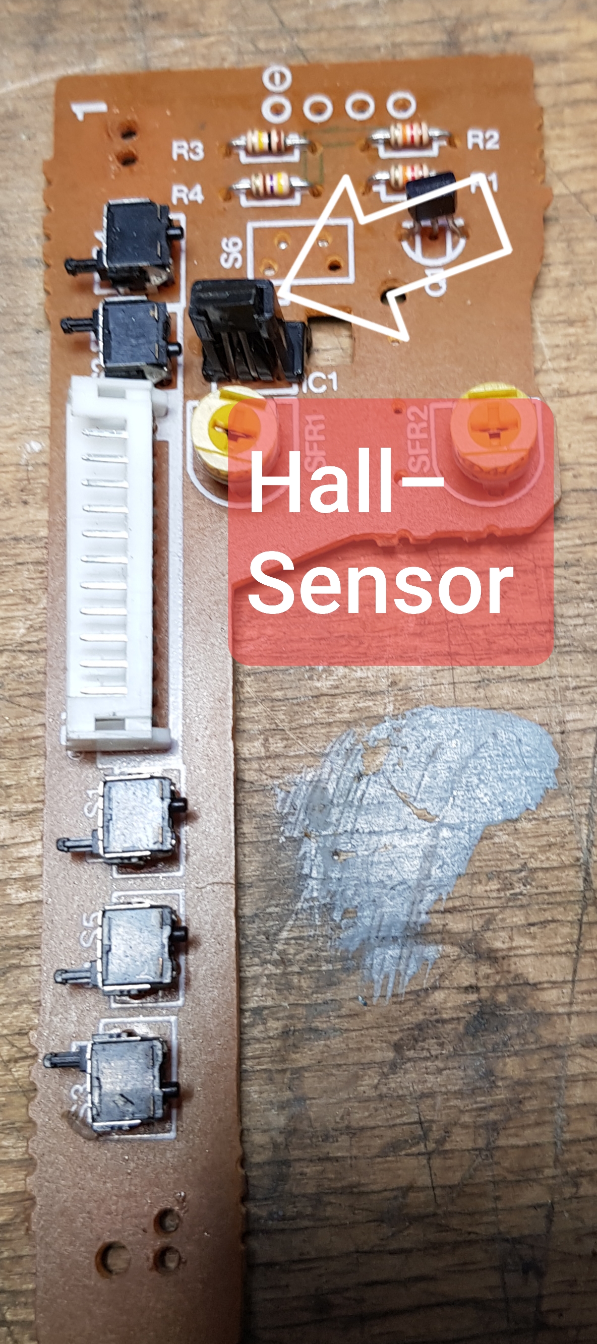

What  came into my mind last night was that there is another  Hall Sensor on the PCB which is mounted below the tapedeck.
Have a look for the wheel beneath the Hall Sensor, there is a ferrite / magnetic ring that inducts the pulses into the Sensor.

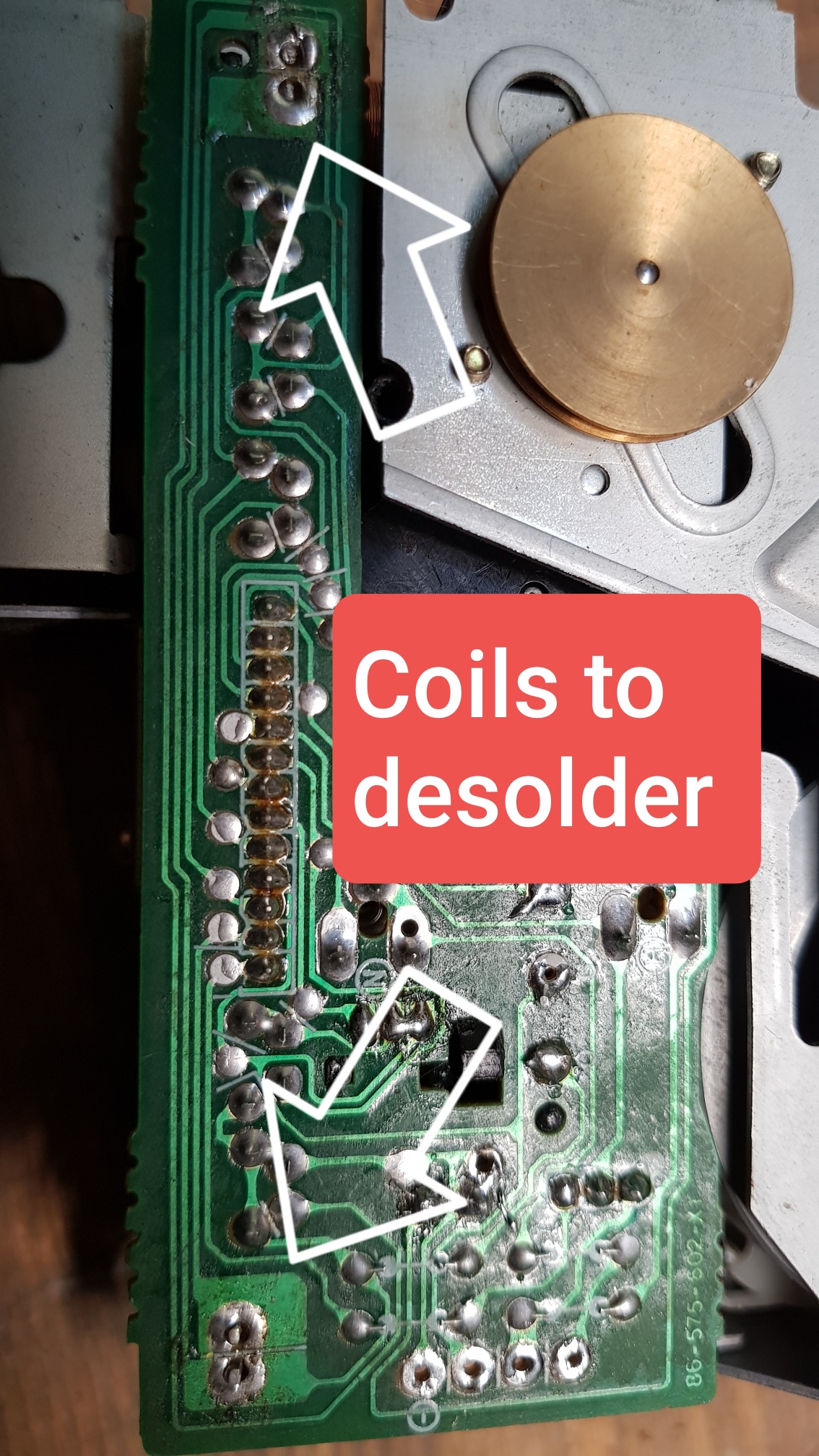

You have to desolder the two coils than you can easily lift the PCB and renew the hall sensor if necessary.
Hall Sensor
The hall sensor should stand upright to pick up the pulses like the other sensor.
I´m not quiet shur that this causes the problem but a sneak view inside could not be wrong, maybe the sensor is misaligned or one of the wires did come of the PCB while mounting and handling the tapedeck.
There is a small latch that holds the PCB it should snapped into the hole of the PCB.
