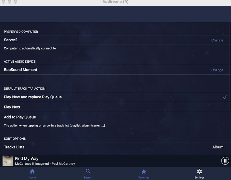

@Carpola - How can I solve this without a additional dac?
Robert_A:@Carpola - How can I solve this without a additional dac?
The same if you have a BS35, A6, M3, M5, Essence mkII, Harmony or Core (Shape)
Start Audirvana, select the speaker with "wifi" (on the right, below), set the DAC on ASIO, check the Beosound Moment, you can change the settings for streaming to the Moment by selecting ">".
Then play something on Audirvana. The Moment will start and play the chosen track.

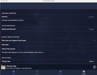

Carolpa: Robert_A:@Carpola - How can I solve this without a additional dac?For the Moment you do NOT need the proposed connection with a DAC. I just double checked it. The same if you have a BS35, A6, M3, M5, Essence mkII, Harmony or Core (Shape) Start Audirvana, select the speaker with "wifi" (on the right, below), set the DAC on ASIO, check the Beosound Moment, you can change the settings for streaming to the Moment by selecting ">". Then play something on Audirvana. The Moment will start and play the chosen track.
Audirvana must be running on your MAC/PC to controll it with the app.
the Moment is the "Active Audio Device"
"Find my way" is played on the Moment
Thanks! My problem now is that the Moment don't show up in the list of Active Audio Device.. In the list I only have MacBook Speakers. The Moment and Mac are on the same wifi...
I only have a trial on Audirvana to check that I can make it work - maybe that's the problem?
Robert_A:I only have a trial on Audirvana to check that I can make it work - maybe that's the problem?
Robert_A:My problem now is that the Moment don't show up in the list of Active Audio Device.
Audirvana in my settings show all devices.
Note: on a MAC you will not see an ASIO driver; don't bother to select something, just select the Moment if presented
The Moment won't show up, but I will keep nerding with this until I find a solution! Thank you so much for helping me out with this!
Robert_A:The Moment won't show up, but I will keep nerding with this until I find a solution! Thank you so much for helping me out with this!
turn on UPnP in your router (it should work without, but it will speed up recognize UPnP devices in your network)
try a wired test setting (main difference between your and mine setup)
