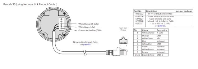

Would you by any chance have the part no of the correct ir eye just for me to make sure discussion is going into the right direction?
Thanks, Markus
Millemissen
Flensborg, Denmark
Posts 14,680
Should be same as this one
