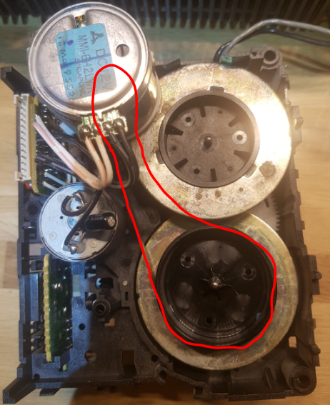

I have a problem with the century's tapedeck.
When i press "play" cabestans are rolling but not the heads.
If i try to press "forward" or " back" i can hear the motor, cabestans are rolling but heads aren't.
I thought it could be the belt so i changed it but the problem is still the same.
I had a look at the gear "orange wheel". I can move it freely from right to left with my finger and there's no broken teeth.
But when i press "platy" it seems that this wheel doesn't move.
Any idea please ?

Hi,
The belt needs to be correct type, if your in doubt contact Dillen.
You also need to be sure about the correct path as:
/Pindsen
