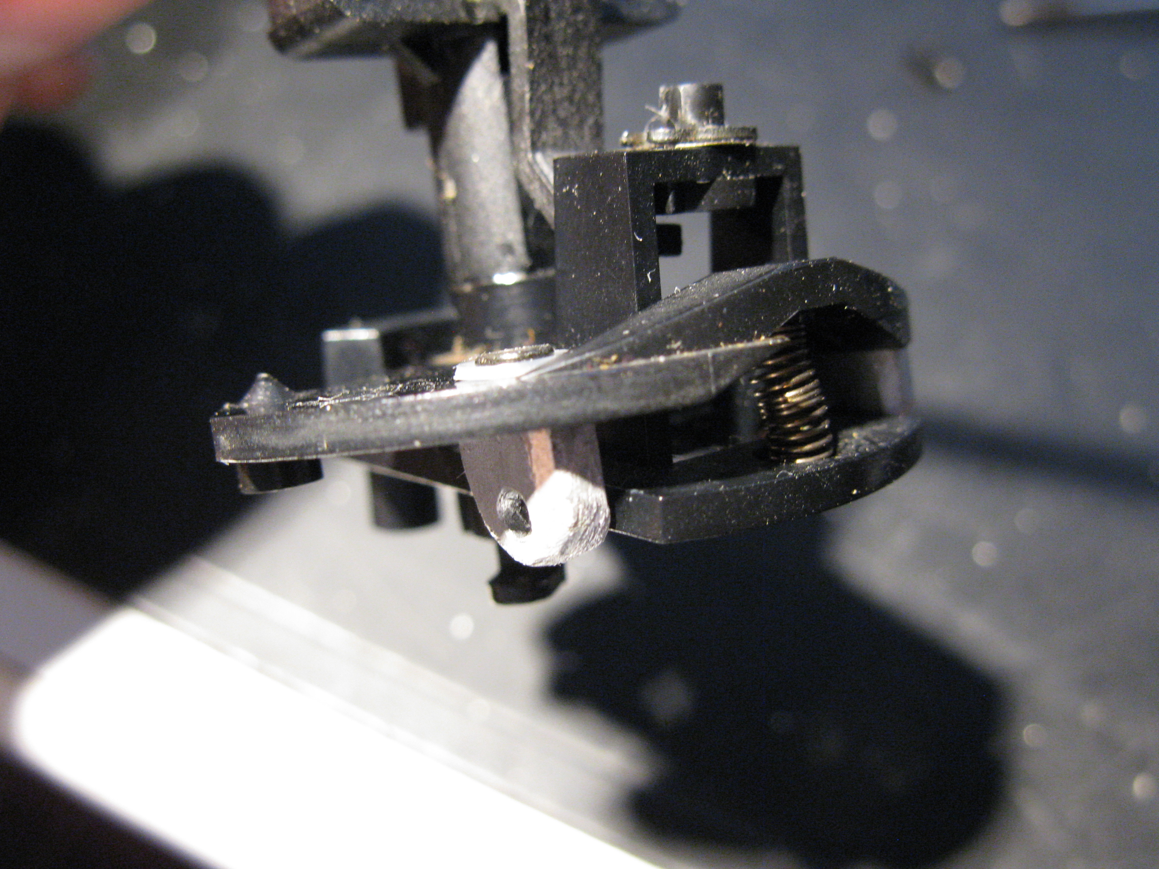

My tonearm wont go down properly to reach the record.

Most likely the lifting mechanism has broken at the tonearm base.It's quite common.
Martin
Any way to fix this or is this a lost cause?
Is it broken?
I can't really tell if it's broken or not. I have no idea what to look for.
There is obviously something wrong. But then I Have to take it apart to see I think
Al I can say is that before it was in this state, maybe a couple hours before the picture, i probably bumped into it and now it won't get any lower than You see above.

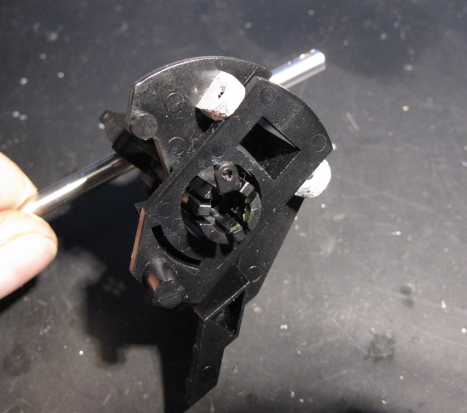

You may have to disassemble the tonearm. I've had both broken hinges, which I replaced with some aluminium. It works quite well.
It seems like the part you described is also 'wack' on my end. No idea how I would fix this though.
seesalt: No idea how I would fix this though.
How about the idea you were just given above?
