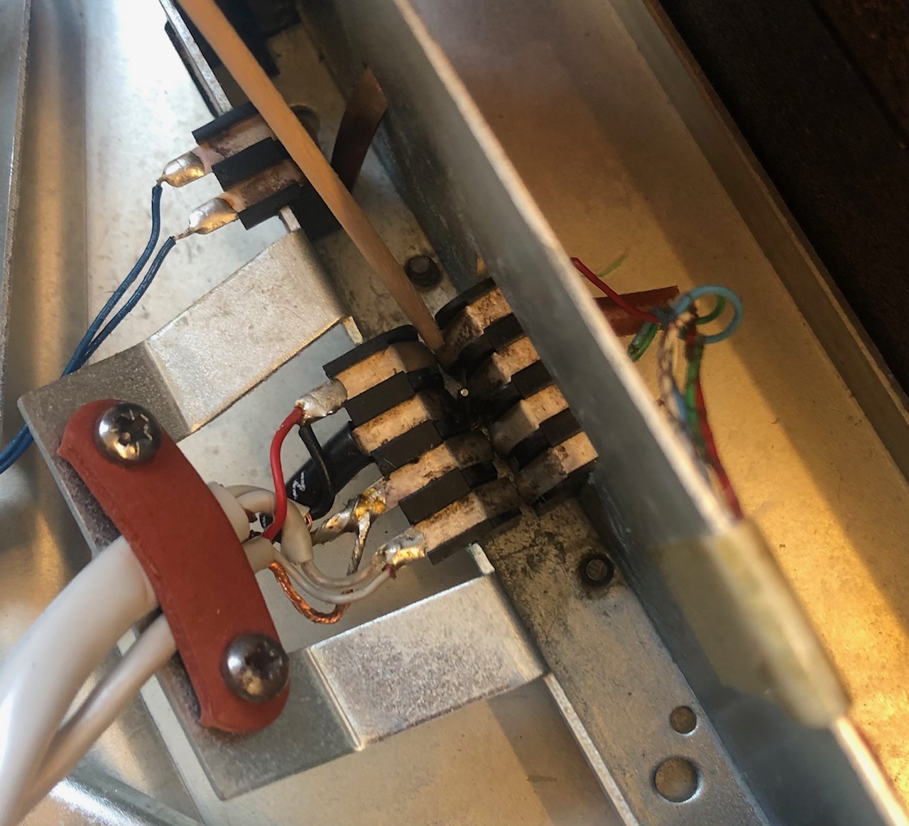

Ok, so I fixed the dead right channel issue. The pass through connection at the pre amp socket was broken, bent it a little and voila. See picture below, it's the one where the cotton bud stick is pointing.

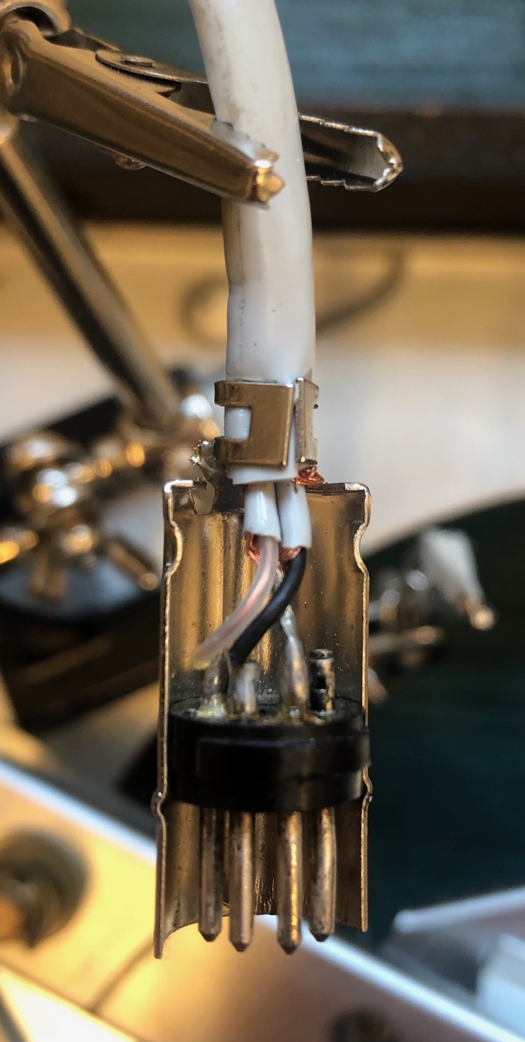

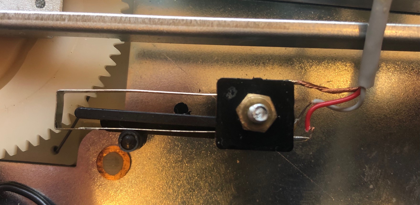

The pins a the muting switch all have contact so I'm thinking there's supposed to be short somewhere which is not there. Pics of the mute switch and DIN plug below.
Any input is greatly appreciated.
Peter
Mark
San Francisco
Posts 107
Mark replied on Thu, Sep 23 2021 11:08 PM
You’re going to have to attack this with an Ohm meter, as simply having physical contact does not guarantee electrical continuity. You should be able to measure ~800 ohms unmuted and a short muted. If the contacts of the mute switch aren’t shorting hot to ground, they should be cleaned with a burnishing tool or equivalent.
Peter8300
Denmark
Posts 65
Peter8300 replied on Fri, Sep 24 2021 11:43 AM
Thanks Mark,
I'm not very experienced in using an Ohm meter and reading diagrams but I got it fixed nevertheless. I cleaned the contacts of the mute switch with grain 400 paper and bent them a little and that fixed the issue.
