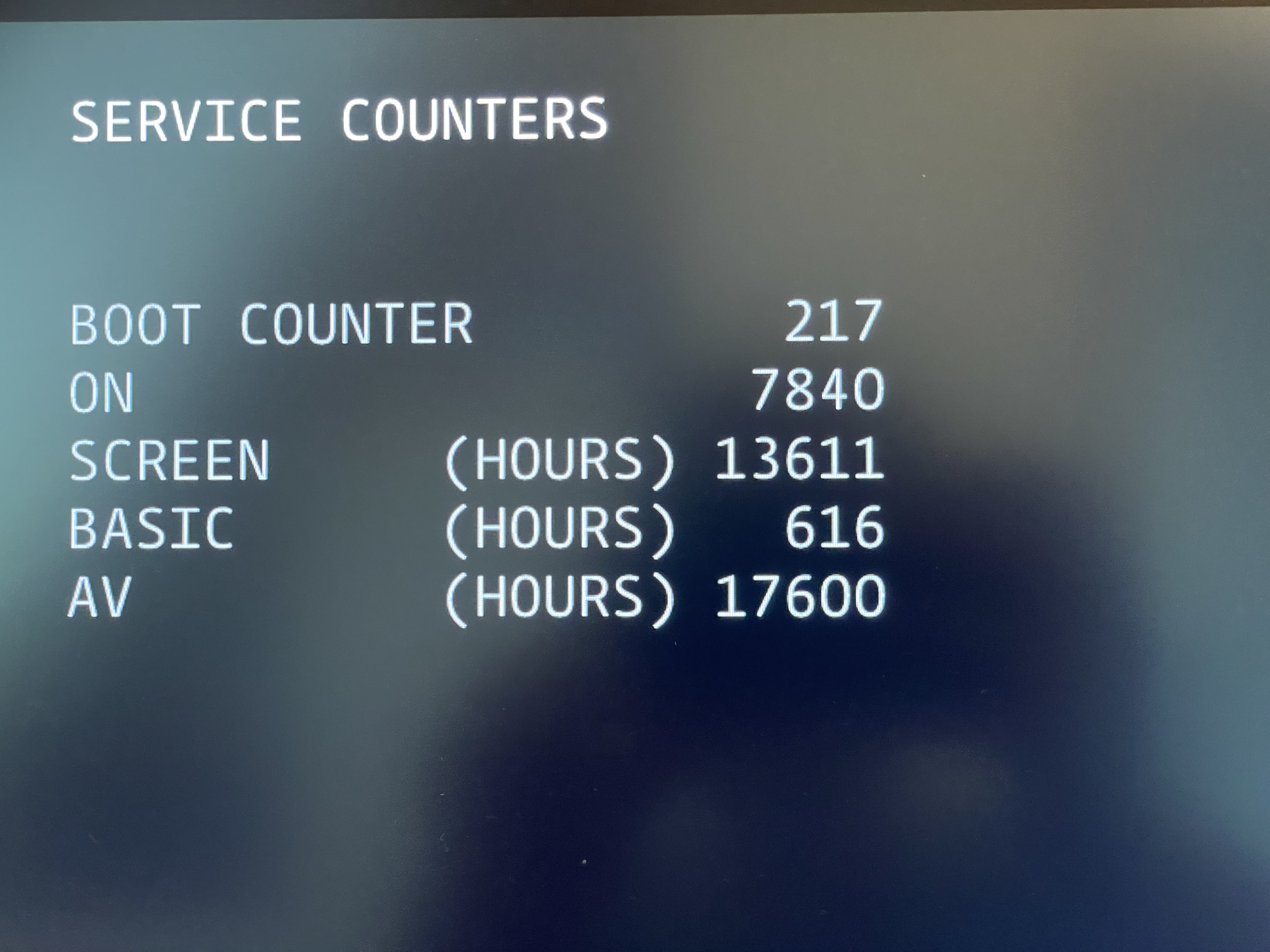

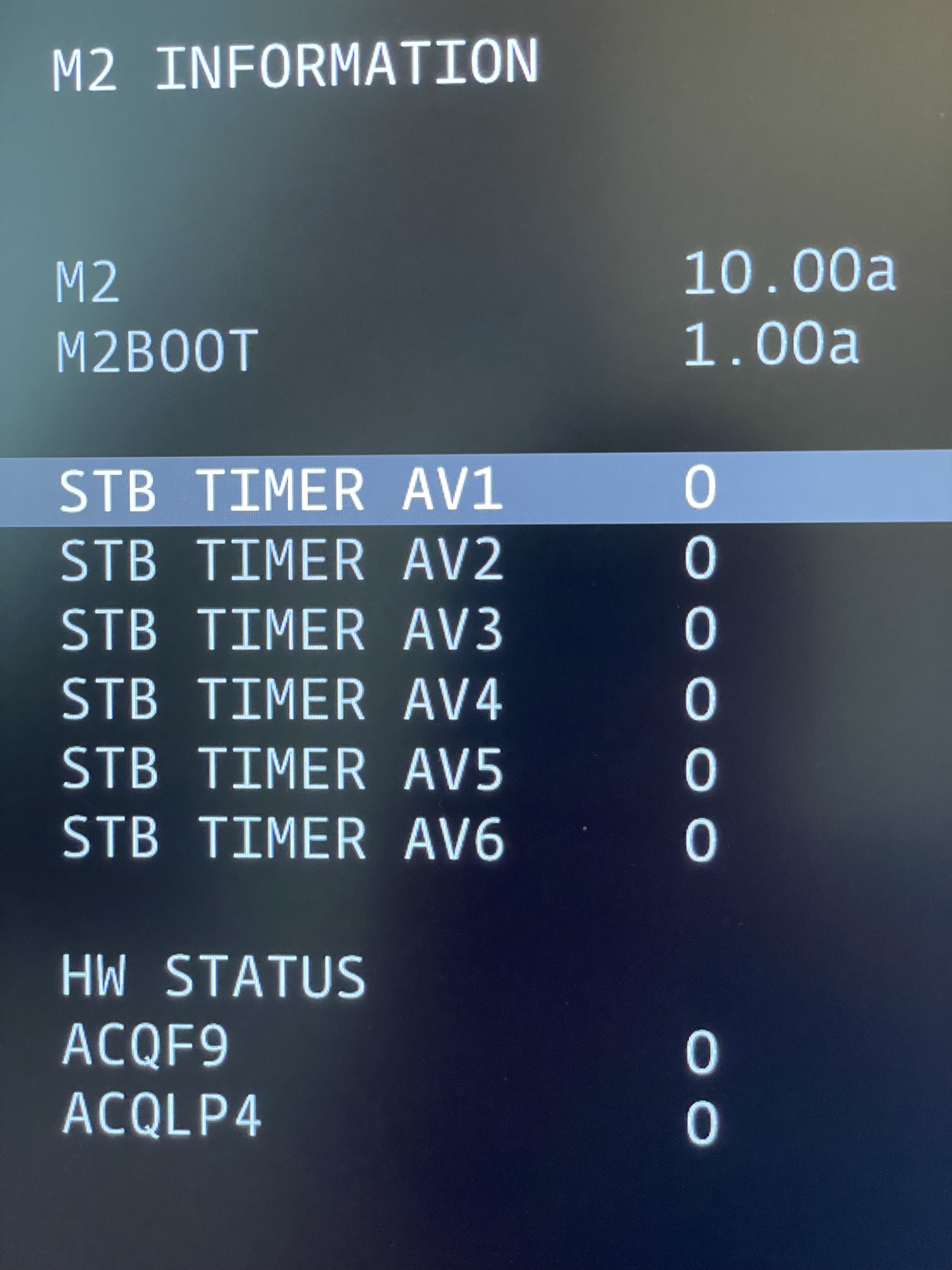

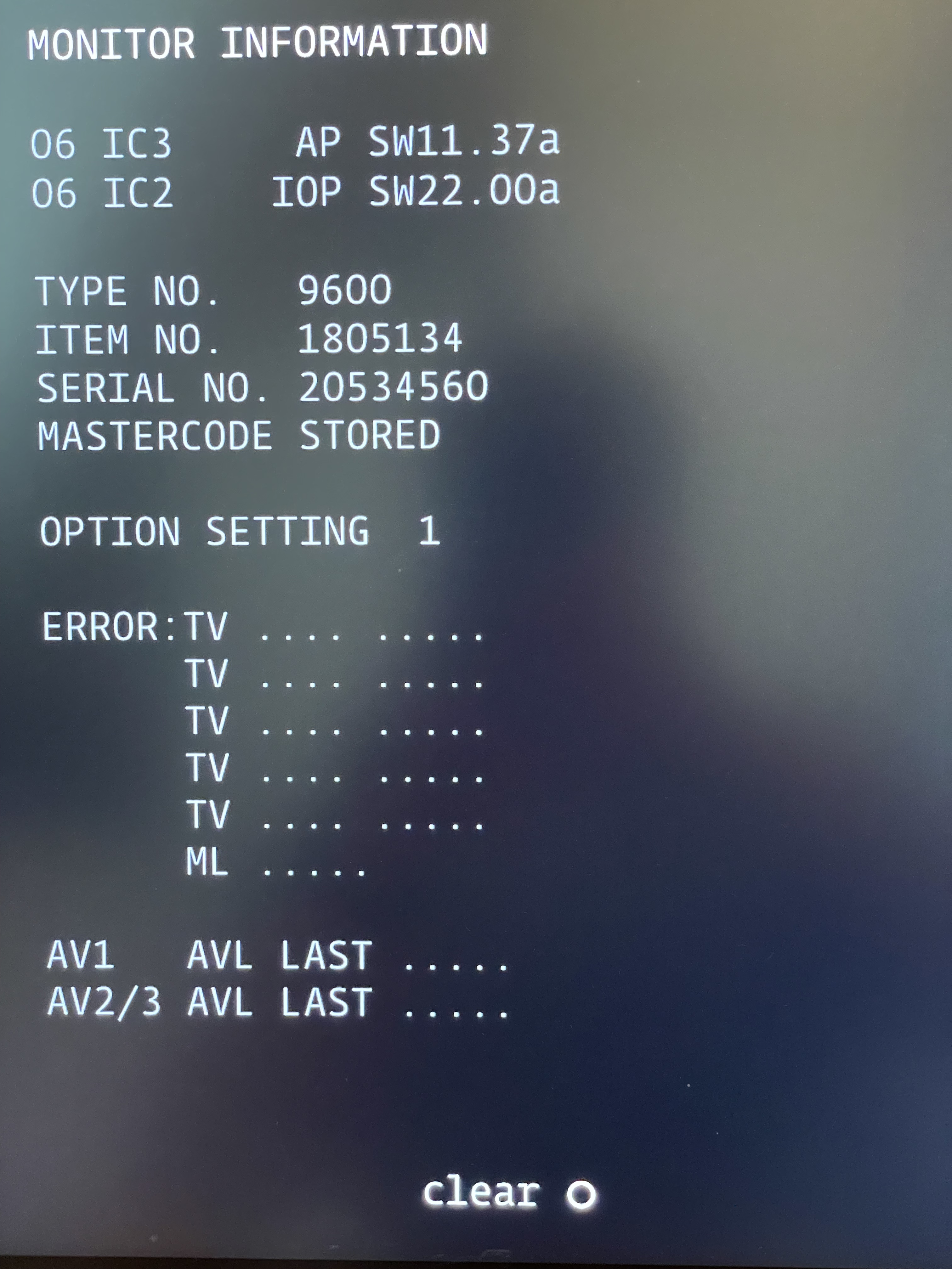

Attached are some system Information shots of the BeoSystem 3. Is there a Service Manual availible in the paid section of Beoworld?
