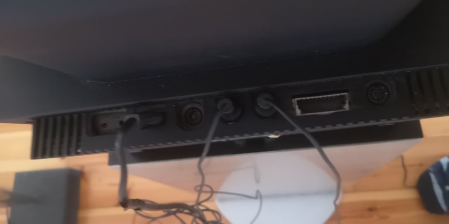

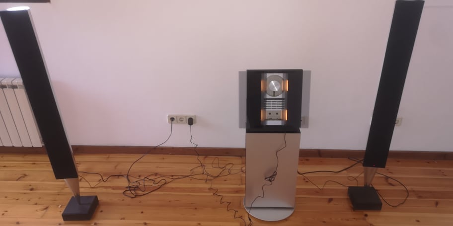

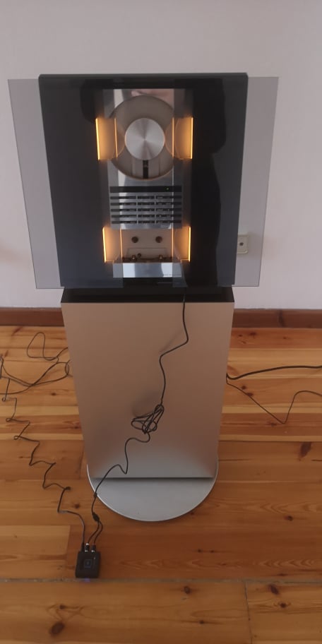

I have what I think is 2 Beolab 8000 speakers, alongside a Beosound 3200 (please see pictures attached to confirm).
I am looking to connect to them wirelessly and would love to have some advice because I don't think I understand anything. I have bought a Bluetooth adapter, please see here-
https://www.amazon.es/Adaptador-Bluetooth-transmitir-inal%C3%A1mbrico-inteligentes/dp/B01CZVCYU0
I cannot get it to work, I am plugging in the AUX to the Beosound 3200 just below the tape section, and the RCA cable to the bluetooth adapter. When I play a song on my phone whilst connected via bluetooth, nothing plays from the speakers and they remain with their red light.
I have clicked on the AUX button on the speakers and still nothing works.
Also, I really care about sound quality so if at all possible I would love to know if this setup is good for sound quality. If not, how do I maximise sound quality? I have android and my girlfriend iOS, and we also have 2 alexas if they help at all.
I'm so sorry that I don't understand anything. Any help would be really appreciated thanks.

H n lcome to the Beoworld forum.
No wonder you hear no sound!
You have plugged the bluetooth receiver in to the headphone out of the Beosound.
You need to look for the input called AUX on the back, just beside where you have plugged in the powerlink cables for the speakers.
For this you will need an adapter: minijack to 5 pin DIN.
As for sound quality - I do not know that particular bt receiver.
However, in general bluetooth streaming isn’t the best way to do it…..you will have to test out the result, once properly connected. Maybe it is ok for you.
Since you use iOS as well as Android, the better way would be to cast (chromecast). If you could get hold on one of the now discontinued Chromecast Audio dongles, it would be better soundwise (assuming your wifi in the house is stable).
By the way - the Beosound is not a 3200, but a 2500.

Hi bonoboworld,
Welcome to Beoworld!
As MM mentioned, please use the 7 pin Aux socket on the back of the Beosound to connect the Bluetooth receiver, not the headphone socket.  You need this cable:-
https://soundsheavenly.com/bang-olufsen/52-72-stereo-rca-twin-phono-to-beosound-aux-input-din-socket.html#/2-length-1m
Please set the phone volume to maximum when connecting to the B&O system – this is normal when using a portable music player with a home audio system due to the low output levels produced by the phone.
To listen to the music, simply press "A.Aux" on the B&O keypad, or select this on the B&O remote control by pressing the "LIST" button until the display shows "A.AUX", then pressing "GO".
Kind regards, Steve.

bonoboworld
Posts 4
Hi,
Thank you so much, I have got it to work now! Sorry for being so stupid haha.
