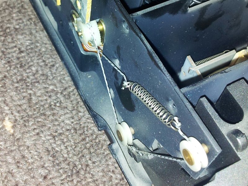

Photo required for panel cord Beomaster 5000
This post has 2 Replies | 1 Follower
zaentzpantz
Posts 6
zaentzpantz Posted: Tue, Feb 26 2013 4:04 PM
The spring and cord on the Beomaster 5000 I'm working on are both wrong. The mechanism operates  a small rotary damper and slows down the opening of the narrow control panel that flips down.
The spring is elongated and the threading appears to be wrong. Unfortunately the service manual does not show any details for the correct threading and position of the spring, so would anyone have a photo or diagram of the correct assembly of this?
james
scotland
Posts 13
james replied on Wed, Mar 13 2013 11:33 PM
zaentzpantz
Posts 6
Many thanks, just what I needed!
