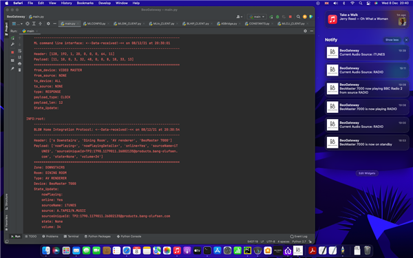

Hi all,
In case anyone is interested, I've uploaded an updated version to Github today. It allows direct control of apple music from the N.Music source, as well as reporting of the system state in the Notification Centre. Obviously this means it is a Mac only program.
I've tested it with my BLGW and my old MLGW and it works with all 4 B&O monitoring protocols at least for all use cases of my system (which includes ML and NL devices). Next step is packaging it up as a plugin for the Indigo home automation software.
Screenshot attached
