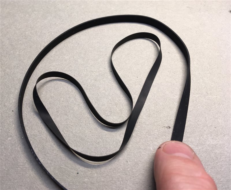

Hi,
No they were real square belts made in Portugal (?) bought in UK. Still for sale by the way.
I bought them only because you didn’t stock them, out of despair Stick out tongue
Jacques
Dillen
Copenhagen / Denmark
Posts 13,191
Dillen replied on Sun, Feb 16 2020 9:46 AM
chartz:
Hi Martin,
They were definitely not o-rings, but just bad quality belts, probably a little loose?
I wonder how such sellers (I contacted him before buying) can have such positive evaluations. Whistle
You only have 60 days to leave feedback on Ebay. If the purchased item holds on for that long the seller is in the clear.
And did you say Portugal? Now, where did I hear about this before...? Geeked

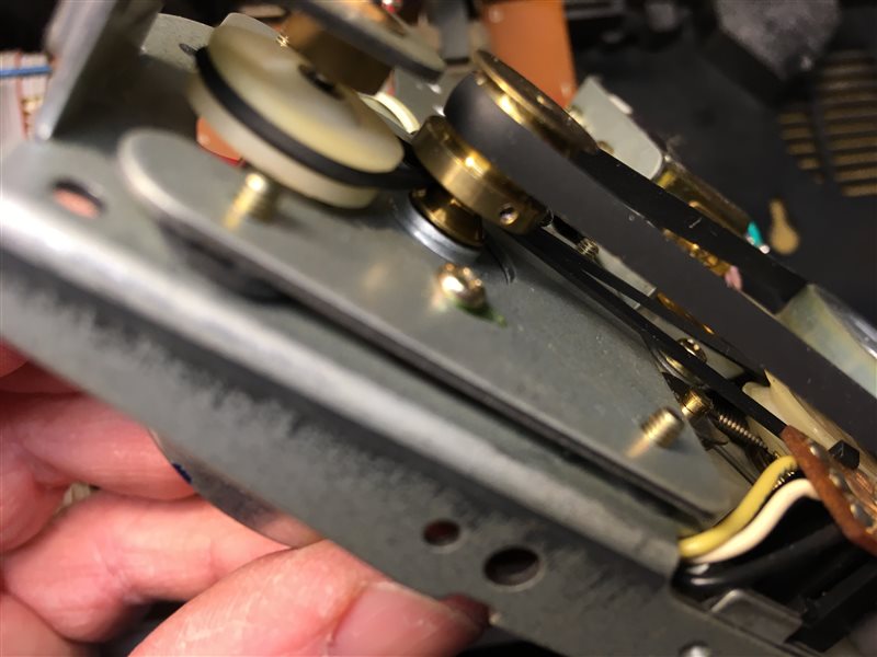

Beocord 2000
This one arrived with a note stating "Huge wow".
I tested it and had to agree. Huge wow indeed.
Near tape ends it could hardly pull the tape - but I could hear the motor run.
I opened up the Beocord and had a look inside. This is where it became clear to me, that this
was going to be one more belt story.
The capstan belt was huge. And not only was it huge, it was also quite stiff.
Actually, it was so stiff that it didn't hug the barrel shaped motor pulley correctly, - it merely
sat on the widest section of the pulley, completely flat, only touching the pulley along the center of the belt,
which over a period of about a year had worn completely shiny and smooth with no friction left whatsoever.
In this photo I think you can tell, that the belt doesn't touch the motor pulley at its sides, only at its center.
Laying it on a piece of cardboard the belt was so rigid I had to press it down with a finger to make it lay flat.
The other belt is the real thing, note how flexible and agile it is. Completely different.

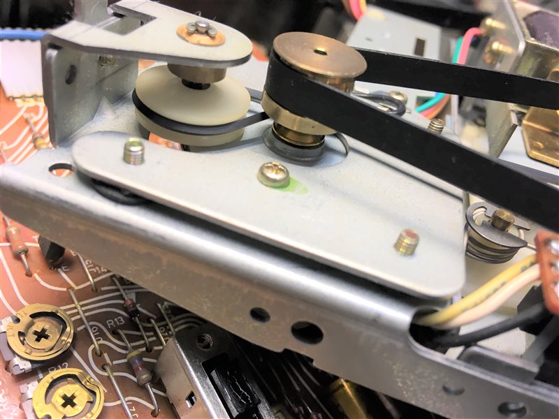

The new belt was fitted.
Note how it embraces the pulley and adapts to its shape for full contact.
The other two belts got replaced too, and a couple of known troublemaker capacitors in the Dolby circuit was
attended to as well.
Fresh idler wheel and reel table rubber parts were fitted for good measure.
It played along for a couple of hours and back it went.
