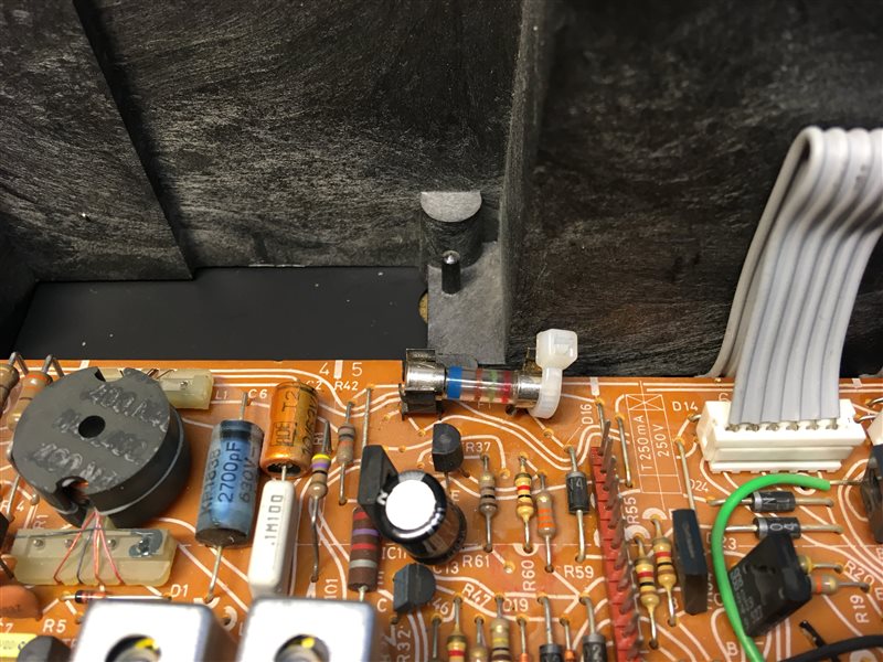

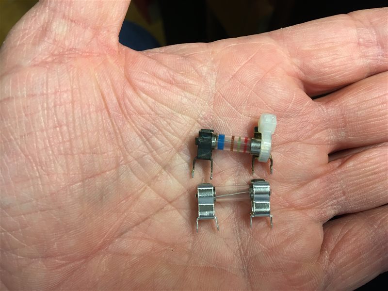

Speaking of the odd DIY-job;
This Beocord 9000 arrived here with intermittent problems.
New fuse and holders.
Martin

sonavor replied on Tue, Feb 11 2020 1:41 PM
Just when you think you have seen it all...
John
W.Frankenberg / Gandalf
Heilbronn / Germany
Posts 290
Laughing... lol. ... ... not nice but pragmatic if no spare part is currently available ... no permanent solution! Crying
