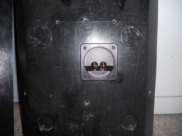

I've added some pictures to my opening post to make my wall of text a bit more interesting.
A bit small due to forum rescaling, but they do show some of the issues like corrosion on the steel (easy fix) and the strange stain on the Beocord aluminium that I suspect to be oxidation.

So to break up the many questions somewhat, the things I'd still like to know for the first part of the project, the speakers:
- do I change the internal wiring?
- do I install a set of regular, good quality speaker plugs or are the DIN cables more than sufficient in terms of quality?
- is the factory dampening material sufficient or should I use this opportunity to "upgrade"?

- do I change the internal wiring? Why would you want to do that? Thicker wire wouldn't hurt but what's already in there will do just fine.
- do I install a set of regular, good quality speaker plugs or are the DIN cables more than sufficient in terms of quality? The DINS will be fine. Never gave me any problems, plus easy plugging/unplugging!
- is the factory dampening material sufficient or should I use this opportunity to "upgrade"? What's in there already does what it's supposed to do.
Read some conflicting reports about the quality, some claim the wiring could really do with an upgrade, others say while it's thin, it's very high quality. I myself have no idea, all I know is, I'm going to have to open them anyway.
Premiumverum:
Yes, they seem OK, on the other hand I read the MS150.2's were updated with regular jacks instead of the DIN plug, made me wonder why.

For what it's worth, I own Beovox M70, S45-2, S40 and CX50.  On each pair I replaced the DIN plug with a new terminal cup with posts that accept banana plugs.  This particular cup fits perfectly after a 2.75" diameter hole is cut, and in the States you can get a circular hole drill in that size.
I have and have not replaced the internal wiring.  I have used both electrolytic caps from Dillen and much more expensive Solen caps.  In all cases excellent results were obtained.
If I do decide to install regular terminals, i'll probably just drill two holes for them, a bit less definitive.
