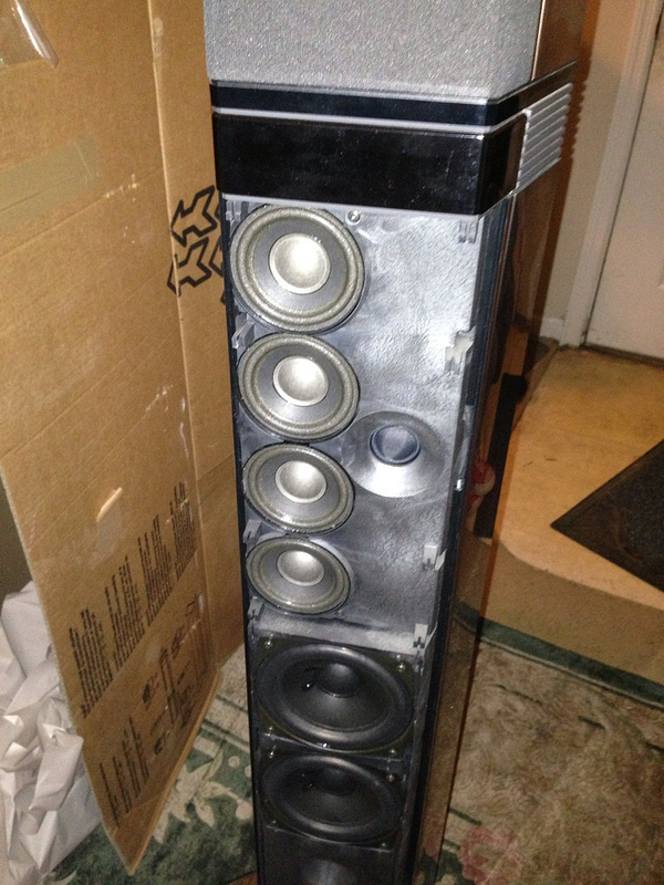

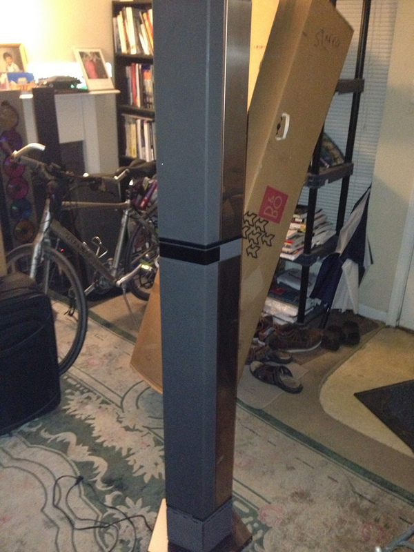

Well. Interesting turn of events with this today.
Long and short of it is I went to look at the Pentas and ended up coming home with the damned Pentas AND a BS9000 Mk. I (I seem to attract those things like bees to honey, I don't get it. Yet I can't find a nice BS5E used to save my life!) for 1600.00, along with all the original packaging, the Mk I floorstand and a Beo4. It's not all a rosy picture though as the carriage on the BS9000 was having trouble moving when I plugged it in at the seller's house. Played a CD just fine, but really struggled to move to any position and it was NOT giving a "cleaning required" error. I really have no idea what I'm going to do with that 9k even if I get it working. I don't know what value they have being completely obsolete and impossible to repair. Still, I figured what the heck for an extra 600 bucks. Especially since the stand is probably worth 2 or 300 on its own and I already have a Mk 2 stand I could also sell.
Anyway, I digress. The pentas for all intents and purposes look brand new. He's been shuffling them around back and forth in his basement for the last year and a half or so so some things were not perfect, like the frets on one weren't clipping in very well and were loose (making the task of investigating the mid drivers on that one easy of course) although the frets fabric is fine. As best as I could tell all of the midrange drivers are in-tact. The surrounds on those midranges look grey to me, though there is a tinge of greenish color to that grey. They are not yellow/green by any stretch. They also didn't feel tacky. Now I just need to get them plugged in and see what surprises I find. These things in their boxes are even more of a pain to move around than the BL1s WITHOUT!.
Playdrv4me
Top 200 Contributor
USA
Posts 477
Have them up and running now (sans displays, using PL cables I had connected to the 8000s), very balanced sounding speakers, but haven't had a chance to tweak yet. As of this moment they're on par with the 8000s so far. STRIKE THAT: with the Loudness control turned ON (which was also on with the 8000s but somehow got turned off) there is easily more bass extension here that the 8000s simply don't have. The highs are not as bad as I was worried they would be either (and one could argue that it's more "fair" to use the Loudness control with the Pentas since they have no ABL of their own which the later active 'Labs do). There's no contest with the BL1s here. The BL1 should never have been considered a replacement for this speaker in anything but utter beauty.
With much consternation I got the four outermost clips on the one loose fret to clip in. Nothing looks broken so I'm assuming it just takes patience and care to get ALL the clips to attach.
Nevertheless, I looked the speakers over and they're definitely in "new old stock" type condition. Meaning you can tell they haven't been knocked around over the years, but I suppose due to being in a basement and being removed for people to have a look or who knows what the metal parts on the cases definitely need to be polished up. They're not scratched, just fingerprints and such that over time have dulled the finish. So what is recommended to polish the metal? A couple of photos attached of the speakers in general and one not so good photo of the dulled finish...

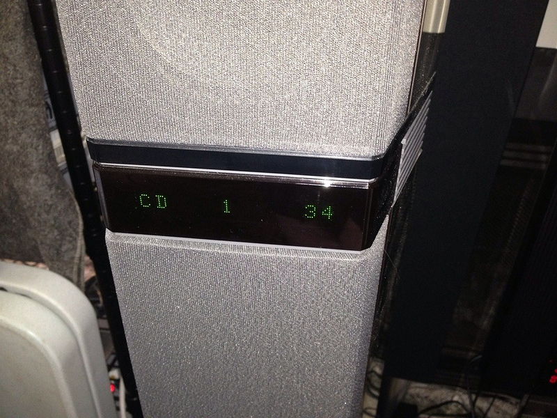

I am a display geek so I shined a flashlight inside the display module and I can tell you that these have the Vacuum Fluorescent multi-segment display. I noticed that some Mark III Pentas in photos look like they have LCD displays and these are not LCD. They are VF like the BeoLink 7000 and BS9000 for example, but green instead of red. I'll hook them up and get a picture shortly.

Here's a pic of the display. Seller included a single long PL cable which is the right type for Pentas so at least I can test. On the other hand, I am not entirely sure I want the display on both of them on, I think it's a little overkill and redundant lol. Maybe it's just me.

Playdrv4me replied on Mon, May 27 2013 11:58 PM
So Beobuddy, does that look like the newer display or the older one?

At the first look it looks like the first mk3 version. But the differences are only visible by comparing them side by side and with a picture taken in front of the display.

So to update this never ending thread... Tonight I decided to disassemble/take out the midrange speaker panel. I discovered that the midrange drivers are made by Nokia and not the older ITT version. However apparently this isn't of much importance as I found other threads where the Nokia foams had deteriorated. Not only that, I also found a thread from 2009 where someone with 1993 Pentas with consistent use still had brand-new looking foams in 2009 and they weren't even tacky around the foam. So I guess this is better left as one of those "don't think about it or it will drive you nuts" things. I did pinch the foam on all four drivers on that side and they all seemed fine.
Another advantage about these tiny drivers and the way they are attached to the surrounding case is that you can pull the whole thing off and send it out for re-foaming to someone with actual experience (i.e. NOT me nor do I want to try it with paper cones, re-glueing the BC9500 is enough for me) with relative ease.

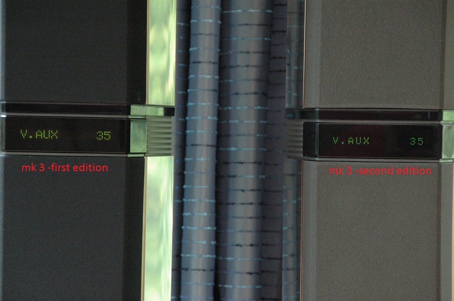

As promised.

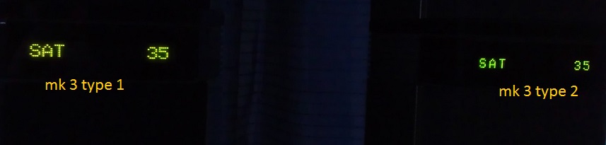

I just finished overhauling a set of MK3's penta's and set them side by side with mine.
the newer version has a bit smaller diaplay and more greenish.
Beobuddy
Top 25 Contributor
Utrecht, The Netherlands
Posts 3,972
At night it gives following difference.
The distances from the camera to the penta's are the same.
Penta's by night:

Beobuddy replied on Thu, Jun 20 2013 9:37 PM
That's clever found!
Indeed there is a distance between the characters, I didn't notice it until you mentioned.
Don't mix up the mark types, mark 1 was there from the beginning in 1986, mark 2 was around1990? finally the mark 3 started from 1993/1994. In the last period there were different mark 3's, as shown.
The second type mark 3 had also a different type of tweeter. Some changed them, but the tweeter can be recognized by the outer ring. The former tweeter had a smooth done without the ring.
