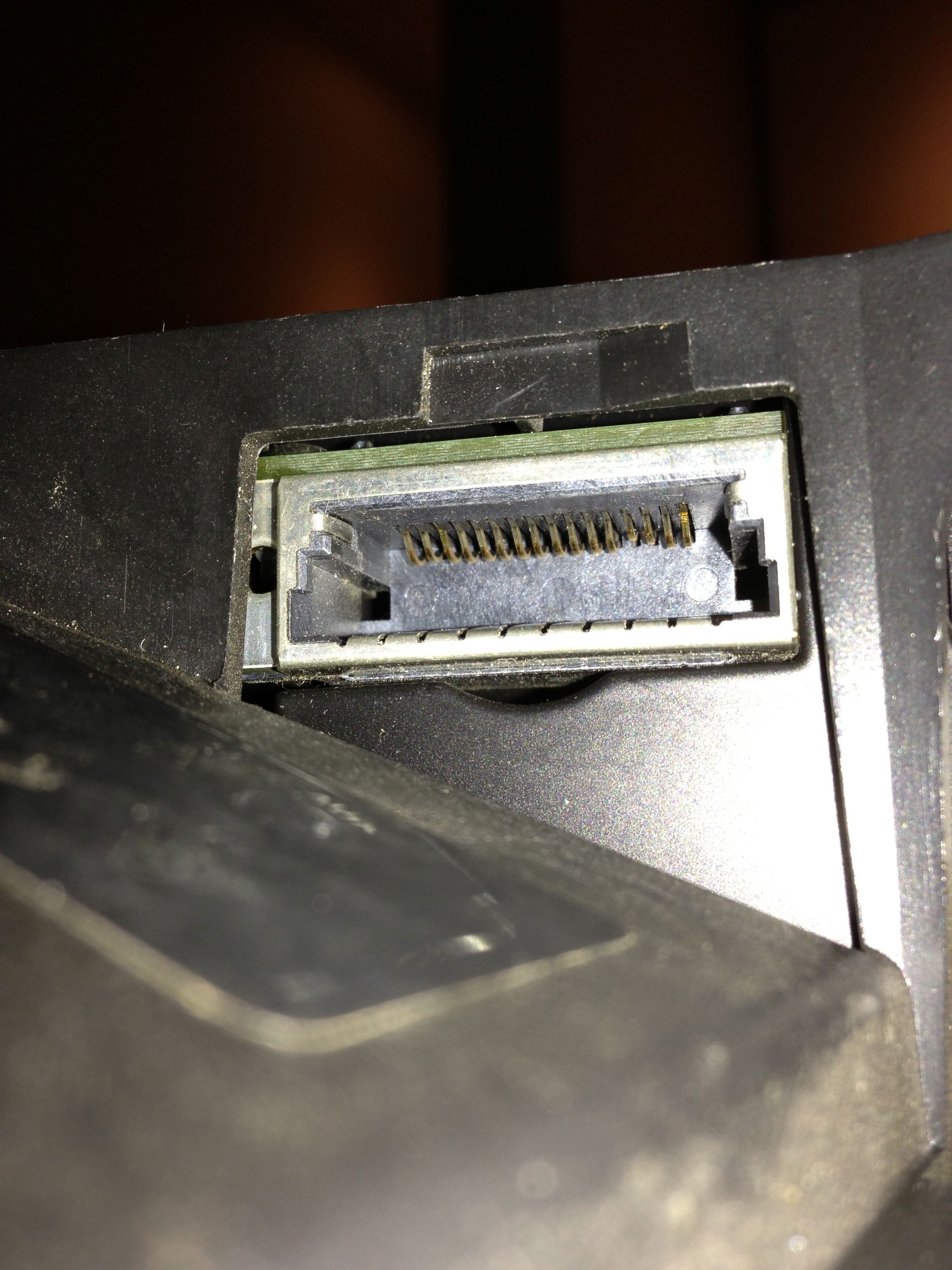

berlin2010
Posts 92
So, disconnected the NL/ML converter and did a direct connection between BS9000 and BL3500....  And the left channel is still softer than right. Clearly not as a obvious as with BL9's - suppose having the speakers 3 meters apart (BL9's) instead of next to each other in the same enclosure (BL3500) does add to the stereo imaging.
So now am definitely thinking it is BS9000 that is somehow faulty on the ML connection. Anyone had anything like this before?
berlin2010
Posts 92
Just a quick update - I did eventually get to the bottom of this. Turns out that two of the pins on the Masterlink Connection in the BS9000 were bent... The BS9000 is wall mounted and I can only imagine that in the fiddling behind it when I inserted the Masterlink cable (very close to wall with little space to work) i must've wedged in the Masterlink cable at an angle and so bent the pins - you can see the pins in photo below, the bent ones are the 3rd and 4th pins from the right (which so happens to be the Left Audio cables).
Apart from being quite tough to get an "instrument" that will go into the connector given the enclosed space to work in, fixing it was a simple matter of bending the pins outwards again. All's well now
