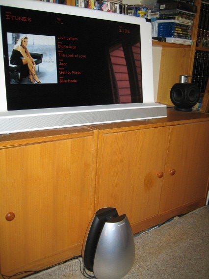

We have had similar constraints and tastes to you.  This is the journey we have been on which goes to answer your questions.
In the "beginning" (2009) we acquired our BV8-32 and attached it to our 2xBL3s on an Ikea cabinet that has books above and bookcases to the left and right.  And we were happy.
In 2010 we acquired a BL11 which we placed on the floor (see below) we were happier.  I was very pleased that the BL11 is subtle and yet when called upon can rumble our floorboards.
In 2012 we upgraded the BV8-32 to a BV8-40 so that we would have a surround sound system.  And we are very happy.
Most of the time we use speaker mode 3 where the BV8-40's speaker is the centre channel - and it is much better than the BV8-32.  I don't know if the BL3200 and the BV8-32 speaker are the same or similar, but we are very happy with the power improvement of the BV8-40.
With the BV8-32 I used to switch between speaker mode 3 and 2 when I switched between TV watching to music listening - now I don't.
When I want to watch a "man flick" I power up two spare BL4s as the rear speakers and switch to speaker mode 5.  While this is good enough to create a sense of the surround sound the BL4s are not powerful enough to make me jump out of my skin.
I have thought of trying my BL6000s as rears, but it would be an academic test as I like them where they are - which is a separate room.
I have thought of putting the BL11 on the cabinet - but it might be too boomy - I might try it one day just as a test.  There are some pictures under "Flash your B&O" where people have placed their BL11 on their cabinets.
Tomorrow night I am going to hear the new BL14 surround sound system - and that will help me decide whether we have the righ system for us.  If I had more funds I would buy BL9s and move the BL3s to become the rears.
So my recommendation for you would be to put two BL3s on the cabinet, either side of your BV8-32, and add a BL11 - either on the floor, or depending upon your cabinet place it there as well.
If you can upgrade to a BV8-40 or a V1 I think you should think seriously about that.  For us the BV8-40 was a great move ... although once the V1 was launched at its aggressive price point I wish I had waited !

I would worry about standing a sub on a partially empty wooden box, not only is the box going to have an audible effect but the surface on which the sub is standing will vibrate in sympathy.
I would only consider this if floor standing wasn't an option.

Correct me if I'm wrong... but is that not the whole point of the horizontally opposed drivers in the BL11 - to cancel out unwanted vibrations?
hfat
Vienna, Austria
Posts 663
hfat replied on Tue, May 28 2013 4:10 PM
jkhamler:
That's my opinion too. I have mine standing on a wooden cabinet - without any anwanted vibrations.
