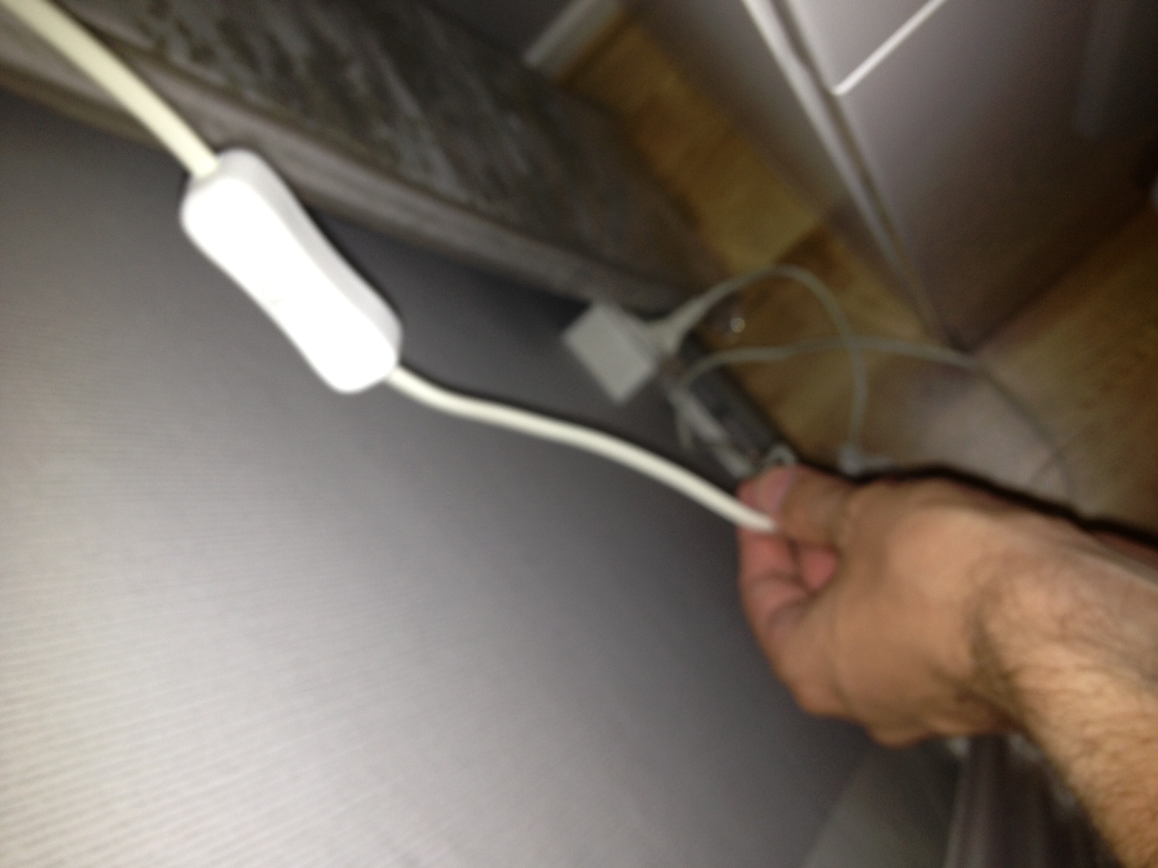

Ok, so if you understand you correctly I could just place the LC2 anywhere on the cord?
Just posted a picture to be 100% sure, anywhere on the cord shown should be ok then?
Right. You can add an LC2 in that place or just replace the little cable switch, because you don`t need it anymore.
The good thing is you can add several halogen bulbs to the 12V power supply to control all bulbs simultaneously via one single LC2-see the instuctions.
If the light system got its own dimmers (for example touchtronics) LC2 may not work, or must be reprogrammed as a switch.
LC2 is a 220-240V dimmer, so you have to place it always "in front of" the 12V power supply on the 230V side. So please be careful with your work. 230V can be dangerous...
Stefan
Ok, LC2 added instead of the light switch and once it was programmed for low energy bulbs it worked fine.
However, realized that I wanted the LC2 on the floor rather than on the wall so I will have to buy a new switch or "the other thing that looks like a switch without a switch which I do not know the english word for" and place the LC2 lower down on the cable.
