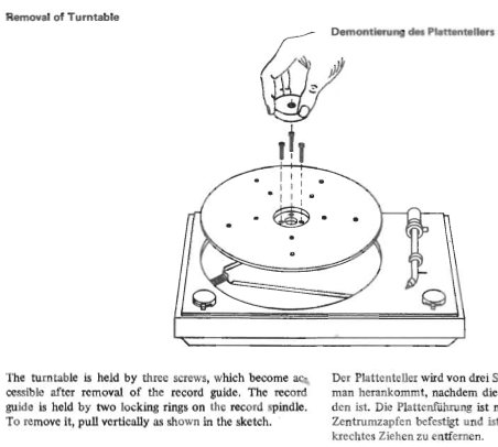

I  trying to change the belt on my Beogram 1200 but cannot remove the platter can anybody help me?  Normally you tilt the platter and they just lift out, but it seems not on this model.
 Any help or advice would be much appreciated. Thanks Colin

I believe you turn the 45 adaptor in the centre of the platter till it pops out. Pull vertically to remove it, underneath are three securing screws. Regards Richard
