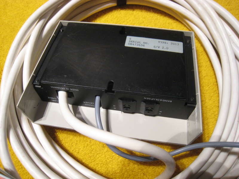

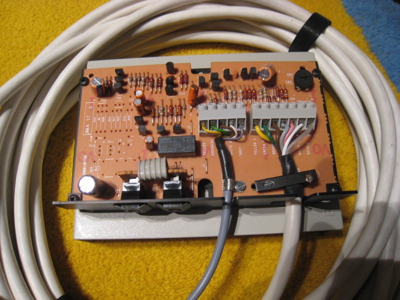

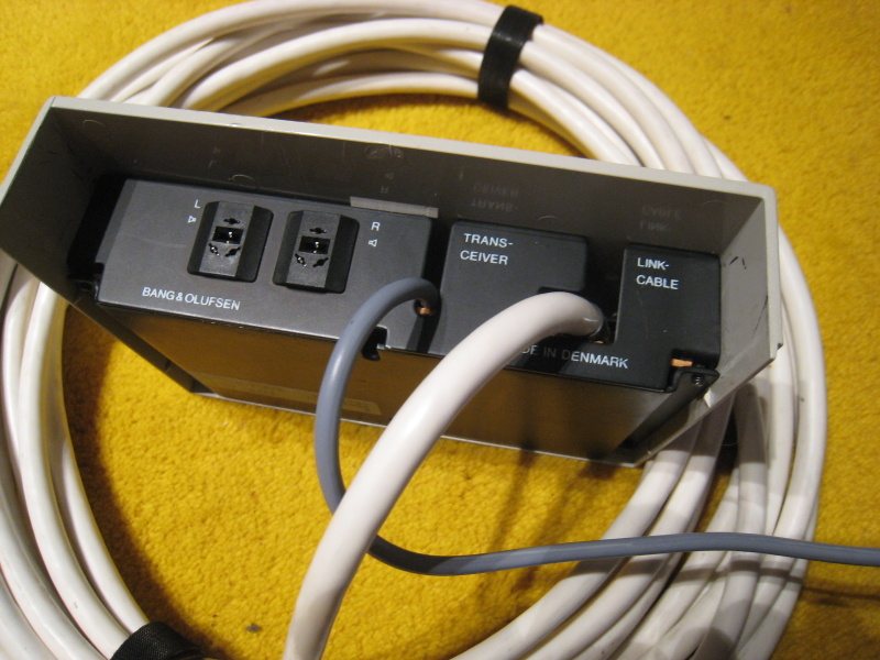

The last LCS7000 I've sold was included with a converter. The LCS7000 that is sold to Kai is without the converter. I'm not sure if the LCS7000 is useless without this converter or maybe another type can be used? I don't know. @Kai, if it's useless then we can still cancel the deal (as already offered).

Signs that the tranceiver is useless without the converter box are getting more... Will probably be pretty hard to find a separate converter box won't it?

I suppose you need a mcl x-tra kit (or actice one).
These show up on ebay, I bet Leslie got one, too. Big Smile
Your just Need to confirm the exact type of kit.

yes but this particular type (2013) seems to be quite rare. Not sure whether and if so what other type numbers can be used.

I suppose you could use any xtra kit, (2026 - 2047).
