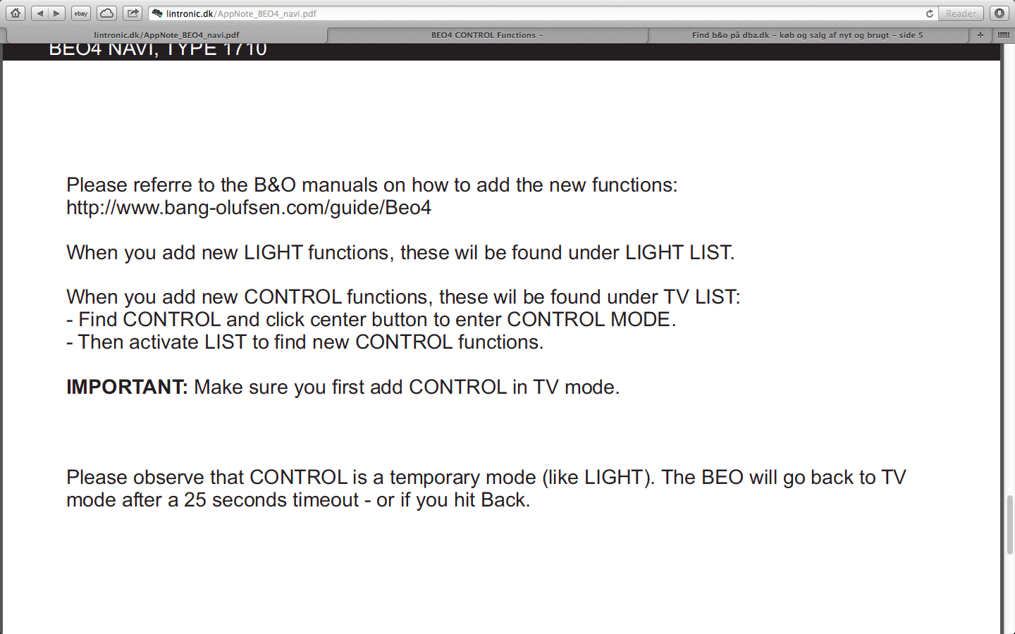

I found this information,.
how do you do ??  "control"in tv mode

stefan replied on Wed, Sep 25 2013 10:48 AM
When you have added CONTROL to BEO4 LIST, press LIST until CONTROL appears, press SELECT (center button), press LIST again.
Now WINDOW 1 should be displayed. Pressing LIST repeatedly let you select WINDOW 2, CURTAIN 1....
On my BEO4s CONTROL also works in other modes than TV...(?!)
Hope this helps.

Mikael replied on Thu, Sep 26 2013 8:30 AM
Press List + Standby at the same time. This allows you to add extra functions to List.
