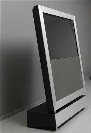

Afternoon gents,
I recently purchased a tremendous BV5 for my mother from Lee at Lifestyle and had it shipped to Denmark where she lives (of all places!)
She is old school and likes to record her favourite programmes on TV (previously had an Avant with video)
I installed the BV5 fine, hooked it up to her BC2, Lab6000s, V8000 video, bedroom BV6 and 2 link speakers in other rooms. All works fine - except the video recording:
I can get it to record the channel that is being watched on the BV5 manually by pressing record twice, no problem. The issue arises when I try to set the timer to record a program. It starts fine and display record on the V8000 as it should and appear to be recording (the tape is running) however, the recordings come out black. Absolutely nothing, no sound and no picture.
I simply cannot understand how it can record fine manually but not when set to timer.. seems to me it cannot therefore be the connection (its just a scart cable into the back of the BV5 - very simple)
Any ideas fellas?  Many thanks
