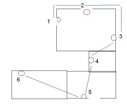

I'd like to link 4 rooms which now are "connected" in line through an empy tube. room one should get three ml sockets 1-3).

In room 1 I'd like to setup the BM5 at socket 1, the BS9000 at socket 3, socket 4 empty (maybe a BS3500 later), the BS3200 at socket 5 and a Beolink active with A8 at socket 6.

You have run the cabling from device to device, the old way and you have ml equipment. So use ML cable with ML connectors.

The only advice I can give is to Star wire to a central point.
This will give you the best chance of future proofing.
Spur wiring is not recommended.

As StÜrrock said, Cat7 star wired is also my recommendation. For ML and PL (maybe PL direct cabling if it`s too long...).
BS5 as NO AUDIOMASTER with BS9000 (audiomaster) and BS3200 as local audiosystem with A.OPT5 and N.MUSIC compatible and BL active with L.OPT5 should work.
