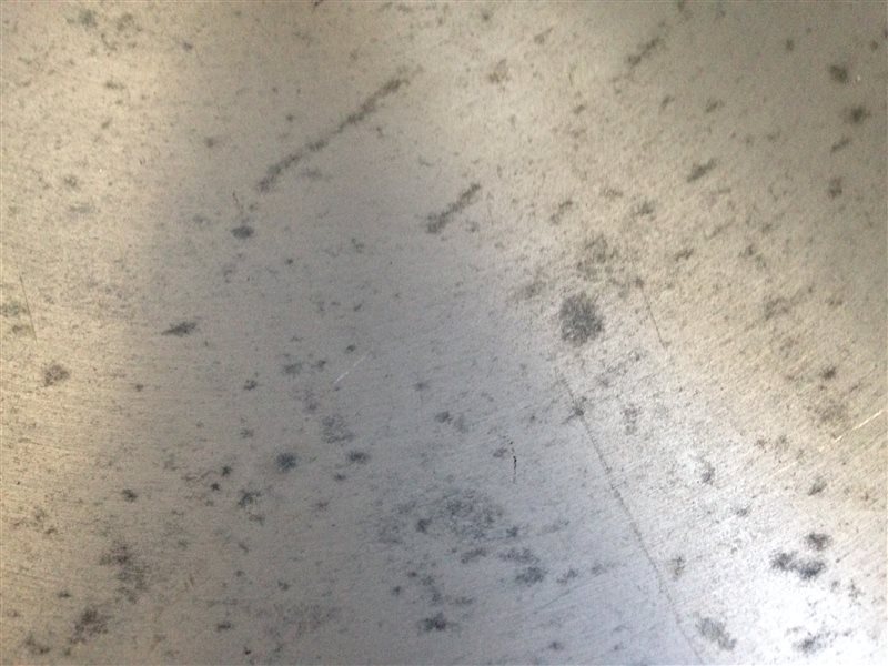

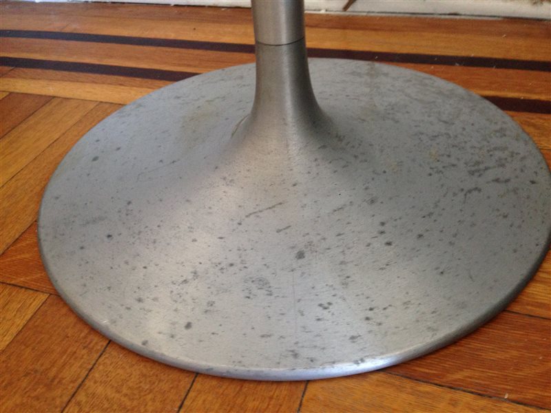

Hi,
I was lucky enough to pick up a nice pair of M70s off craigslist complete with trumpet stands (one dead woofer, but replacement is on the way).
The stands are aluminum I believe. As you can see in the photos they have some discoloration. They are still smooth if you run your hand over the discoloration.
What would be the best way to go about tidying these up?
Many thanks,
H

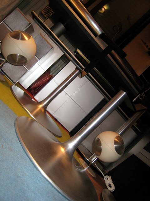

Here's what mine (untouched) look like. Actually the flashlight worsens things!

All aluminum from B&O is anodized, this hardens the surface and protect it against oxidizing, once the anodized surface is penetrated the oxidizing occurs, to get the aluminum back to the original look the anodized surface has to be restored, meaning, polish or grind away the anodized surface to naked aluminum, polish to the same structure as B&O uses, and then anodize again. This is not possible with normal workshop means.You will have to know exactly how B&O does it (I think the procedure is patented).
What we can do is like Christian mention, polish for aluminum wheels or the like, is that does not do it, the only way is the way Jacques mention, a lathe, circular motion, and polish, grind, away until bare aluminum,
I have tried on several aluminum flat pieces, always sanding or polishing in the "grain" direction, I found that hand sanding last time with 280 to 320 grain comes the nearest I can get to the B&O surface finish. If one does that in a lathe, the speed will be faster and the grain will have to be lower to get the same result, grinding or polishing is a matter of speed, pressure and grain, change one of these and you will get a different result, also to consider is, using water, turpentine or a thin oil to keep your grinding/polishing pad free from running "full", this also will change the surface structure.
At last you will have naked aluminum, this has to be protected against oxidation, and make it easier to keep clean, this can be done with a simple car wax, but you will have to apply this every 6 to 12 months, or as I prefers, paint with a polyurethane lacquer, here you will have to have a very clean surface, use acetone to clean, after cleaning use white cotton gloves to handle the items, any finger prints will show after painting.
You can ad more layers of lacquer, but you will have to sand lightly with 400/600 grain (observe direction) between layers, and also keep your surroundings, when spraying, dust free.
