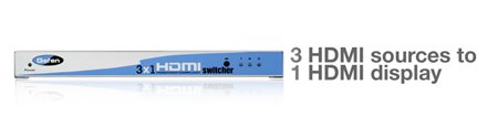

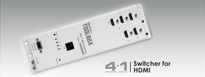

Tested every ir channel of the gefen switcher and a put the ir emitter 5mm to 1cm away from the ir receiver. Nothing worked.
With another gefen switcher it's the same. It's not working.
I even tried the setting "gefen 1.3" or "gefen tv" in the source menues. No reaction at all. And it should be nearly impossible that both switchers have the same defect.
These are the switchers I'm currently trying:
and

Hi Martin, Ive had this Set-UP Please switch on HDMI expander on in Connections menu
Gefen is controlled with C4 with the IR sender placed next to the red light on the Gefen

Ok, checked the functions of my two hdmi switchers shown before. They are both working correct with ir commands.
Tested it with a logitech remote which I have learned the codes from lintronic via my tt-238 , as the original codes from logitech don't work.
As I get another tt-238 the next days (thanks to user Silou) I will read the codes the BV-7 PUC sends out and compare them with the codes that I know they are working.
This way I will also see if the BV7 PUC sends ou codes or not.

Got another Lintronic TT-238 today to test the ir codes the BV7 sends out to control the gefen switch.
I was very surprised to find out that the BV7 always sends the power off command to the gefen switch regardless if I switch to DTV (HDMI-1) or V.MEM (HDMI-2) as it is configured for the devices on the BV7 with the gefen switch.
What the hell is wrong with that ?
I spend money on the eeprom chips and the software update to have the latest firmware to support gefen switches and what happens, it does not work.
Now I can manually turn on/off devices with Go+0 (Technisat) or Go/manually selecting Hibernation (AppleTV) to use the auto-switch function of the gefen switch to change HDMI inputs. Wow, this can do switches with price tags around 30€, but gefen, as you know, is much more expensive. Sad but true.
