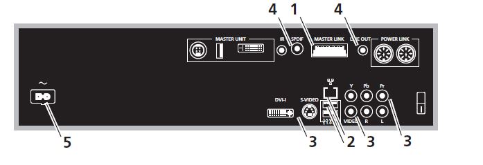

Thank you carolpal , good idea but how do I connect a screen? Sorry for the silly question :-)
Thank you Carolpa! silly question: how to connect a screen to the BM?
Use the DVI, S.Video, Y-Pb-Pr or Video.
DVI is the most preferable ; Video the least
ok, I have to get a cable/adaptor for the laptop.

You cannot just connect a laptop. You need a screen with DVI input, and then run a DVI cable from BM5 to the stand alone screen, the screen will then do the displaying instead of BS5.
Hi, how about a convertor cable from DVI one end to HDMI the other end and connect it to a TV?
Wild Ruedi:Hi, how about a convertor cable from DVI one end to HDMI the other end and connect it to a TV?
