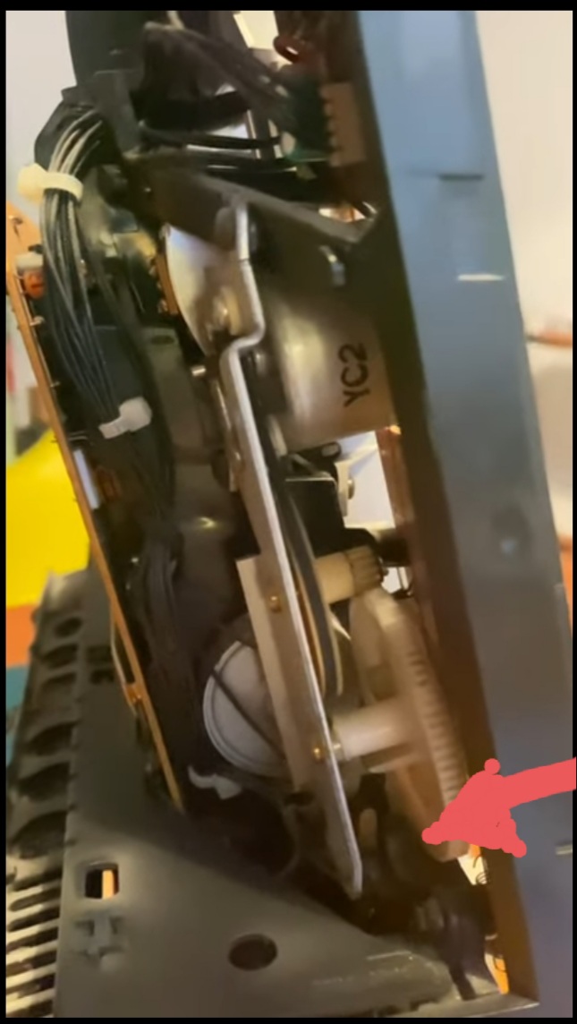

Sure I do.
I'm just waiting for the door belt, when it's there I'll take photos of where the switch can be found.
In the picture above you can see the Clamper Belt and the associated switch.
wilfried

Amigo799:
Ок
This switch ( which on foto ) needs cleaning ?    No, this is te Clamper switch!,,
How you did it? I meen cleaning procedure.
The switch for the doors is under the metal plate here is a photo (unfortunately a bit out of focus)
I usually clean the switching contacts with a rough cardboard that I sprayed with WD40 (WD40 dissolves the corrosion a little and the rough cardboard strip removes the dirt)
